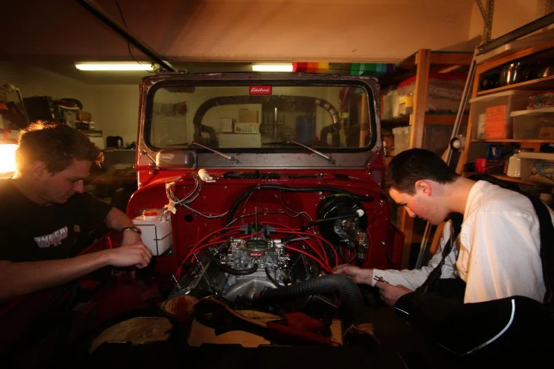

in the mean time....here are some pics from friday... just messin around.
chad and myself (note the one arm wrenching)

In looking at your picutres it seems that your cruiser is larger than your garage door...hopefully you'll be able to get it out :grinpimp:
