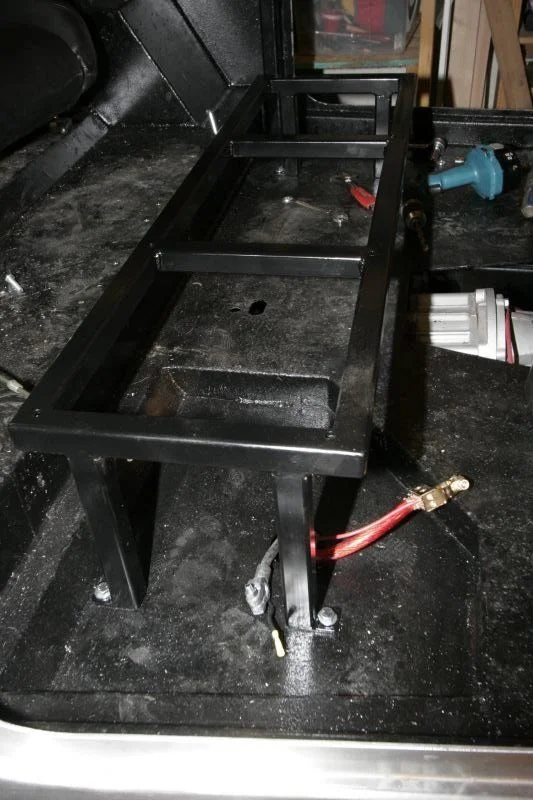

Will do Aaron. Ill post them up tmrow if it gets done. Im about to post the pictures of the finished seat mounts.

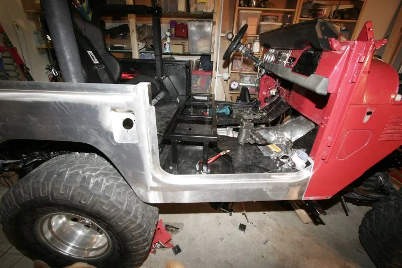

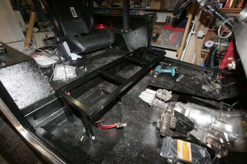

By the way, does the middle of the seat bracket you fabbed-up (good job BTW) not need a couple of braces running down to the floor? Just thinking a couple of seats, 2 dudes sitting in the seats, and some hard off-roading might make the tubes bend in the middle...unless the (3/4"??) square tube's wall is thick.
Looks great! Keep going!
I actually wasnt the one who fabbed them....a buddy and I thougth them through and he welded them up... Origionally I thougth that there were supposed to be two posts in the center about a foot apart....but I guess he forgot...or something- I think it should be plenty strong... Its 1" square tube and I cant remember how thick...but its thick. Im not worried. Eventually I plan to lop off the legs and attach it to a full rollcage..so for now im sure itll be fine.

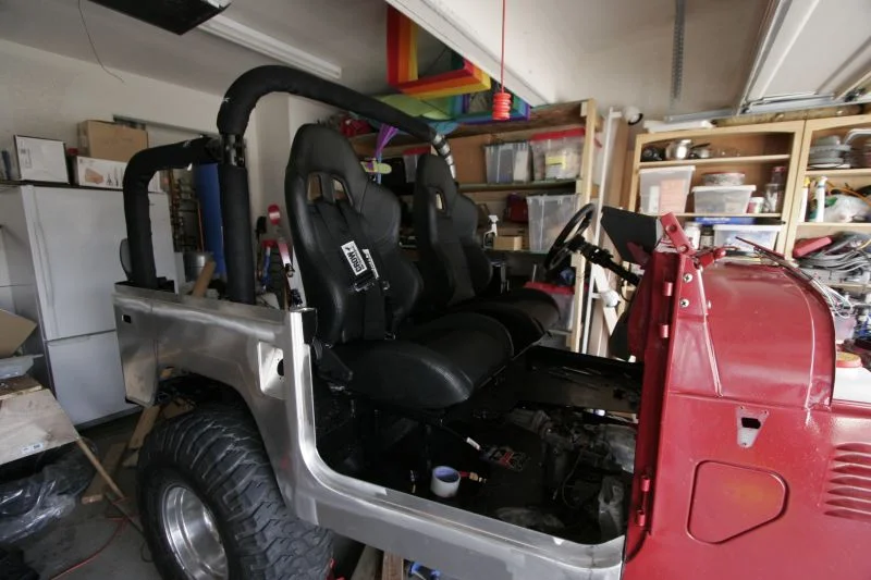

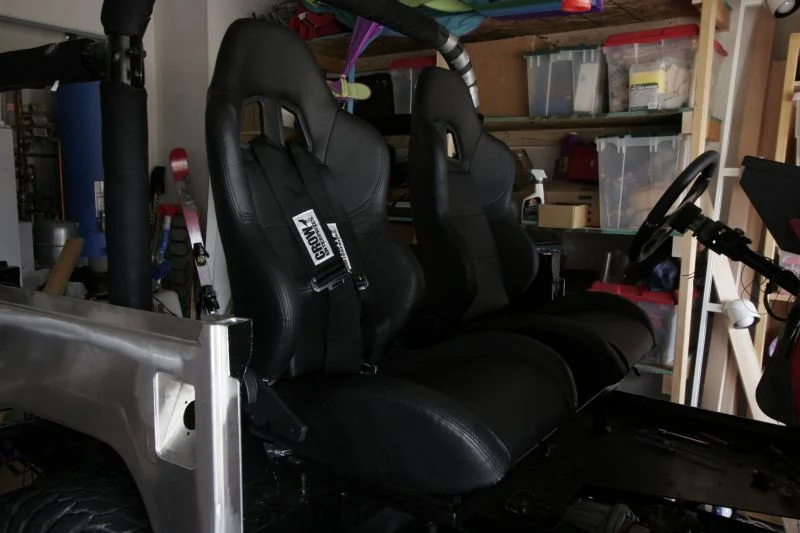

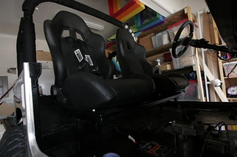

Ok so its 4:00 and as of now I have (one armed and all) slowly made some progress in preperation for tonight....I cut down the previous exhaust, (remember the old ones dont fit because of the aux tank) but left about 5 feet, so I dont have to worry about warping the engine wile test driving. So both of those are now on there. I tightened down the valve covers. and......hmmm oh yea the seats are in...im gonna go and take pics....NOW.
