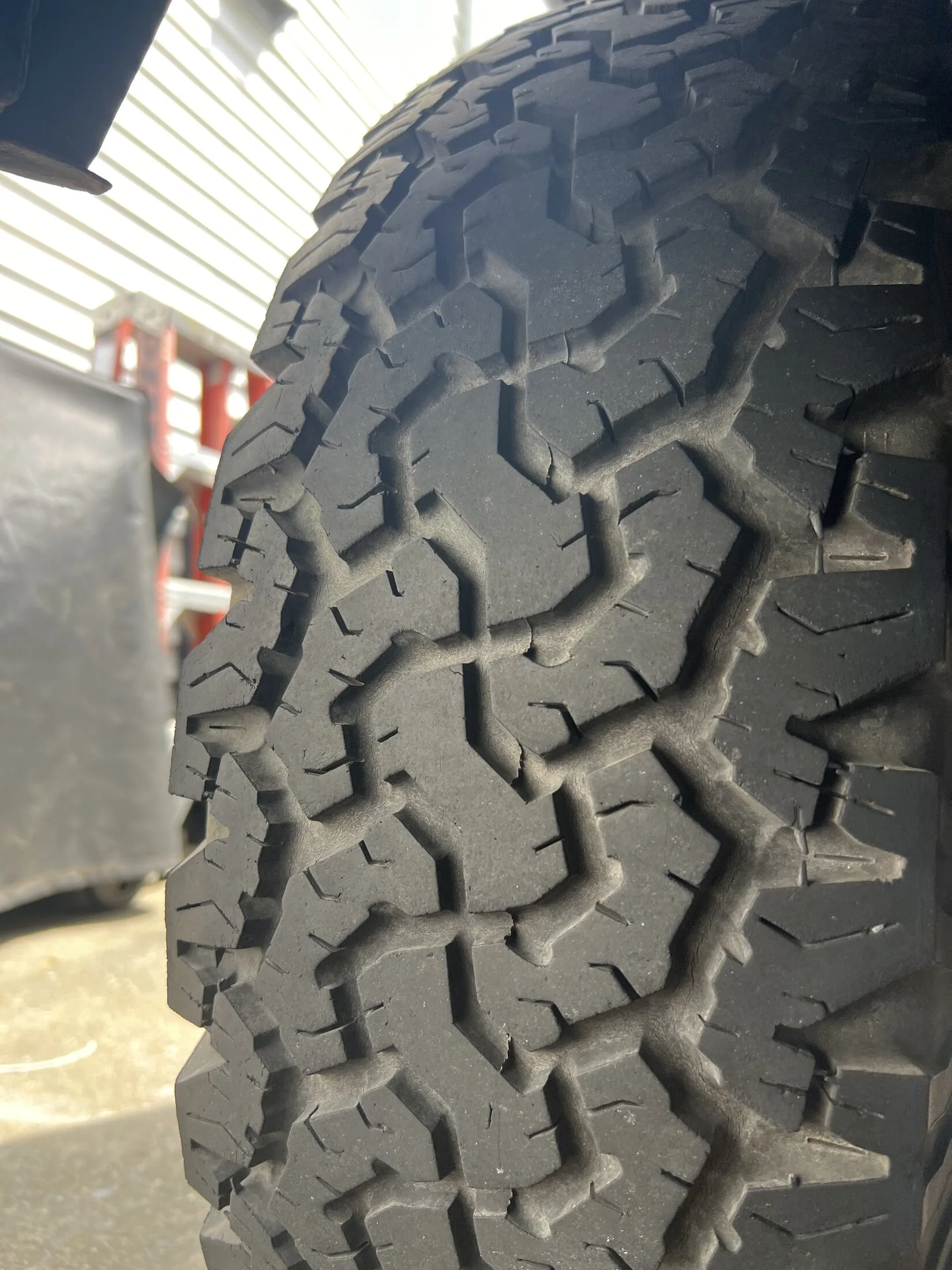

  • Tires are probably at least 3 years old if not older. Probably have about a year or so of driveability though.

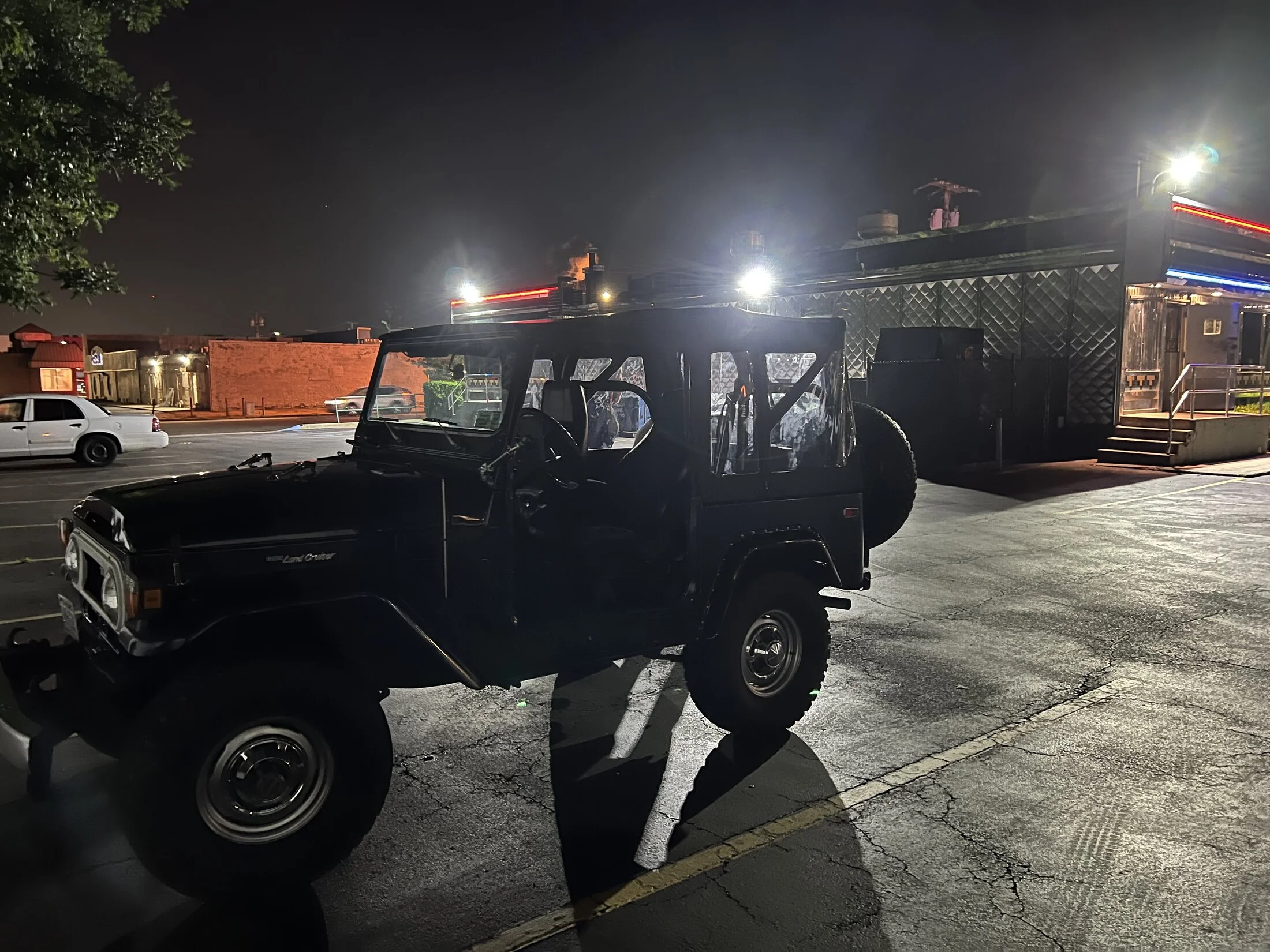

After finally getting the truck registered we gave it it's proper first drive -- driving up to the diner with me and three buddies piled in. After the diner, we took it on the highway for the first time, going down to the beach to check out the off-roading capabilities, and finally returning back to my house. The next morning I woke up and was informed that there was a puddle under the truck; I went and investigated and sure enough there was more than a few cups of oil all over my recently pressure washed driveway. I was a bit upset but not surprised, after all the truck just turned 49 this month. I drove the truck to a friend's house for the 4th of July to show it off (got called a Jeep there for the first time of I am sure what will be many!)

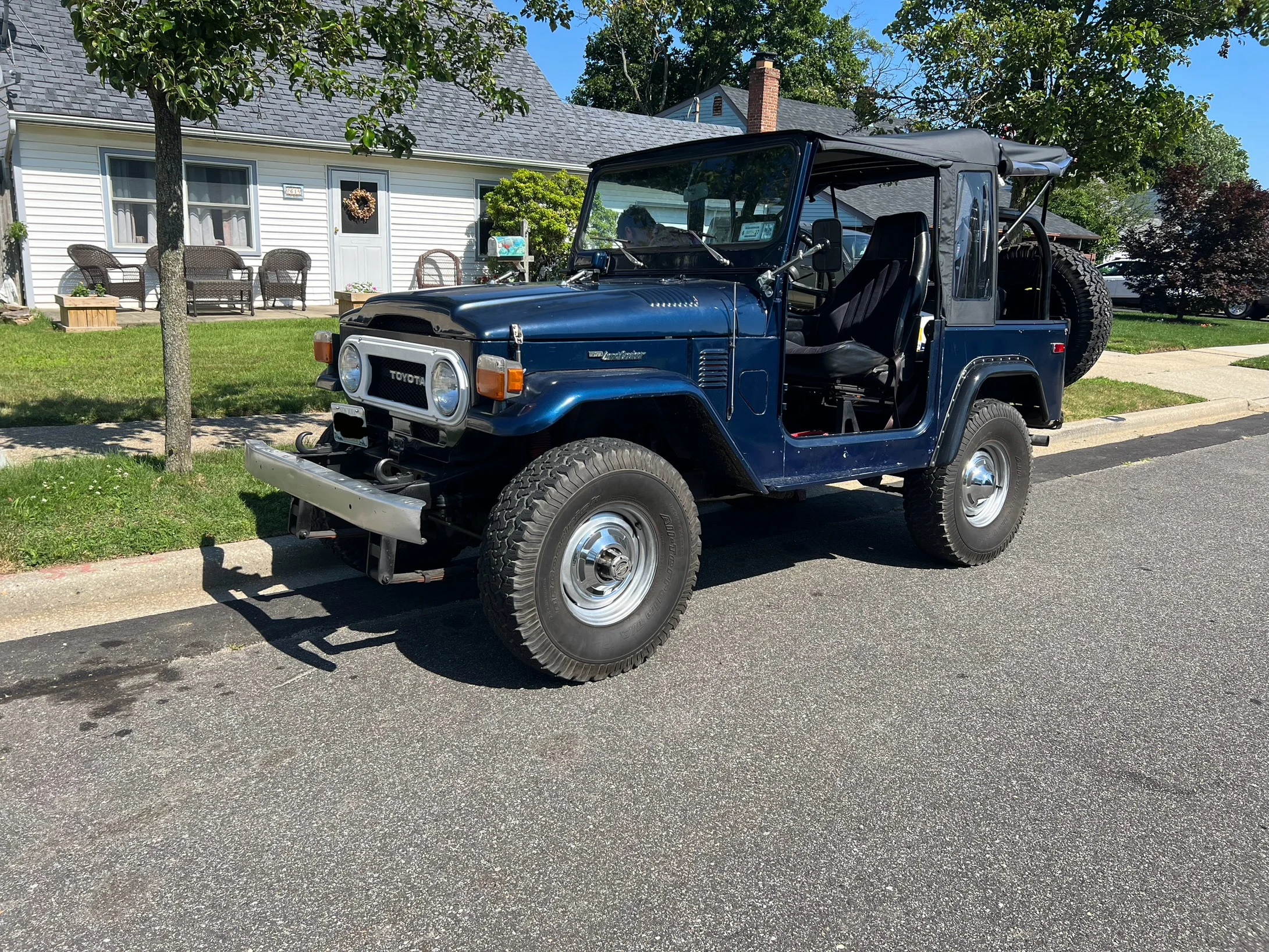

That is all for now, thanks for reading! Will check back in when the Dual Seal Rear Extension Housing Kit is here. Obligatory pics below:
Welcome to 'MUD, ... now, ... keep your checkbook handy!

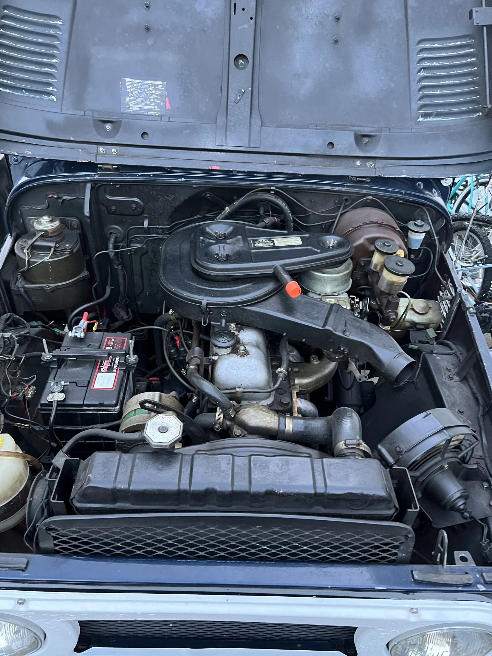

Thanks for the intro write-up. Good on you for keeping it stock-ish. That rig has a lot of potential. I love the stock, '76 cooling fan under the hood (likely needs a swift kick to get it to work). Keep updating this post as you go.
Looking pretty good. Although not original, the paint color is attractive IMO. I don't believe rear fender flares are OEM. I'd remove them and go with a hard top.
Tailgate is better than ambulance doors IMO. Why do you think the tires have a limited life span? They look good from a distance and are appropriately sized.
Will do, you just added another item to my list for the weekend: check if that cooling fan works.

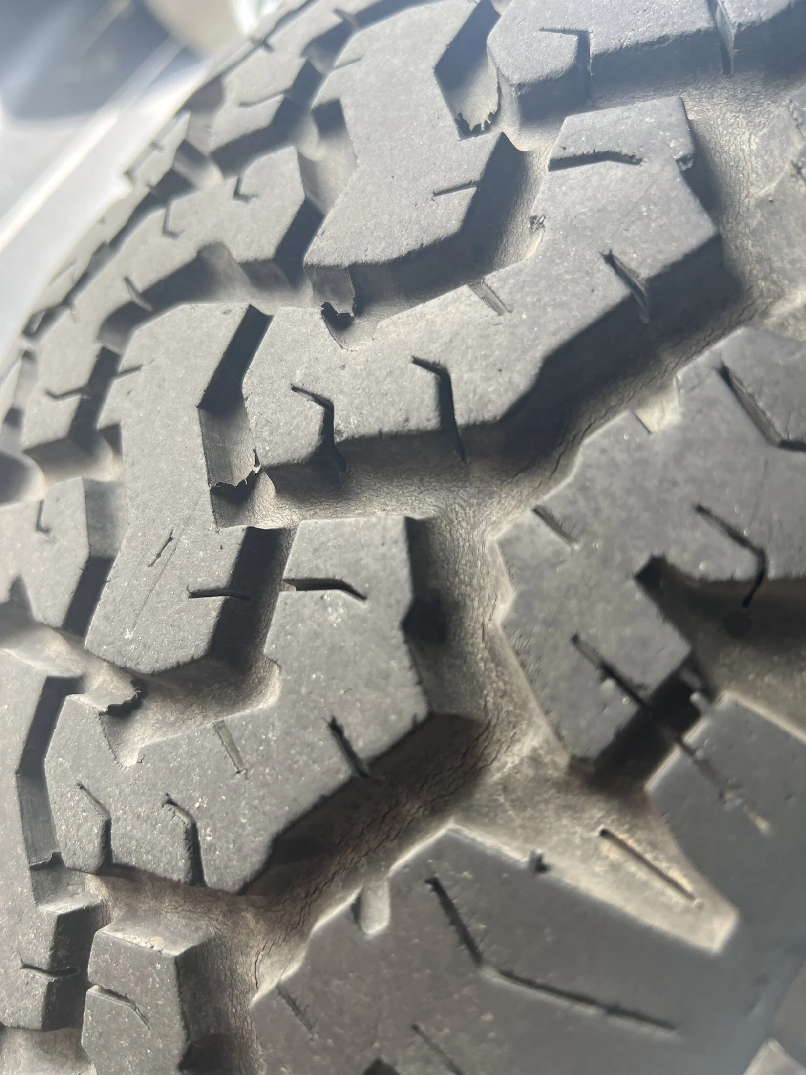

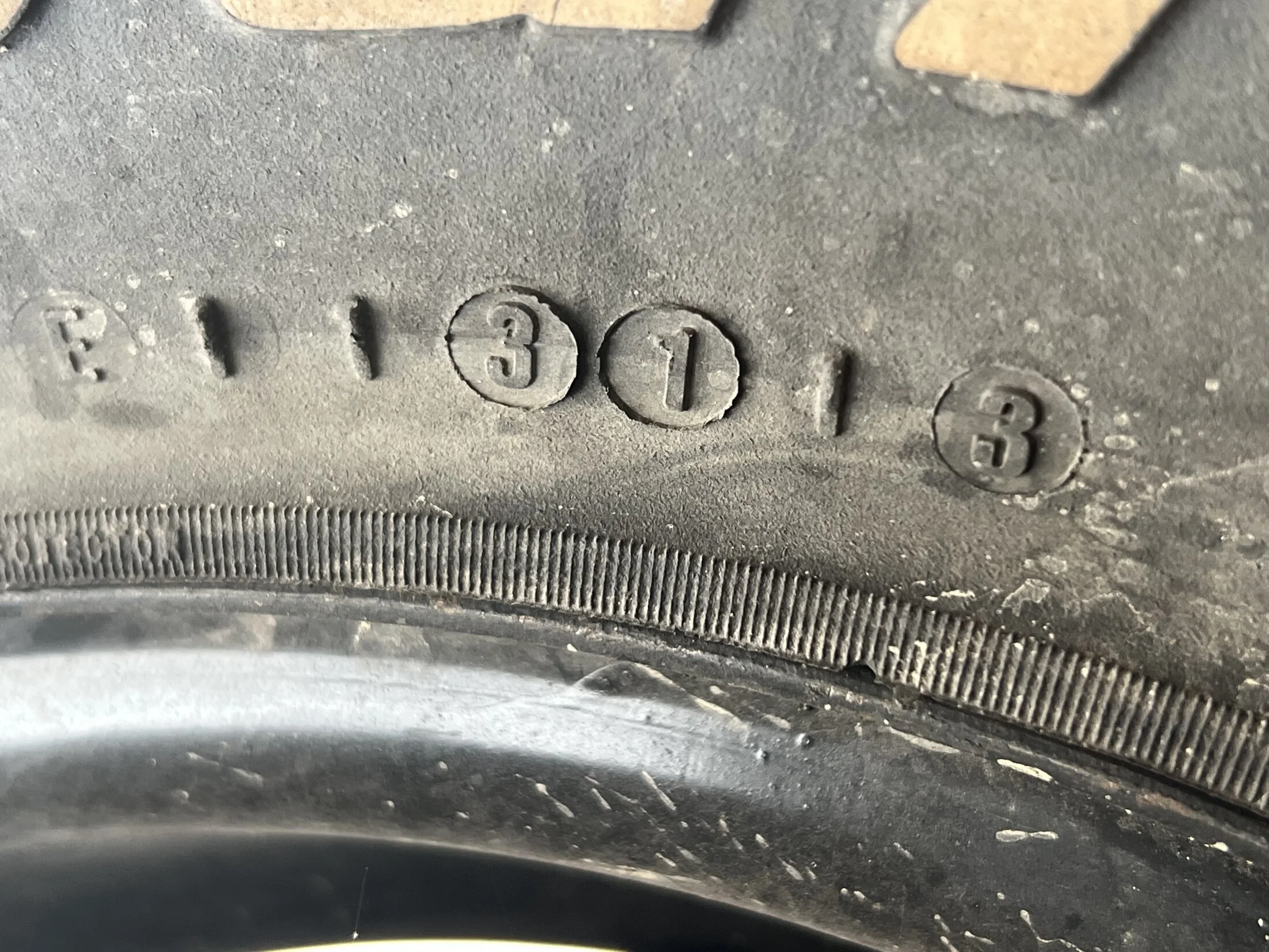

Thanks for checking it out! The tires do look good from a distance but to answer your and @pb4ugo question about the tires, the date code indicates they were manufactured in 2013😨. When inspecting them up close there is a large amount of tread remaining, but there is definitely also a good amount of dry rot. I took some pictures to share with the group. Going to get them replaced asap now that I know they're a dozen years old. Can't believe they went 60 on NY roads without exploding.

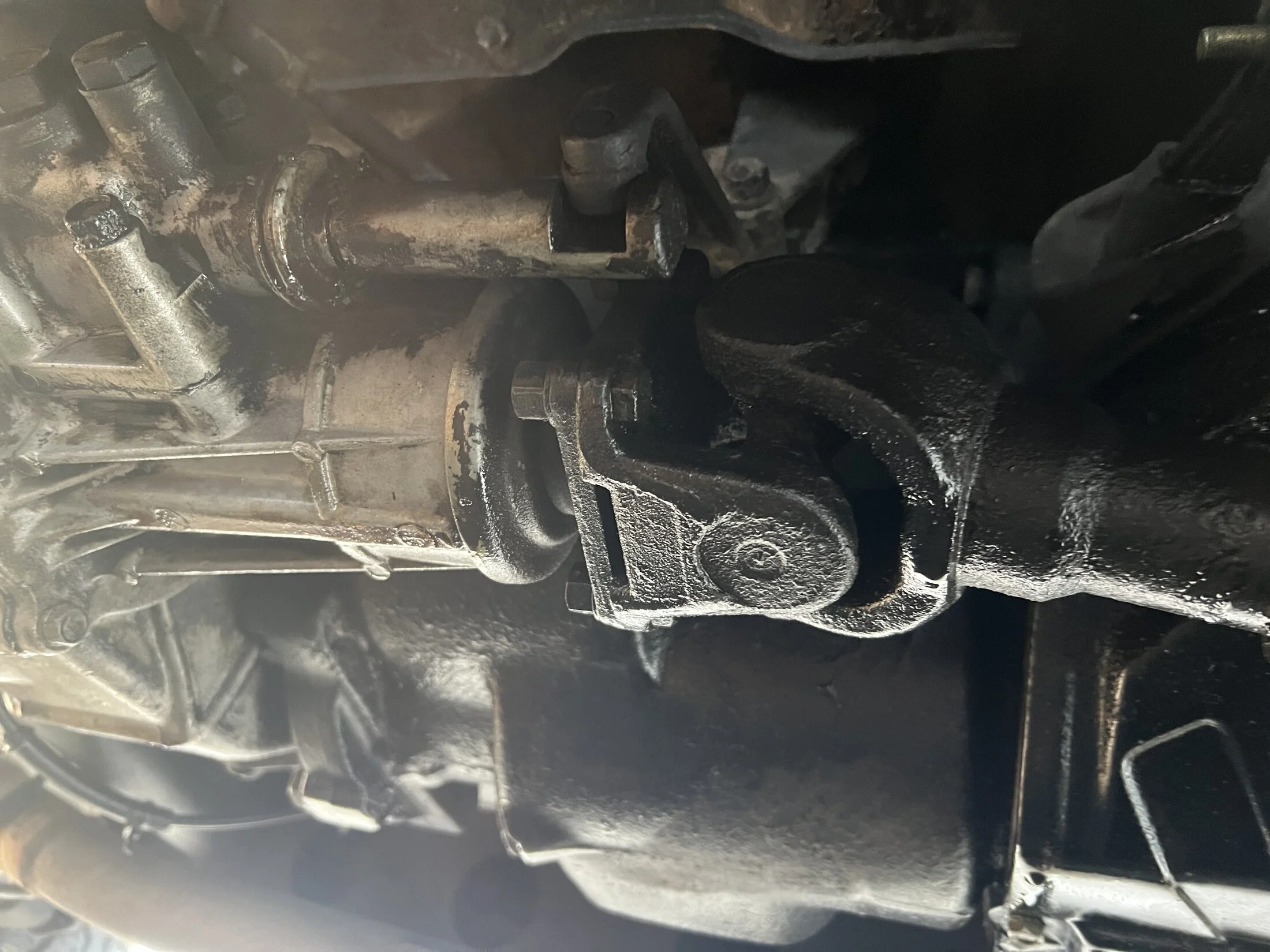

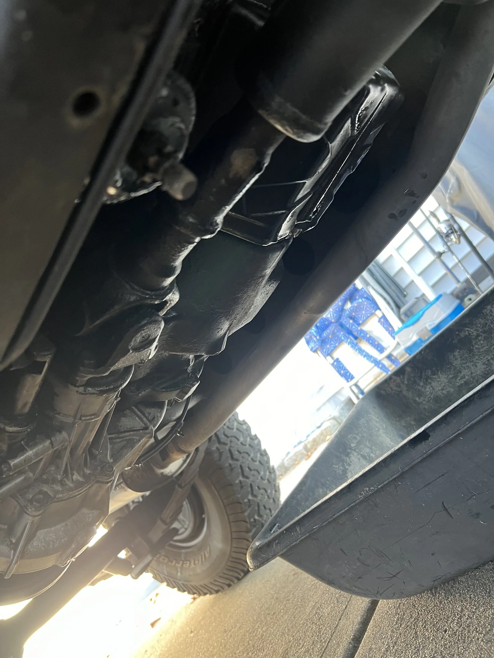

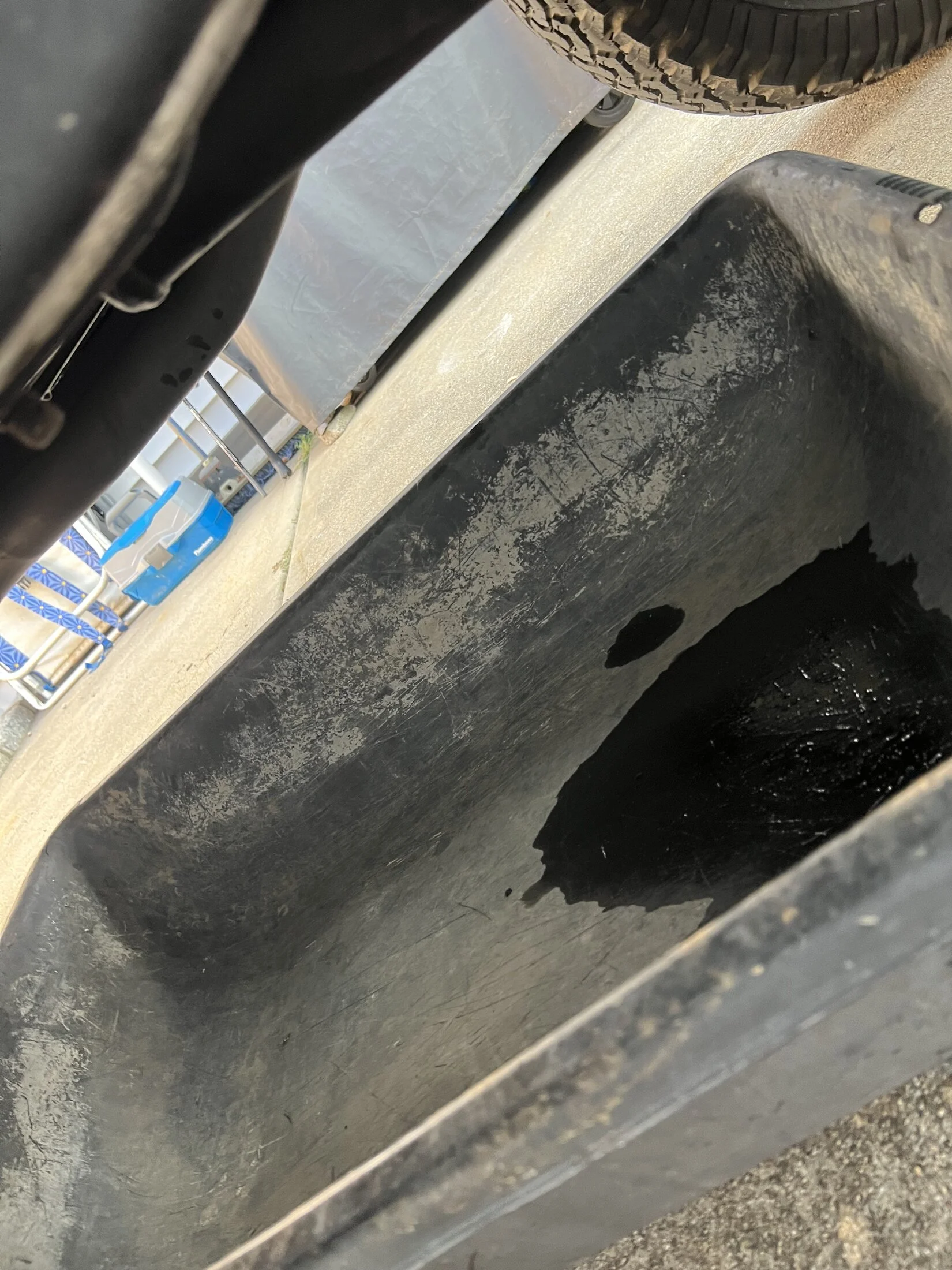

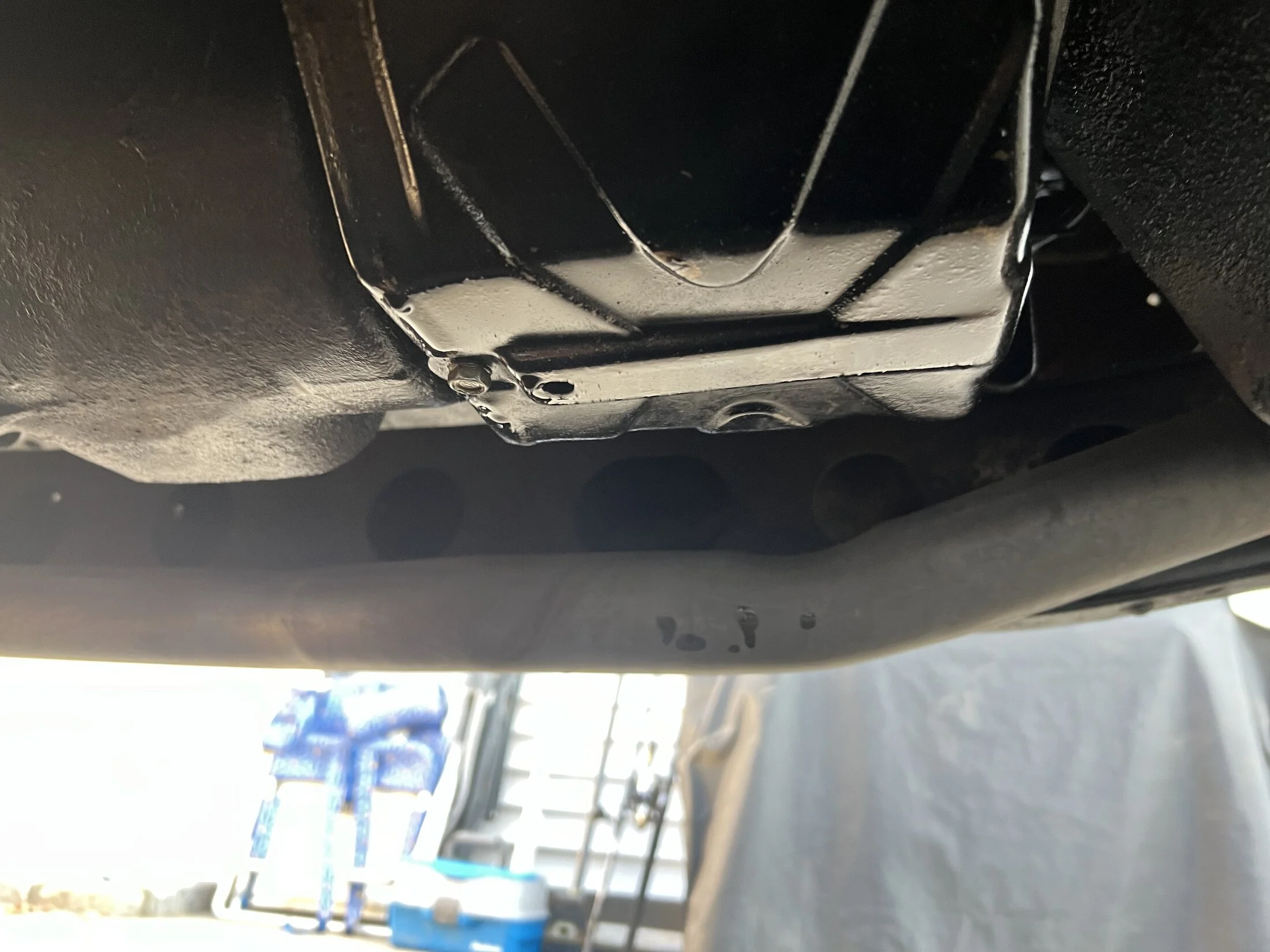

Here are some more pics of the oil leaks -
Originally, I thought that it was my master cylinder leaking, as when I popped the hood the first reservoir of brake fluid was completely empty. After topping it back off and driving it on the 4th, it is still full. I figured it could also be the parking brake so when I got the chance I traced the parking brake cable and sure enough it was shot. Also looks to be leaking from the parking brake housing; fingers crossed my transfer case isn't also leaking...
Welcome, the handbrake oil leak will most likely be the transfer case outer seal, behind the handbrake... a new handbrake kit, cable& seal will set you back about $130.. if your doing it yourself wash the handbrake drum in brake cleaner overnight if you can, then rinse it with soapy water let it dry & wipe it down with white spirit, then wire brush inside & repaint the outside of the drum ( that way you'll see any leaks easier). Its a fidgety job but you can fit yhe new kit yourself...remember to have new gear oil GL4/5 to hand, you'll be draining the box might as well do a complete renewal whilst you're there. Then you can check the working potential of the transfer box... take it for a drive, stop then put it into 4x4 and drive no faster than 5mph... sling it about & listen for any noises... better safe than sorry. Best of luck...
