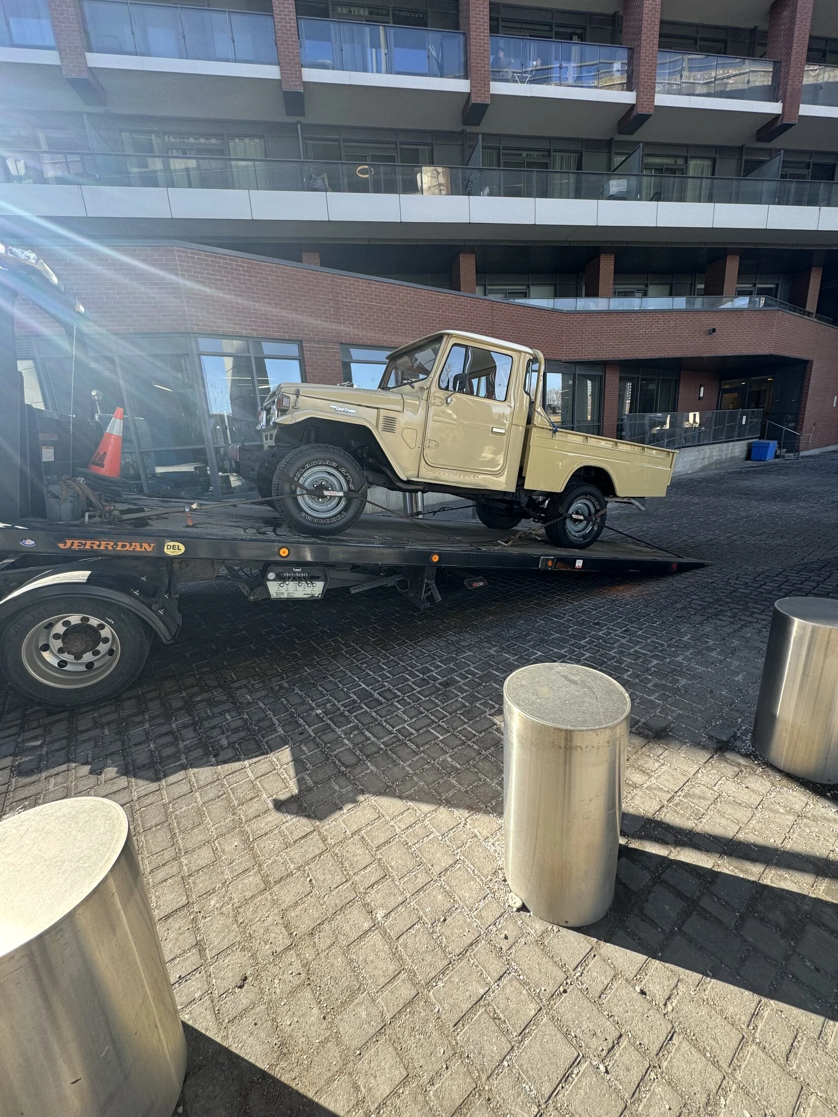

I’m sure a lot of repeat questions but I picked up my first fj today and I’m beyond excited. It’s fully stock and I will be lifting it and adding lockers. I need help on…
1) best disc breaks to add.
2) steel wheels and factory hub caps
3) tall pizza cutters (35/37 x 9.5)

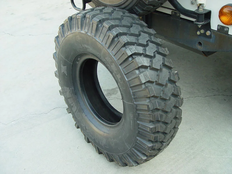

the only true pizza cutters you'll be able to get in a 36" tire on the stock 16" steelies are 900r16 .... there are a few options out there ... michelin XL and XZL are the most popular. you can get them in 1100r16 as well (38.7" pizza cutters that also fit on stock rims)
michelin xzl 900r16
michelin xzl 900r16

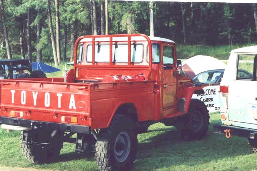

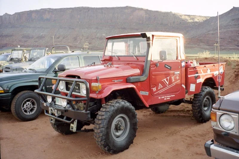

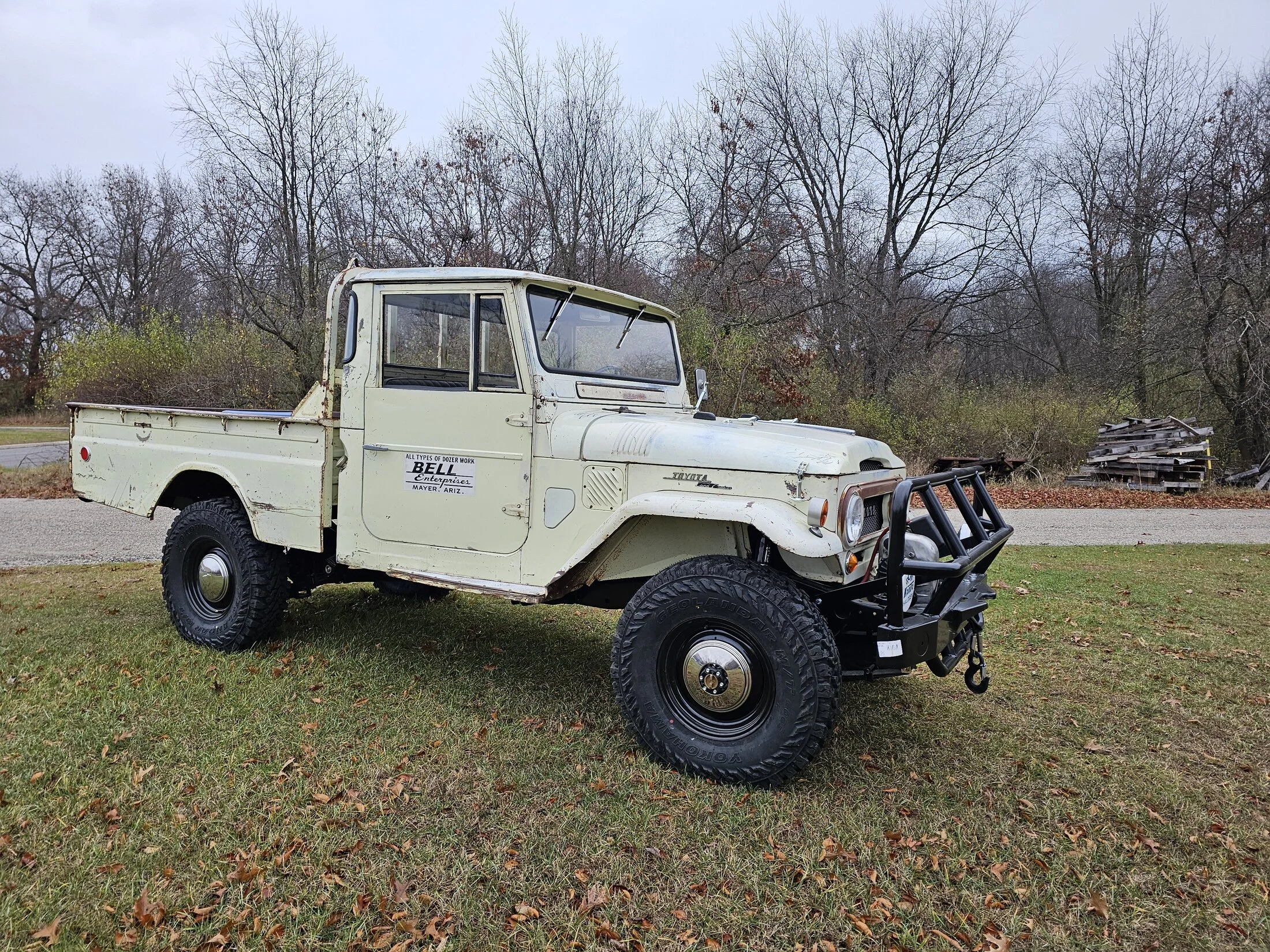

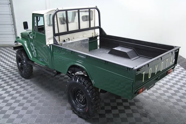

exactly what I'm looking for thank you. are any of these trucks your? wanting to know the lift you have in these?
The red truck has been SOA. Harder to tell with the green truck but I imagine it’s SOA too(?).

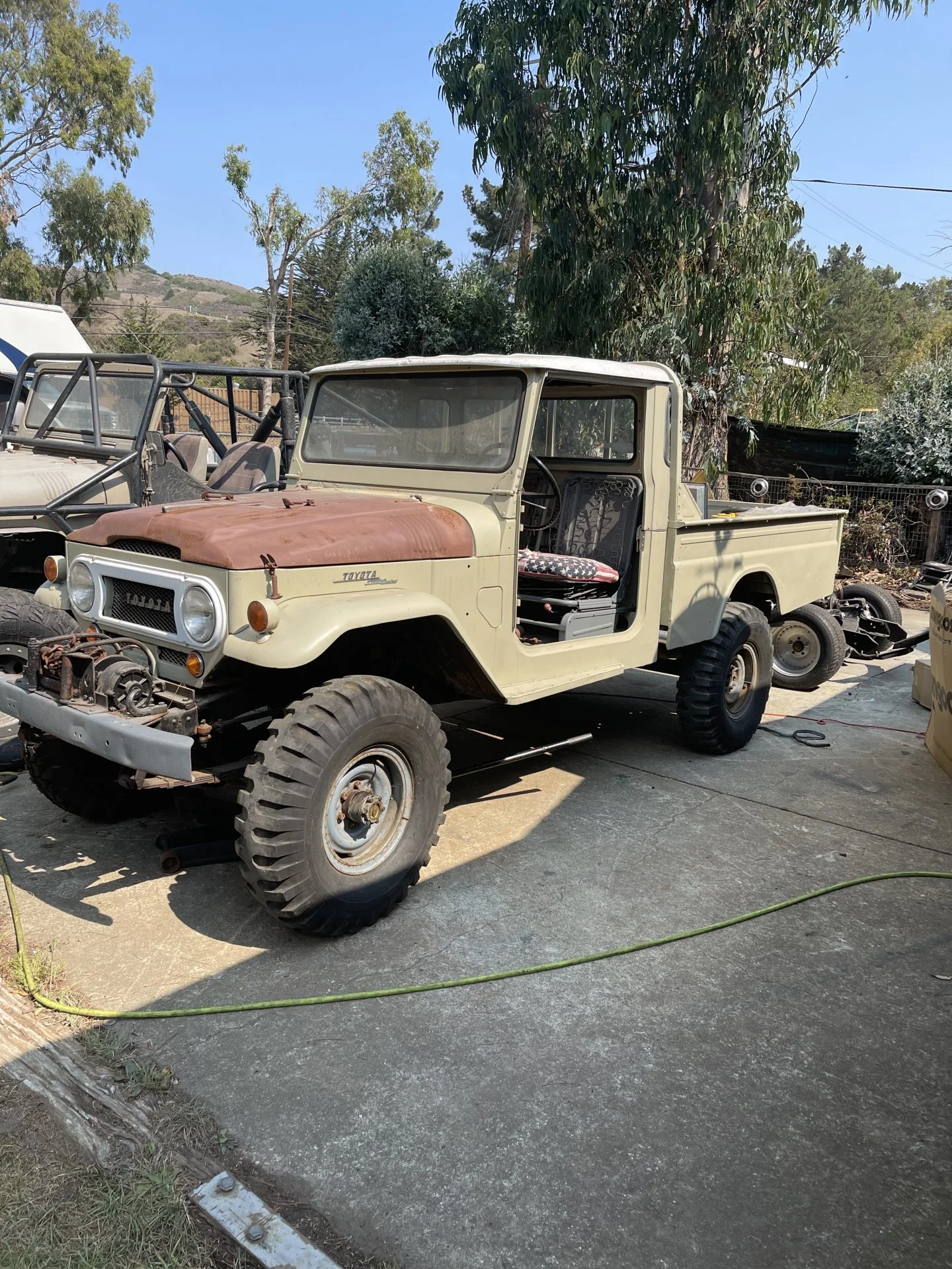

Here’s my ‘67 SOA w/ split rims on 37” NDT’s absolute crap tires. Great for rollers tho.

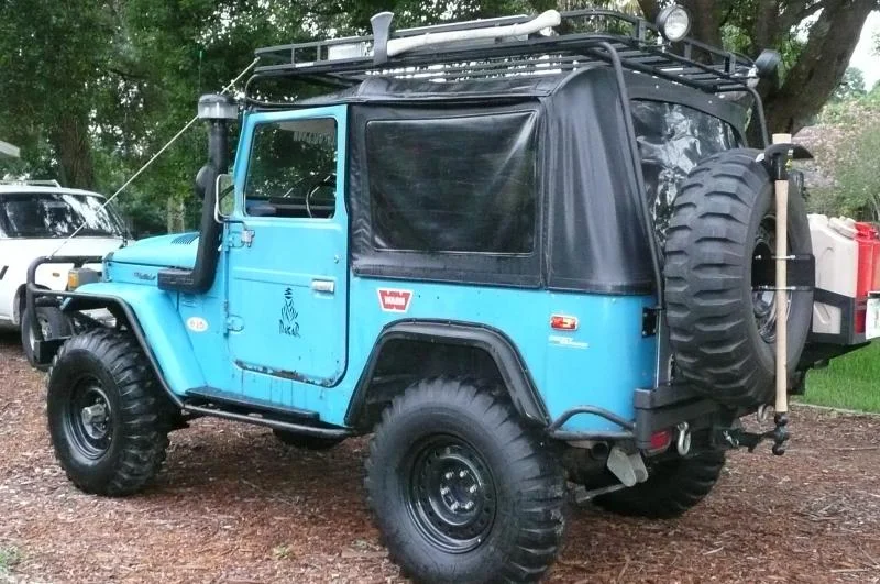

You will find that most lifts are called 2.5" because of lift height laws in AU (pretty sure that is correct). The change comes from doing light, medium, and heavy lifts. Those will change it a bit. The lift on my 45 is a Dobinsons heavy and I would say is is close to 4". Wheels are 16" steels I found here on MUD (no idea the manufacturer) with 255/85-16 tires, giving a true 33" tire.
