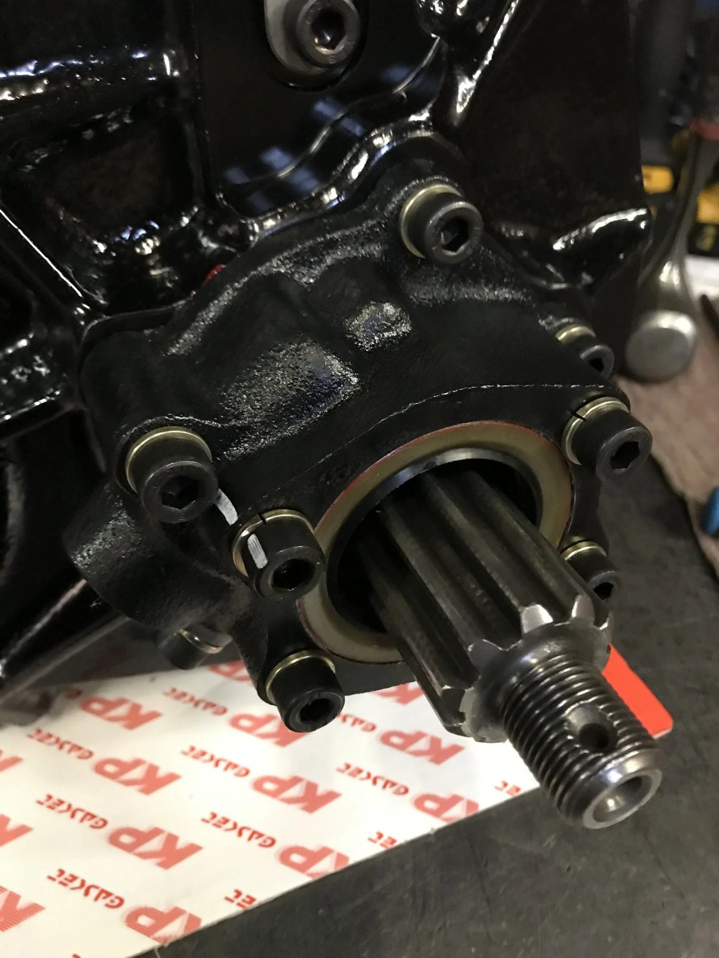

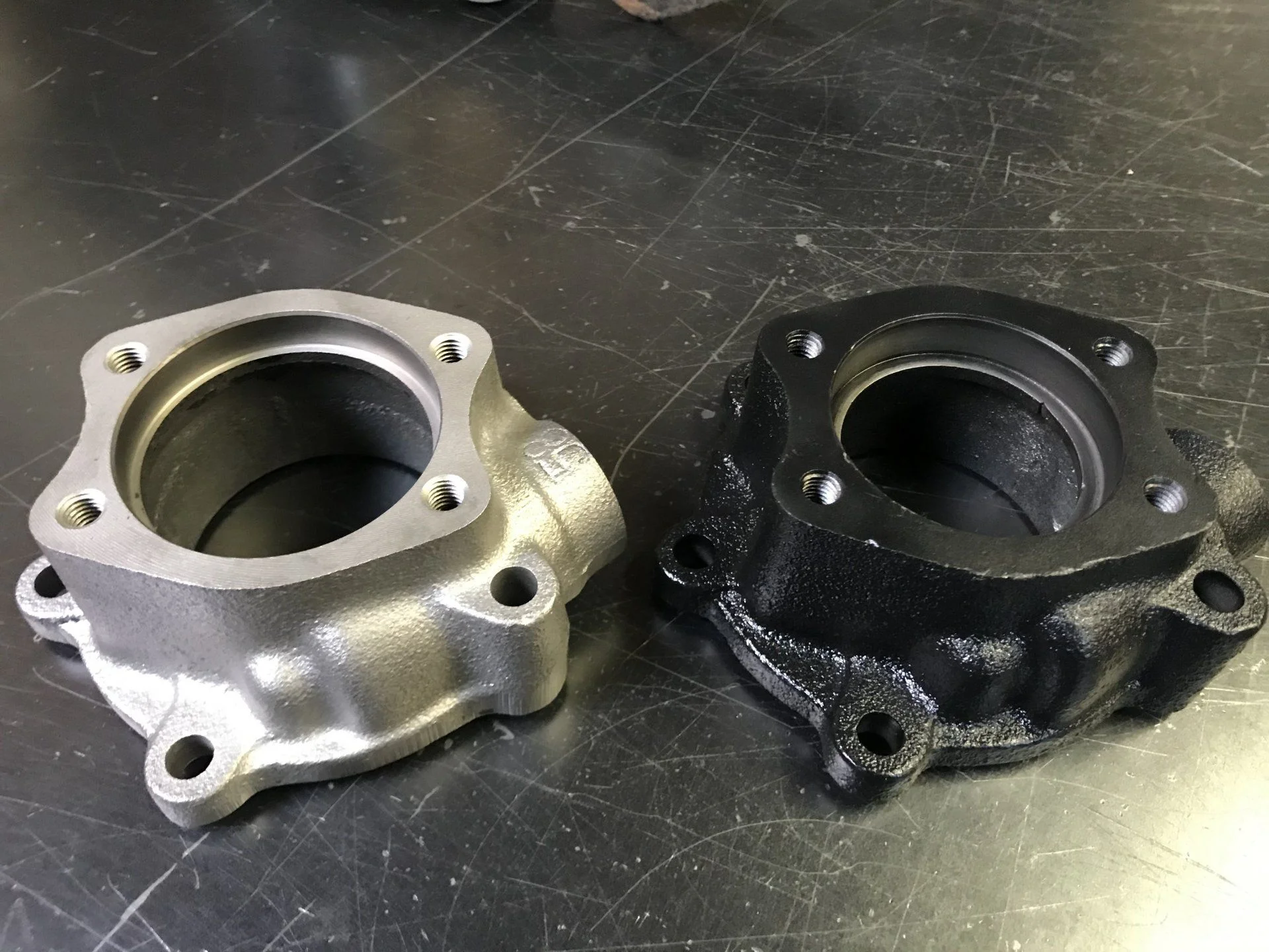

Quite a number of years ago somebody came up with the idea to put two seals in the extension housing instead of one. This requires machining the rear seal bore to create room for a second seal.

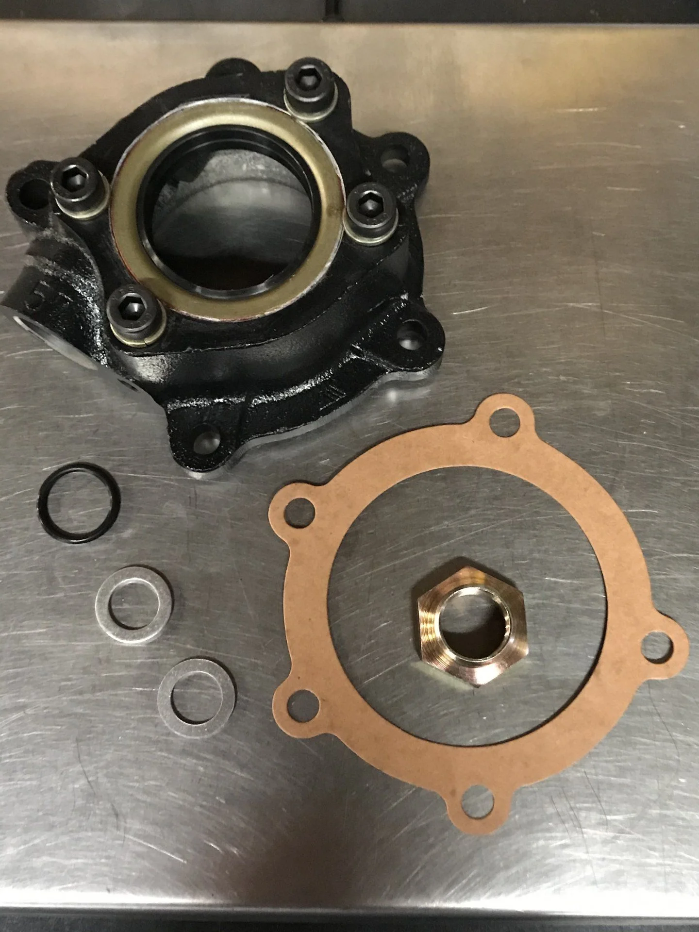

We offer these housings ready for install; in kit form. The kit includes a machined housing that has gone they the wash, been bead blasted and painted with 2 seals already installed. We also include a set of 4 Allen bolts to attach the e-brake backing plates; the factory hex bolts are a royal PITA and prone to rounding off. We also include a new speedo o-ring, extension housing gasket and stake but as well as 2 drain plug crush washers. That way every part needed for the job is included.

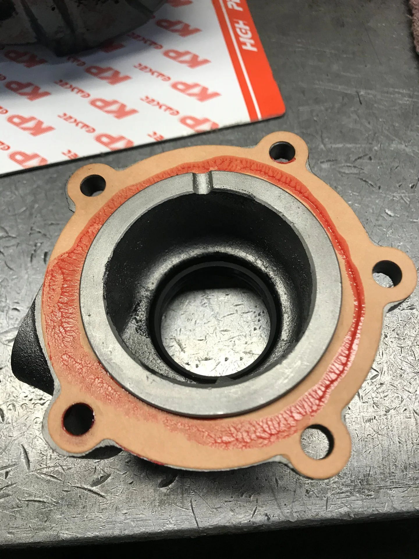

2) Clean gasket surface on t-case. re-install shim and new dual-seal housing. We like to use Loctite "formula 518" gasket sealer on both sides of any transmission or t-case gaskets ( red sealer shown in pics ).
3) Install both new o-rings supplied in the kit. One on the outside of the speedo bullet, the other on the inside. Then slide the speedo bullet back into the rear extension housing. We like to add a small amount of automotive silicone on the outer o-ring to help the speedo bullet slide in place.
4) Our kit also contains 4 allen bolts; one being shorter than the others. These are used to re-attach the e-brake backing plate ( since the factors 12mm hex-bolts are a royal PITA! The shorter allen bolt needs to be installed on the top left or it'll bottom out in the housing. A small drop of loctite on these bolts is a good idea.

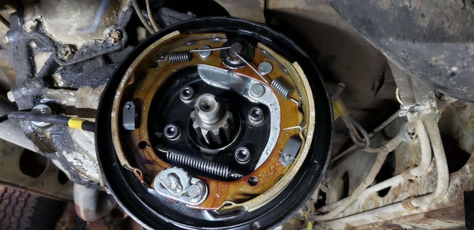

This kit is great. I had a terrible leak (first couple pics are from my rig) and the brake wouldn't hold at all. This is a great kit and one that every FJ40 should consider upgrading to.
