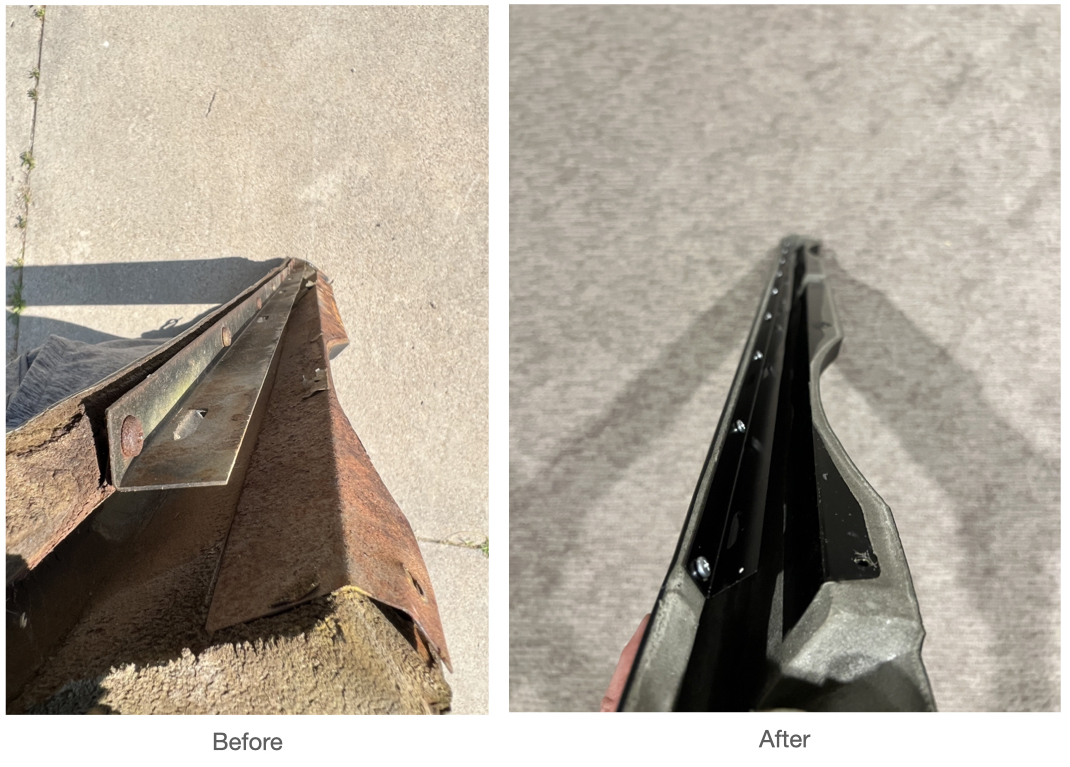

Basically the dash pad - Will have a pict of old vs New as last picture - the retainer was rusty (the rust under the windshield was documented several pages -and year ago). At the time of disassembly, I thought last summer maybe powder coat the retainer and other stuff might help keep it for the long haul - so was blasted and coated black -
Got OEM screws - the new pad doesn't not come with the light cut out - just generally marked where...
Starting lineup... (powdered retainer in the cellophane wrap)
san cutout...
and progress.
