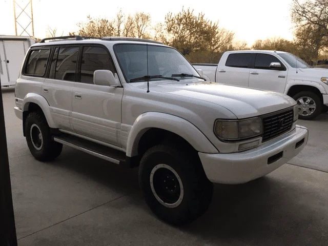

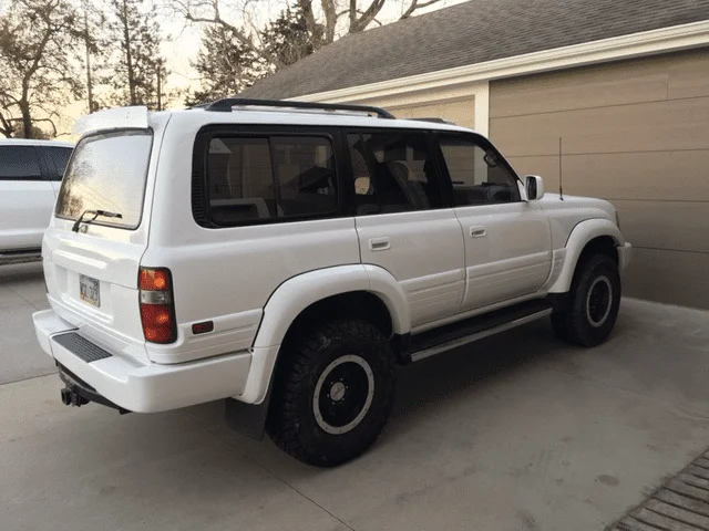

Fresh outta paint...
Have 3 more tires to install and then goes on slee bumper, etc...
Overall, real happy with the color. Certainly made it look a lot more modern.
No surprise for many, the slee bumper is d@mn heavy with the accessories on it (300lbs or so) Probably have to consider reinstalling the heavy duty springs out back... or a spacer on the current (+3" standard duty coils now). We'll see after it's all saddled up...

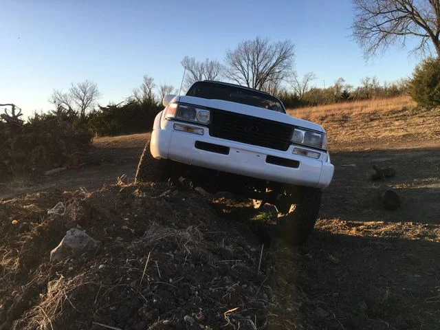

Built a little RTI ramp with the loader for some fresh paint poser pics... rear moves around well enough, but the front end is tight! Springs may be too hard up front for the amount of lift. Wonder if a lighter and longer spring might allow it to move a bit more... I recognize the front of the 80 is what it is, but surely a good bit more travel left in it... no illusions of building a rock buggy, just seems there's a good bit more left in there!
Tires are just 33s....
Sways ARE connected here... No surprise by lack of twist!

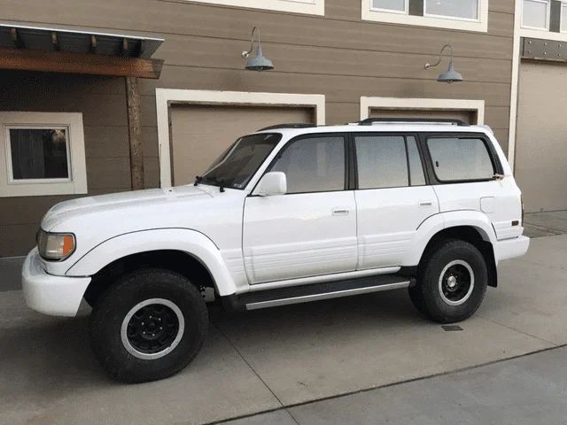

She looks great! love the white. I have the same wheels/caps on my cruiser and I found an easy way to get the front cap on. Gently peel the stainless off of the plastic backing, then cut a hole in the backing, put the stainless back on with 3m thick emblem tape. This will space the stainless part out enough to clear the front dust cap. Works great on my truck
