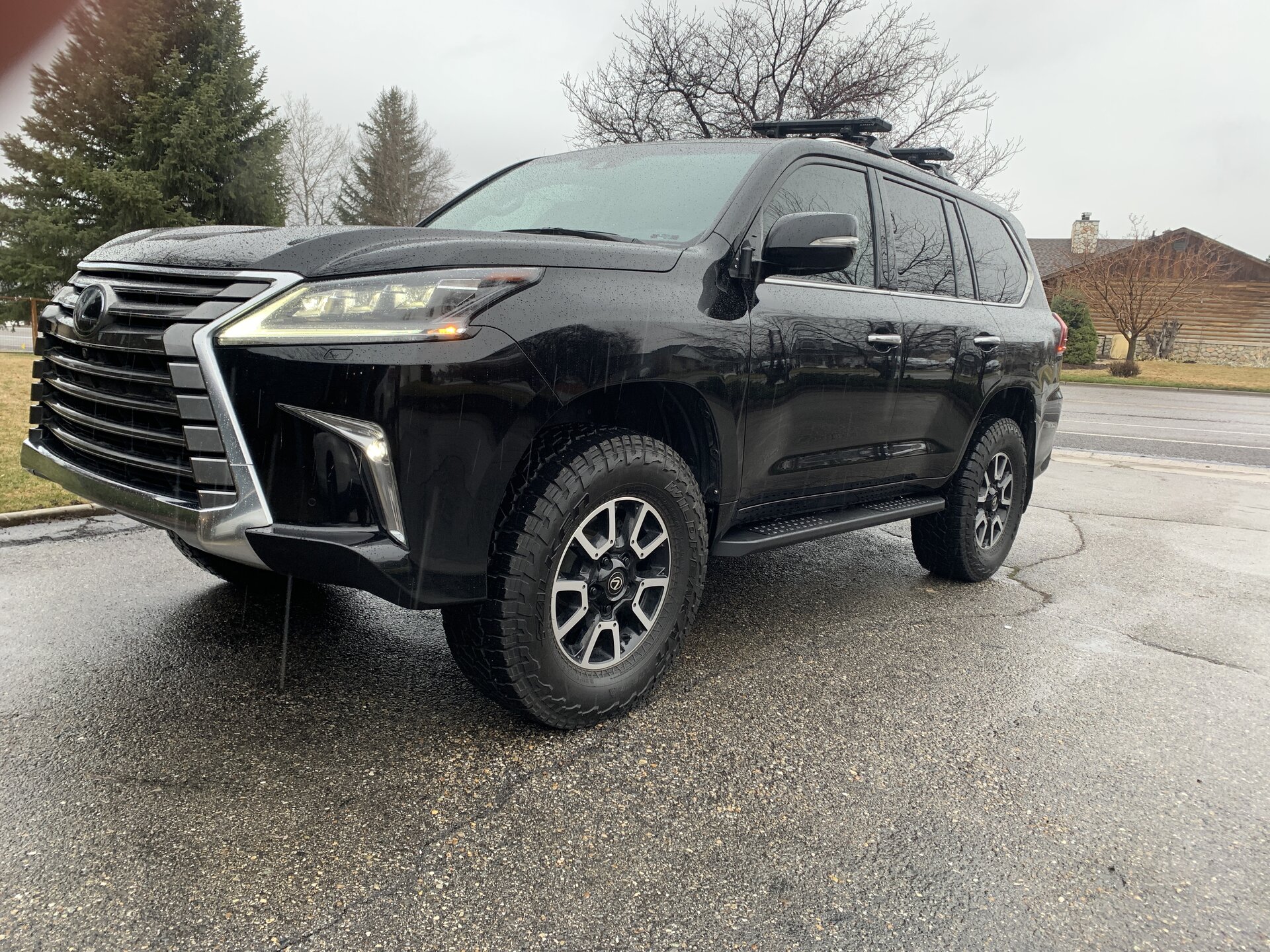

I had the tire store put on five LT295/70R18 Wildpeak AT3W tires on the Tundra TRD rims mounted with Spidertrax 1.25" spacers. I removed the "mudflaps" and did some heatgun remodeling behind the tires and also removed the small 4" flaps in front of the tires that also rubbed. I still have some rubbing in the front when in reverse and when AHC is set to low, I pretty much cannot steer at all.

Those tires look GREAT! Rims really fit the style of the truck too between the contrasting black and silver.

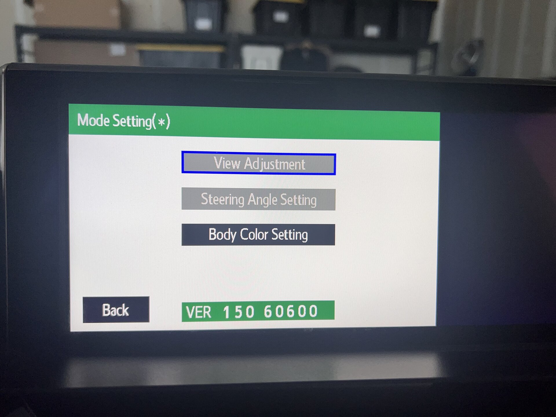

This morning, I used the secret code to get into the menu to re-align the cameras with the slight lift the tires give and change the color of my LX. (*these aren’t the adjustments I actually ended on)

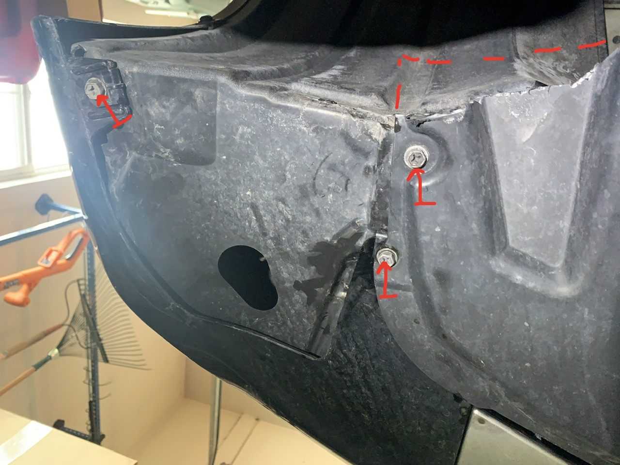

I also got underneath and moved the fender liners forward with new holes, trimmed the splash guard and the tires no longer rub.
What is the secret menu/code for camera adjustment?
Didn’t know it existed, but would definitely change settings if I can!
Details here for various years
Thanks! Awesome info, but is there another code to get all options?
Looks greyed out and I can’t click on the adjust camera option.
Looks greyed out and I can’t click on the adjust camera option.View attachment 3345523
If I remember correctly, you select the grayed out item and do a long press and it’ll let you in.

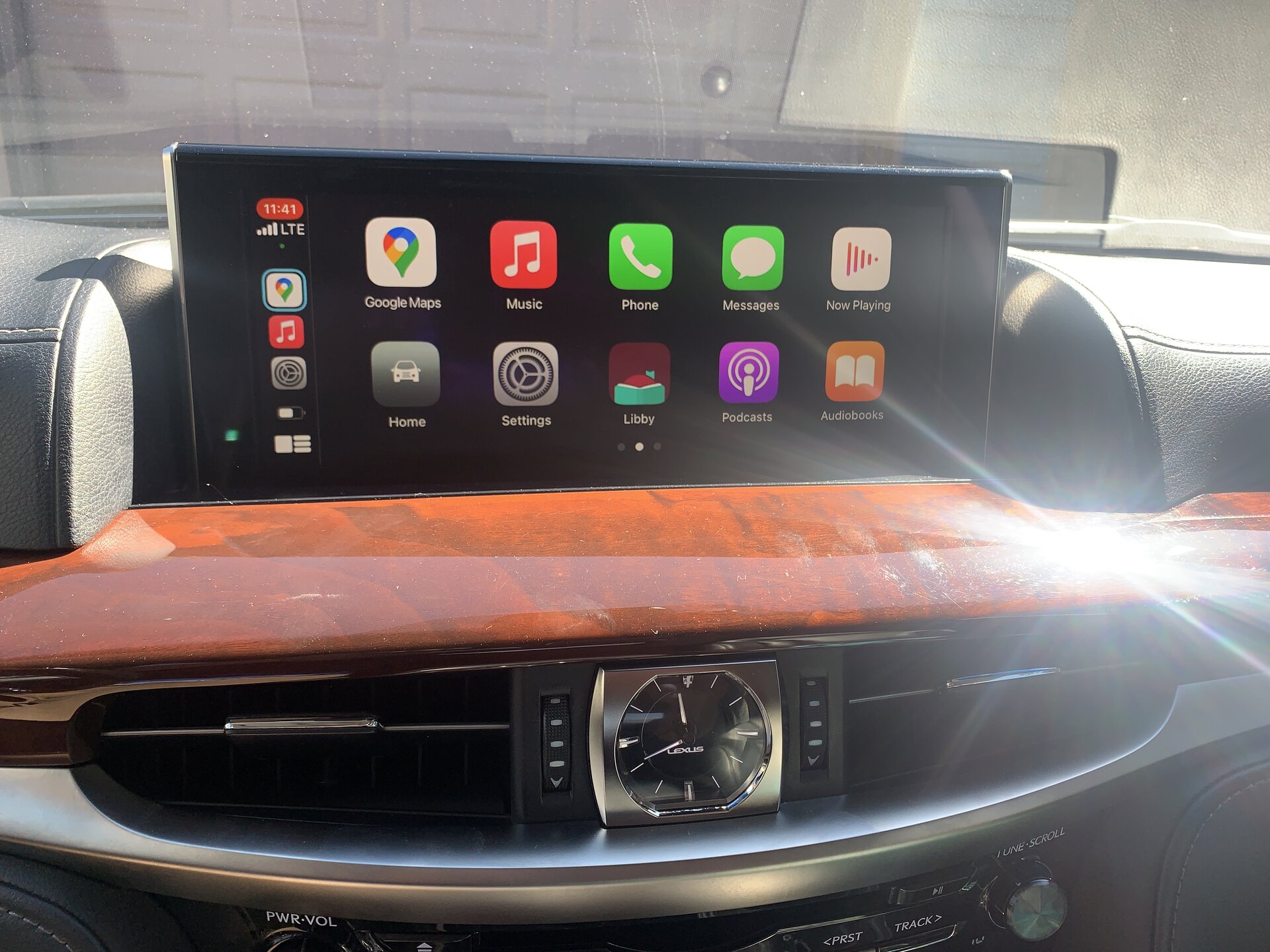

I finally got around to installing a CarPlay module “as a safety feature” per the wife since she doesn’t get along with the oem navigation.
I used the Amazon unit from this post:
Cheapest Carplay and AndroidAuto Retrofit under $300? 2016+ LX570 - https://forum.ih8mud.com/threads/cheapest-carplay-and-androidauto-retrofit-under-300-2016-lx570.1317115/
It works quite well after some tweaks like turning off joystick sounds in the oem interface, maximizing volume and changing the Bluetooth echo settings in the module settings. I’m sure I’ll have some other observations with more time but so far, it’s been well worth the sub $300 cost.
