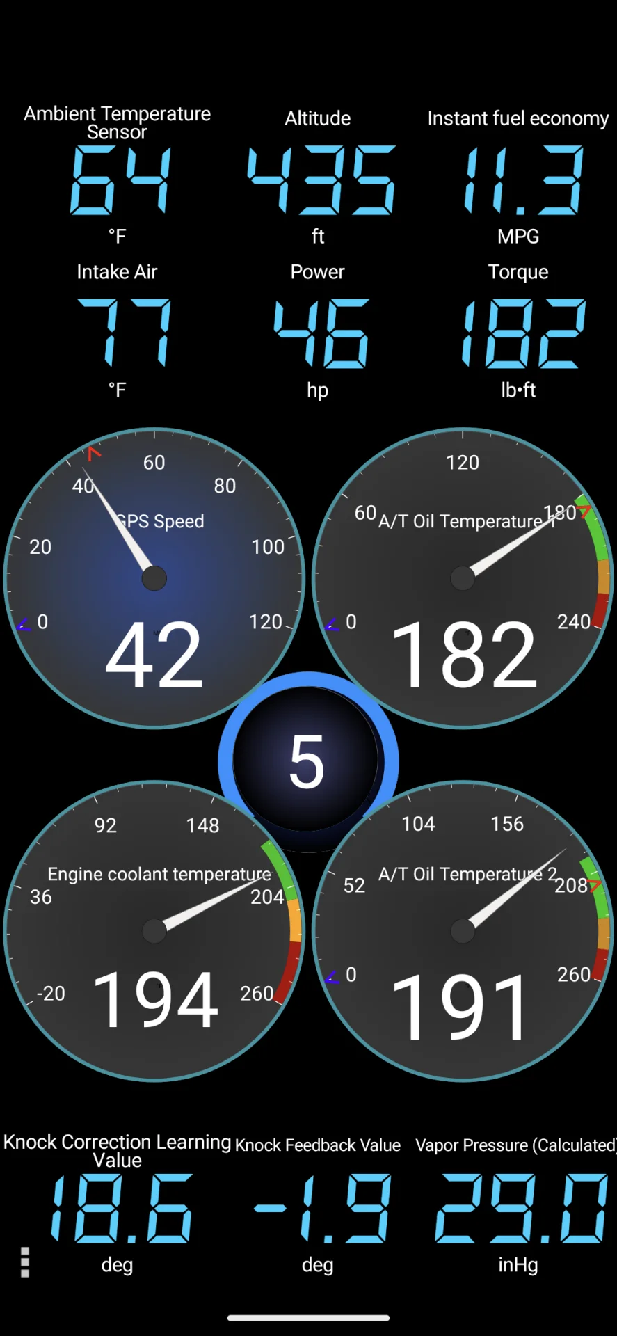

Instead of scan gauge, look at OBD Apps. OBD Fusion allows pretty interfaces to monitor parameters.
