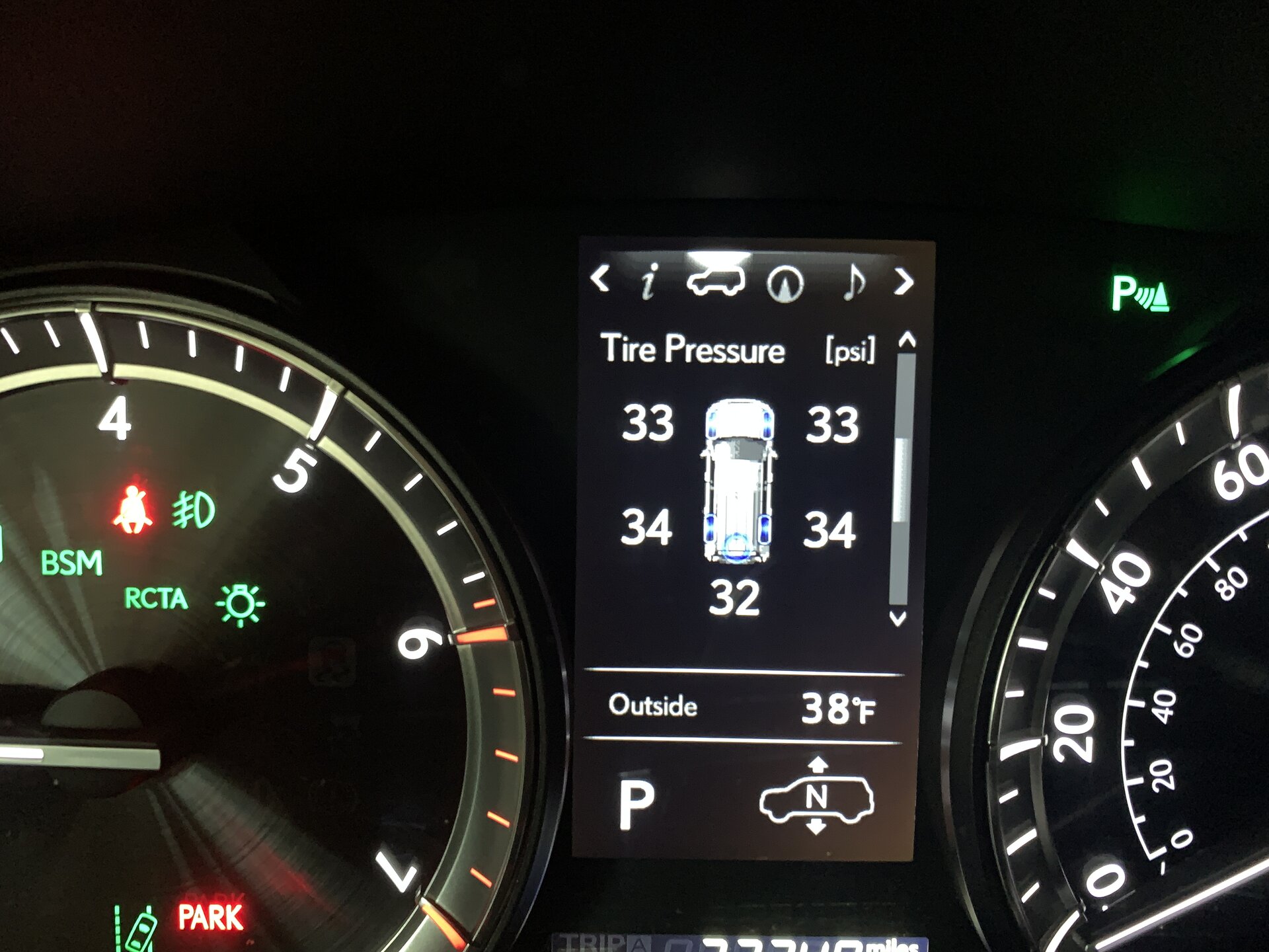

Relearn is a finicky b. I’ve had it learn in 5 mins, I’ve had it take two days.
I believe its looking for a certain temp increase.
Is it cold as hell where you are?
did it ever read in dash?
Okay. Yes it is somewhat cold here. High of 40°F. Ive had the car 4 days and haven’t seen it read yet.
Thanks.
Thanks.
drop pressure a couple psi from normal and try it again from dead cold in the morning. Lower pressure should increase temp variance. If that doesn’t work its something else and I’m not sure outside of reregistering the IDs.

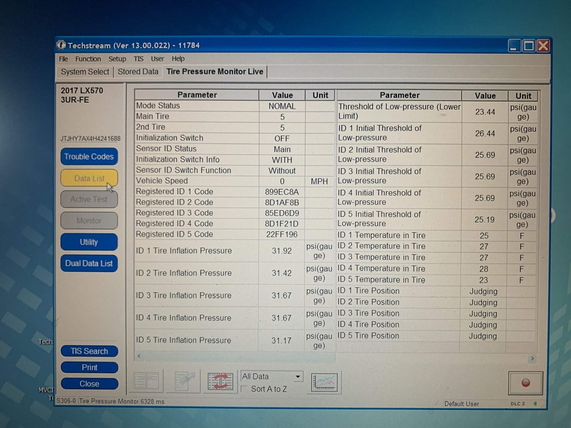

I was able to use techstream utility to manually assign the locations for each TPMS sensor since they were already programmed but stuck in the “judging” mode. I dropped the pressure on each wheel to ID each sensor.
Now, 1-2 minutes after driving, voila!

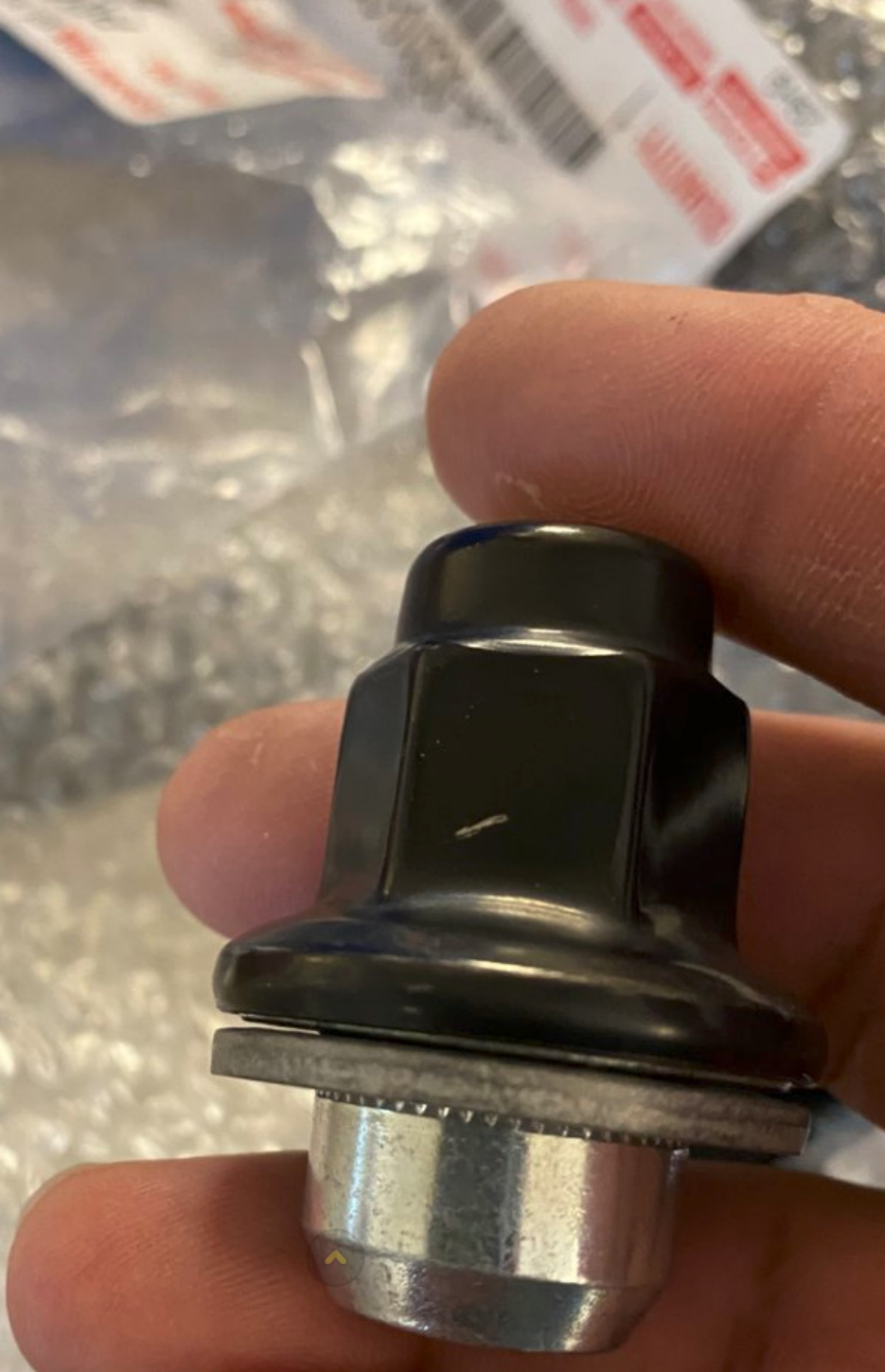

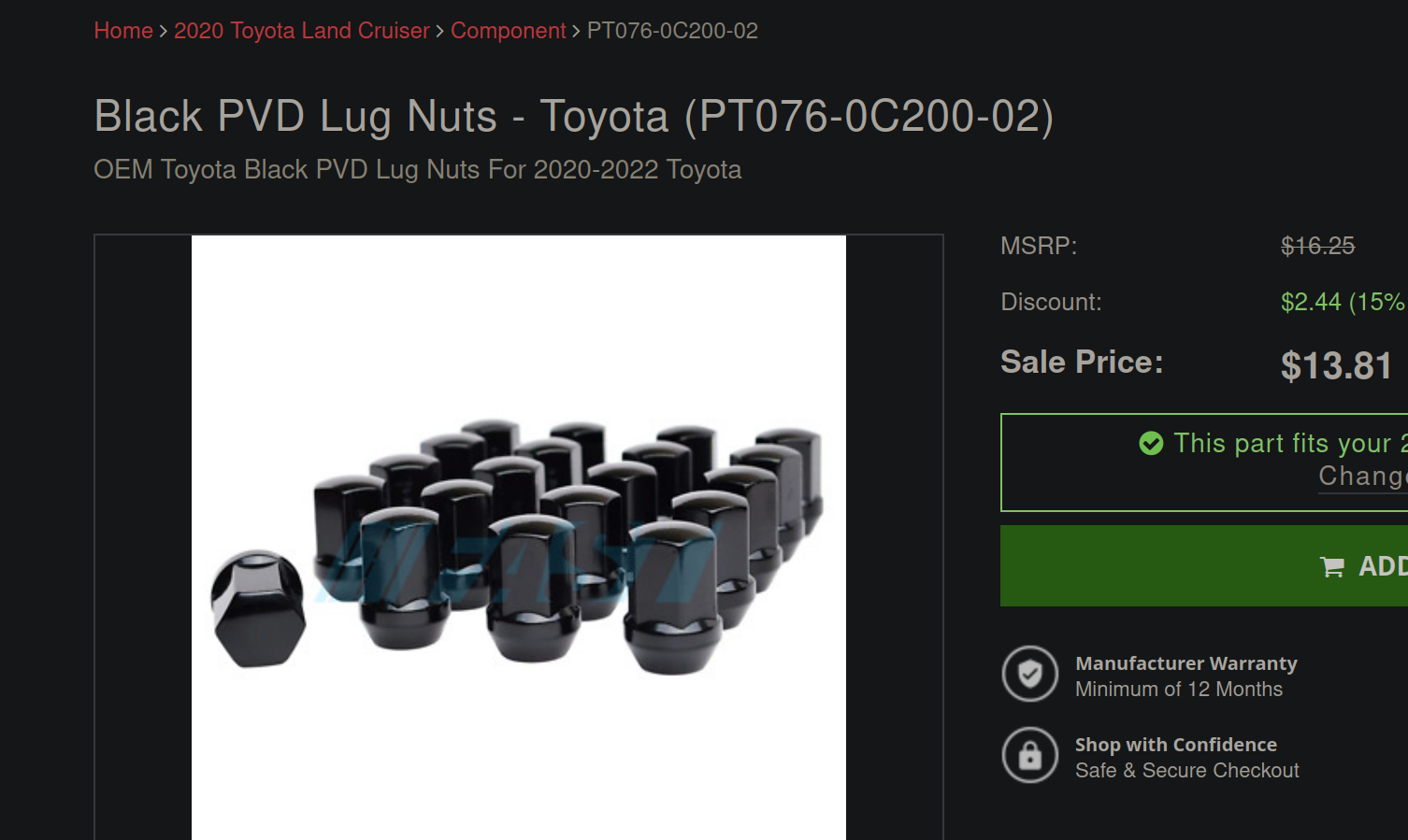

Also, If you want OEM black lugs I think these are a pretty good deal:
PT076-0C200-02 Black PVD Lug Nuts
All the product pictures online seem to be wrong but I did confirm with the dealer that these should work with the trd wheels and have the flat washer.
Did you order these already? The part description says they are wheel locks. I’d avoid those if they are actually the keyed wheel locks.

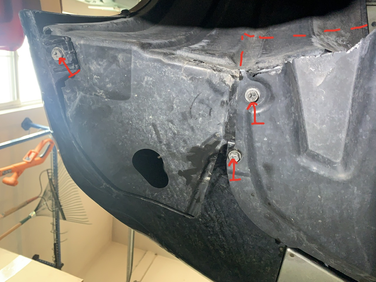

I also got underneath and moved the fender liners forward with new holes, trimmed the splash guard and the tires no longer rub.
