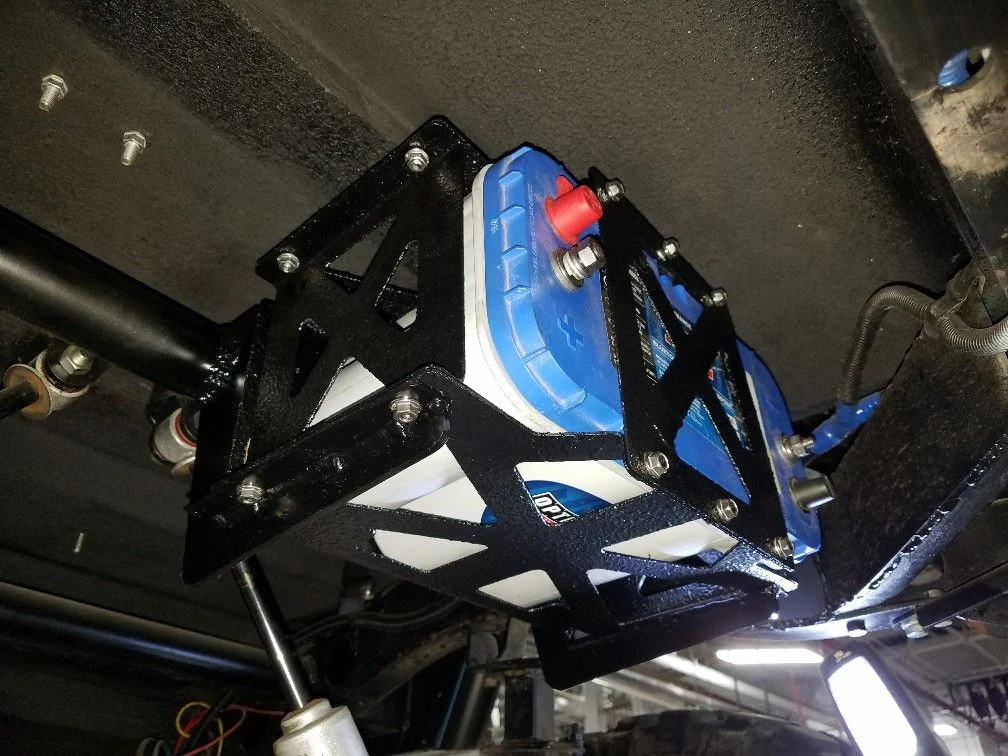

Metaltech has a bracket to mount a battery or batteries to their slider under the truck... Depending on how you look at it, the battery cable isn't much longer than in the OEM location.
Did this with the main battery on my buddies 95 toyota pickup. We ran 2/0 cable. Mounted batt under bed. Ran negative cable back through cab with a batt disconnect. Works great.

Mine does not use a sealed box, but I only drive on mag chloride roads once a year at most and then I wash everything. I raptor lined the entire box and used stainless fasteners. I like having it open as it's easy to work on and wash the crud off of. I gained a lot of need engine compartment real estate doing this. The 31 series battery turns the motor over with ease.

The only concern I can think of is moisture working it's way into the cable at the point where the cable meets the battery clamp, which with these clamps is pretty easy to seal up that connection point. The clamps themselves are pretty decent quality and should not corrode easily at the battery terminals. A little grease on the terminals would give even more corrosion protection which I may add.
