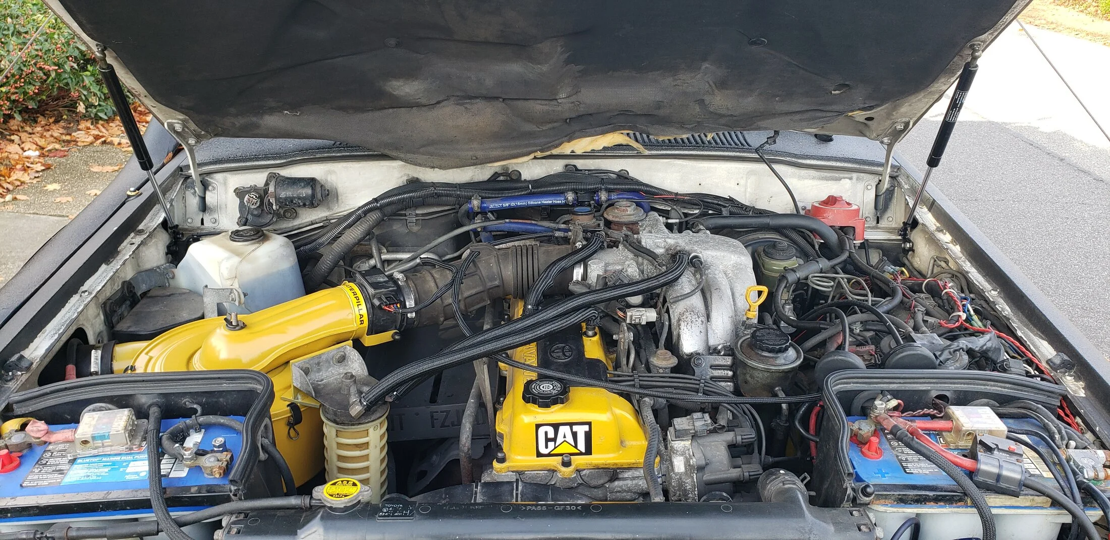

This is what I swapped to instead of the Blue Sea
There are probably other options and I'm interested in alternatives if there anyone has other suggestions. This one has been good and has solar input but options are good.
One problem I am having is temp. I made sure to get a lithium with lo temp charging protection but that means when it gets cold it shuts off to protect itself. Some 12v heat pads are on my short list to add next.
I also have a portable power station (Ecoflow) inside the cruiser but having the extra 100Ah under the hood is nice.

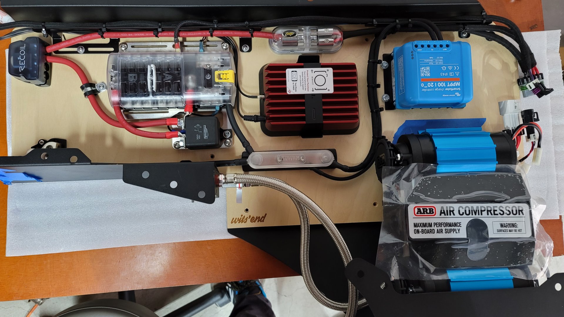

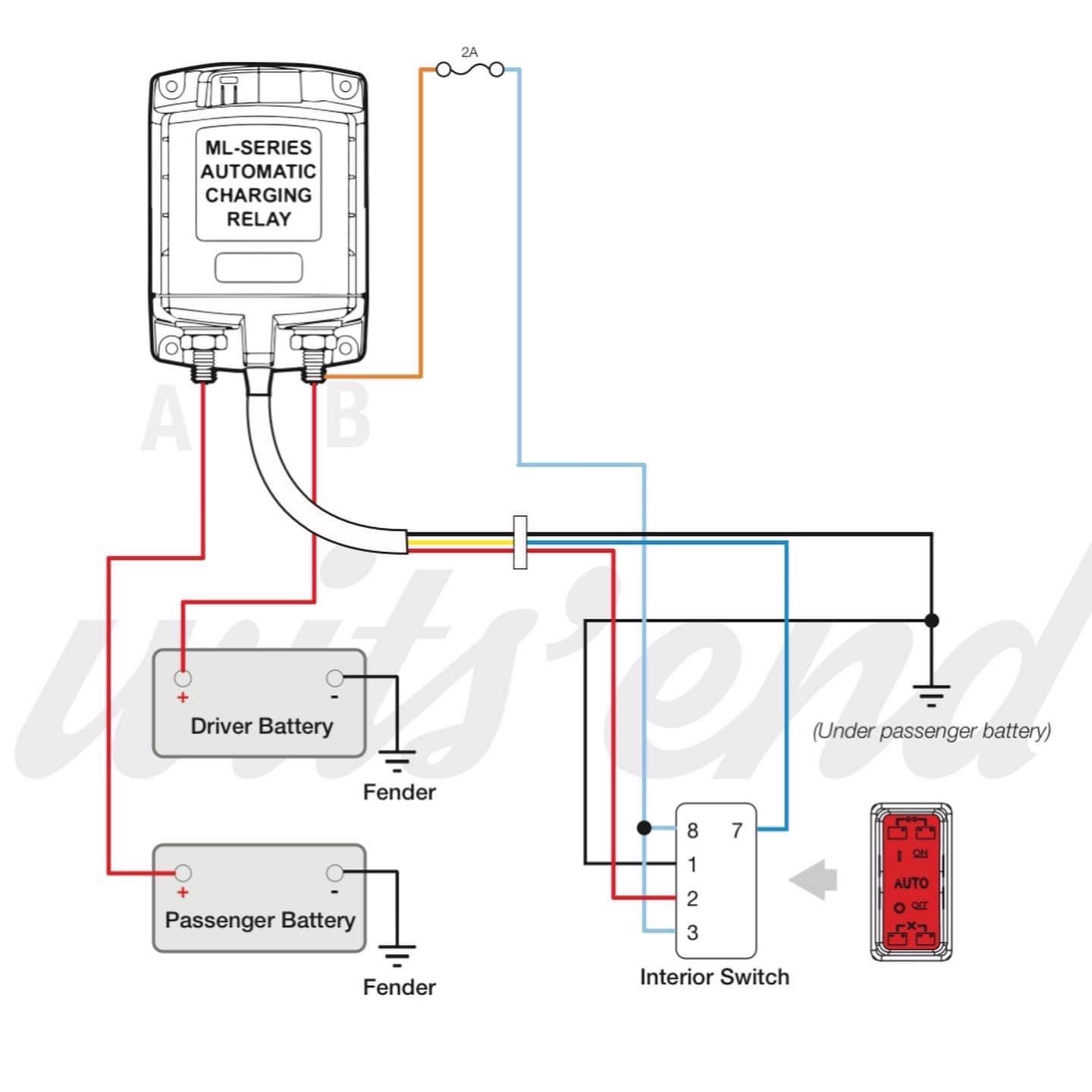

I guess I'll jump into this conversation as well. When I wired up my dual batteries I used a drawing I sourced from a out of business vendor. This schematic allows you to wire in a Blue Sea ML-ACR and with the dash mounted switch. The Blue Sea ML-ACR allows you to jump the batteries and self jump yourself if your starting battery does die.

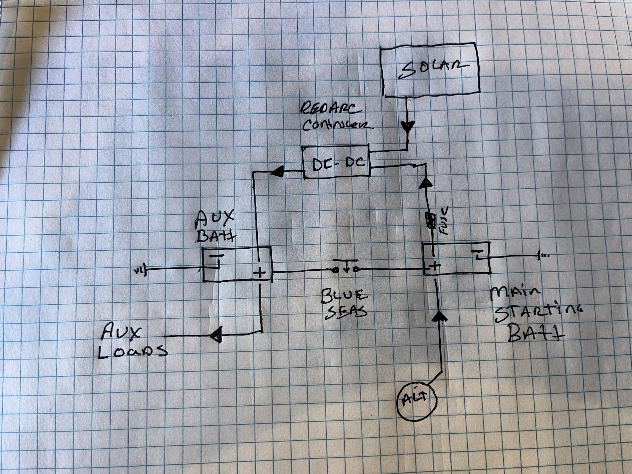

Then I was given this rough drawing for how to wire in a the ML-ACR with a Red Arc DCDC charger. This drawing includes solar option as some Red Arc DCDC chargers have the option for a solar hook up. The nice thing about having the solar option is that the Red Arc will pull power from solar first then the alternator. In no way am I am assuming the Red Arc DCDC charger is running full time, if it does adds the comfort of knowing your batteries are charged.

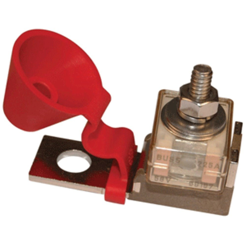

One last thing as far as connecting the two batteries via the ML-ACR, you will want to purchase (2) Blue Sea fuse block terminals, with a separate 200 AMP fuse. They will be mounted to the threaded post/MIL-Spec automotive terminal kit on the positive side of each battery.

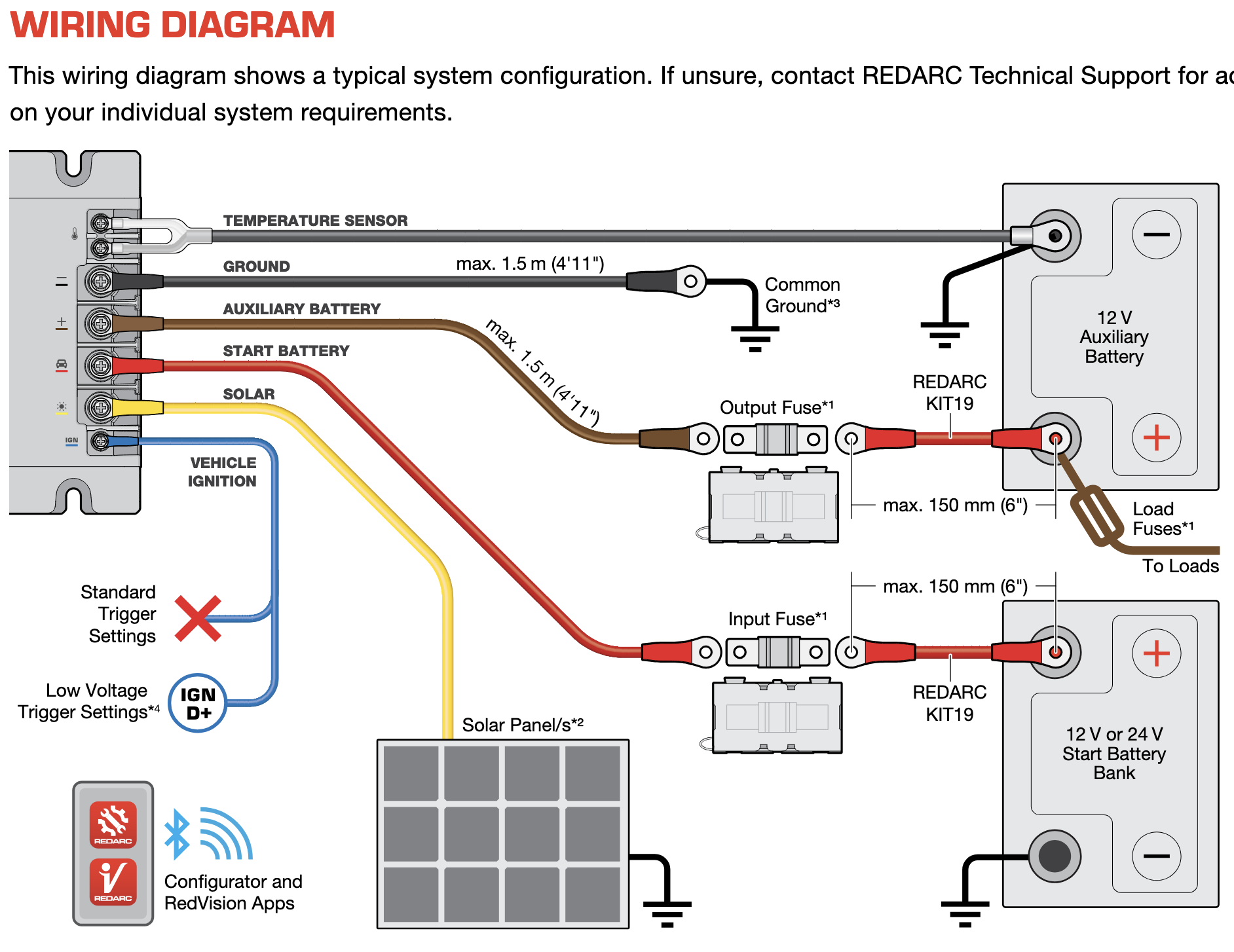

This schematic was sourced from Red Arc's website for their BCDC 50A Alpha charger. Most of the wires you see are included in these kits if I recall or can be sourced from Red Arc or a Red Arc dealer.

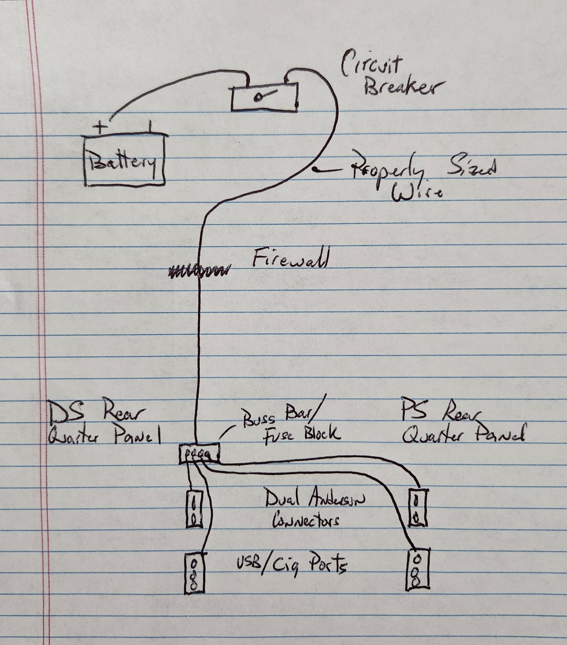

So after reading all of the replies, and since I have an Anker power station, I think I will abandon the dual battery install for now. I still want to run power back to the rear quarter panels (see the attached concept drawing). My Power Station will be used to run the fridge and other big draws when camping. The Anderson Connectors will be for charging the Power Station and running the fridge while traveling. The USB ports will be used for small draw things like phones, etc. at any time. I haven't looked into sizing for wires or anything yet. Let me know your thoughts and advice. Thanks for all the replies and advice!!

I have an AMI fuse between the battery and the circuit breaker, but it probably is redundant. Maybe some of the more knowledgeable electrical gurus can weigh in.

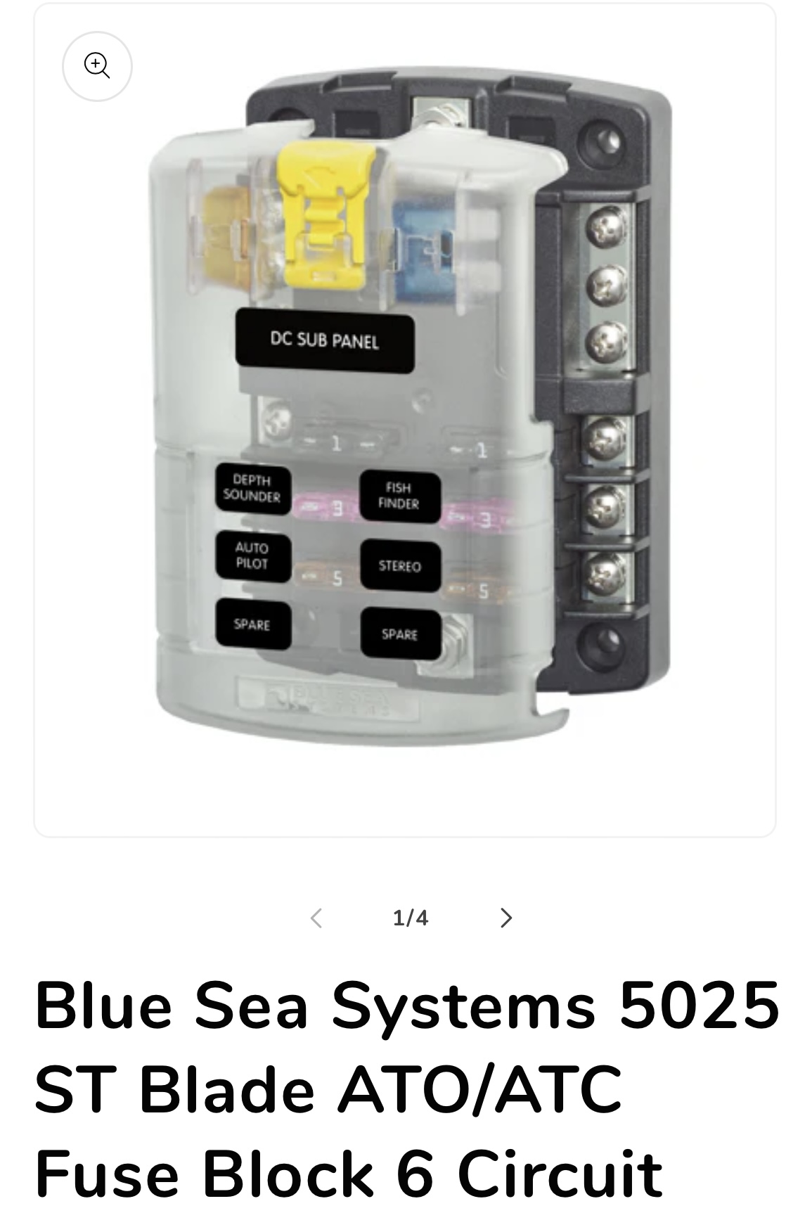

I used this Bluesea 5025 subpanel in the cargo area of my 200 (and my boat, lol). I like that it has a ground bus too. I ran the ground to a factory body ground point in the D pillar.
Be sure to size your ground to match your 12v positive (don't scrimp on wire size :) ).

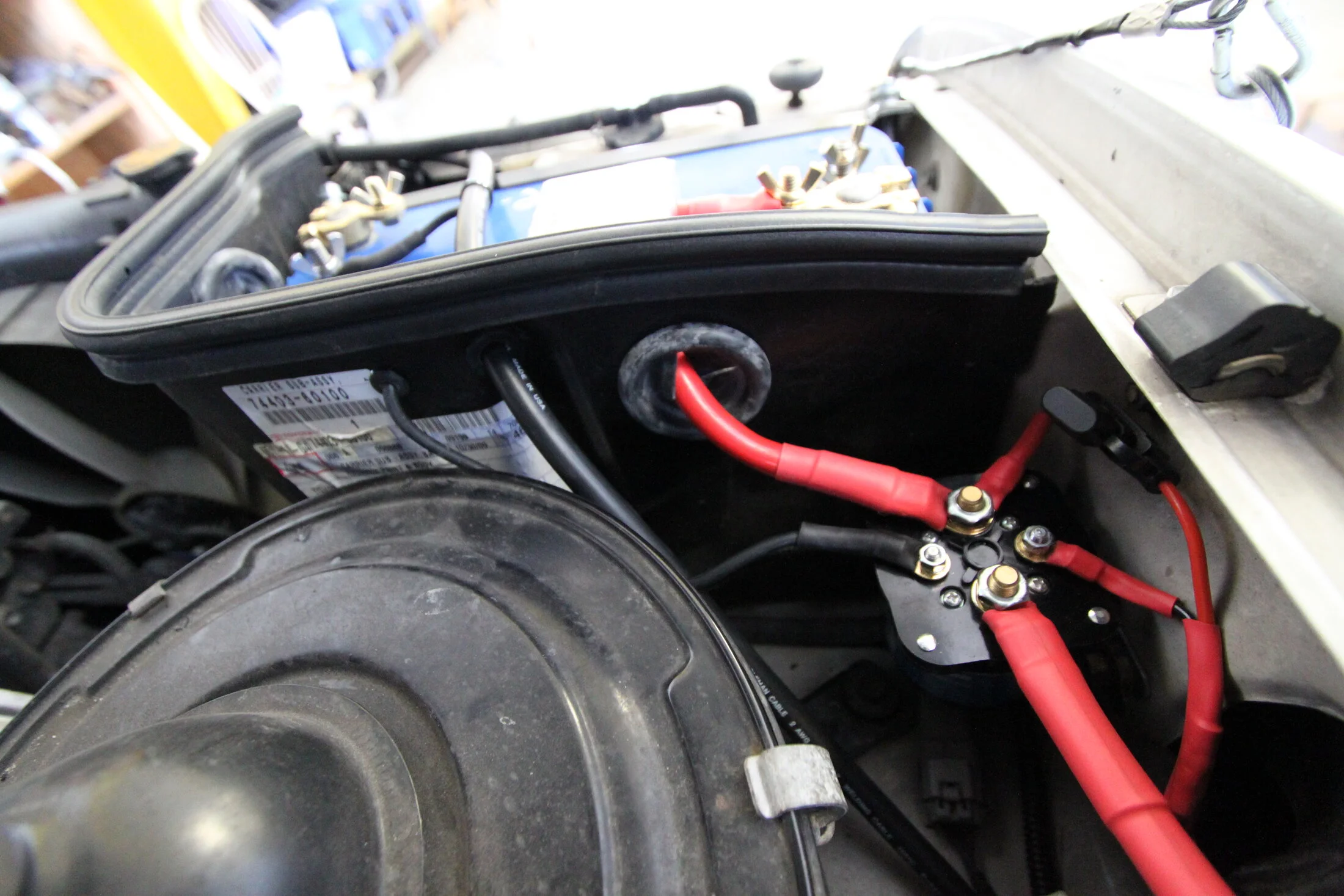

I kept mine pretty simple using a big 500amp solenoid and an adjustable timer relay :cool:
Main concern is that I wanted to be able to self emergency start in the event of a dead primary battery and still have ALL accessories (front/rear winches and a $#!t ton of lights) be able to work on the secondary battery alone in the event of a total primary battery failure o_O
Most battery isolator kits are limited to 250amps or so, which isn't enough when a winch can easily double that on a hard pull :meh:
