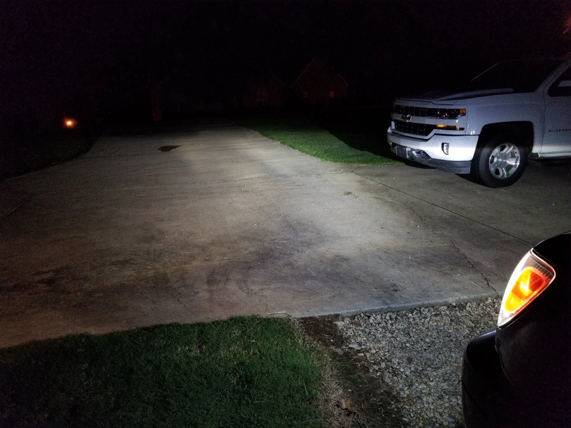

Here's the color compared to halogen:
And here's a shot of the broadcast at night showing the color of the lighted ground which I enjoy better than the yellow tint lights.

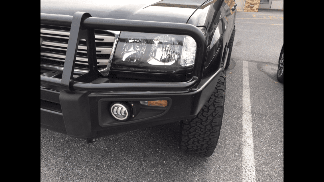

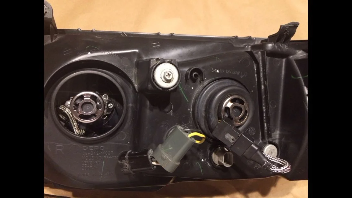

To make a crappy set up slightly less crappy I installed Lasfit LED’s in my DEPO headlights
What’s awesome about the DEPO headlights is that it’s internally wired so the install is a breeze. I did modify (aka cut a hole) is the rubber cap to allow the led fan to circulate fresh air more easily.
It’s been a year with no complaints. Not amazing but hi & lo beams are led, coupled with jeep jk led fogs put the provided h7 halogens to shame.
Signal & parking light are led and I have a pair of led arb signals to install when it warms up. Really excited about these as I’ll get rid of the orange lens.
