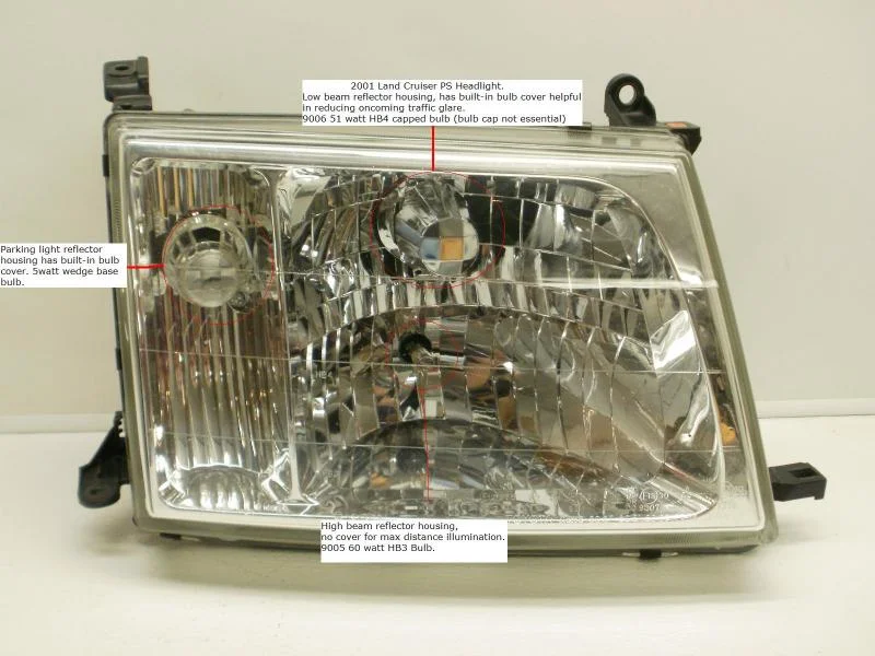

Minor modifications OK:
* Provided heat emitted by the bulb and wattage is comparable to Toyota stock (OEM) recommendations.
* Fogs lights with; parking lights, low beam & High beam on modification See: #124
OEM:
* Picture of OEM bulbs See: #58.
* Headlight (High beam) HB3 halogen #9005 60 watt.
* Headlight (low beam & Fog) HB4 halogen 9006 51 watt.
* Kelvin color temp comparison See: #75
* Adjusting Headlight Aim; 2001 LC FSM & Manual guide See:#57.
Example of reflective type headlight, 2001 Land Cruiser UZJ100:

HID bulbs should NOT be use in above reflective headlight housing.

I've run the HID setup, (bulbs, ballasts, etc)in the stock LC headlamp housings with original reflectors and thought the light scatter was horrid and all over the place. The light is bright but I didn't like the pattern and cut-off, or better said, the lack thereof. Before that I had the HIR bulbs, which use everything original from the vehicle, and I liked it. I got caught up in the hype when folks started trying the HID 'kit' in the stock LC headlamp. After a couple weeks of the HID, I removed them and sold them and went back to the HIR's I had originally installed. Those are still going strong to this day and the lumen output is substantially higher and noticeable over 'OEM' bulbs. Don't recall actual numbers of output of the HIR's, but I'm sure a search will yield those figures.

I’ve seen other HID negative posts’ like “HID bulbs get to hot for Land cruiser reflects” or “glare to diver and oncoming” and it’s said “best for projector lens”.
Those same posts, wrote favorable comments about HIR, as you’ve done here. It seems easy of install , and compatible with our LC reflectors type lens a plus. May be a step above stock, but which bulb within the HIR family does the best job, gives us your top picks?
Also, ***** I'm running the HIR high beam bulb for the highs as well as the lows. It keeps the same light pattern and projection as OEM ******, just more lumens. ******
How about pictures possibly a comparison to illustrate your opinion of HIR vs. HID.
:clap:
HID's IMO are far superior even to HIR's but only when used behind an HID projector lens. Without the lens, as a previous poster noted, the scatter is terrible. Add the lens and all is well.
HIDs on stock reflectors are a bad idea. If you want a proper HID setup, you need to install a projector. As said above.

I'm fairly new here and was afraid to open this thread.... I'm glad to see the responsibility here regarding not using HIDs on the stock housings, especially given how high the headlight housings are.
Even if the light was actually better, it's completely blinding to other drivers. Need to retrofit a proper projector and cutoff. Wish someone would tell that to Silverado owners..
