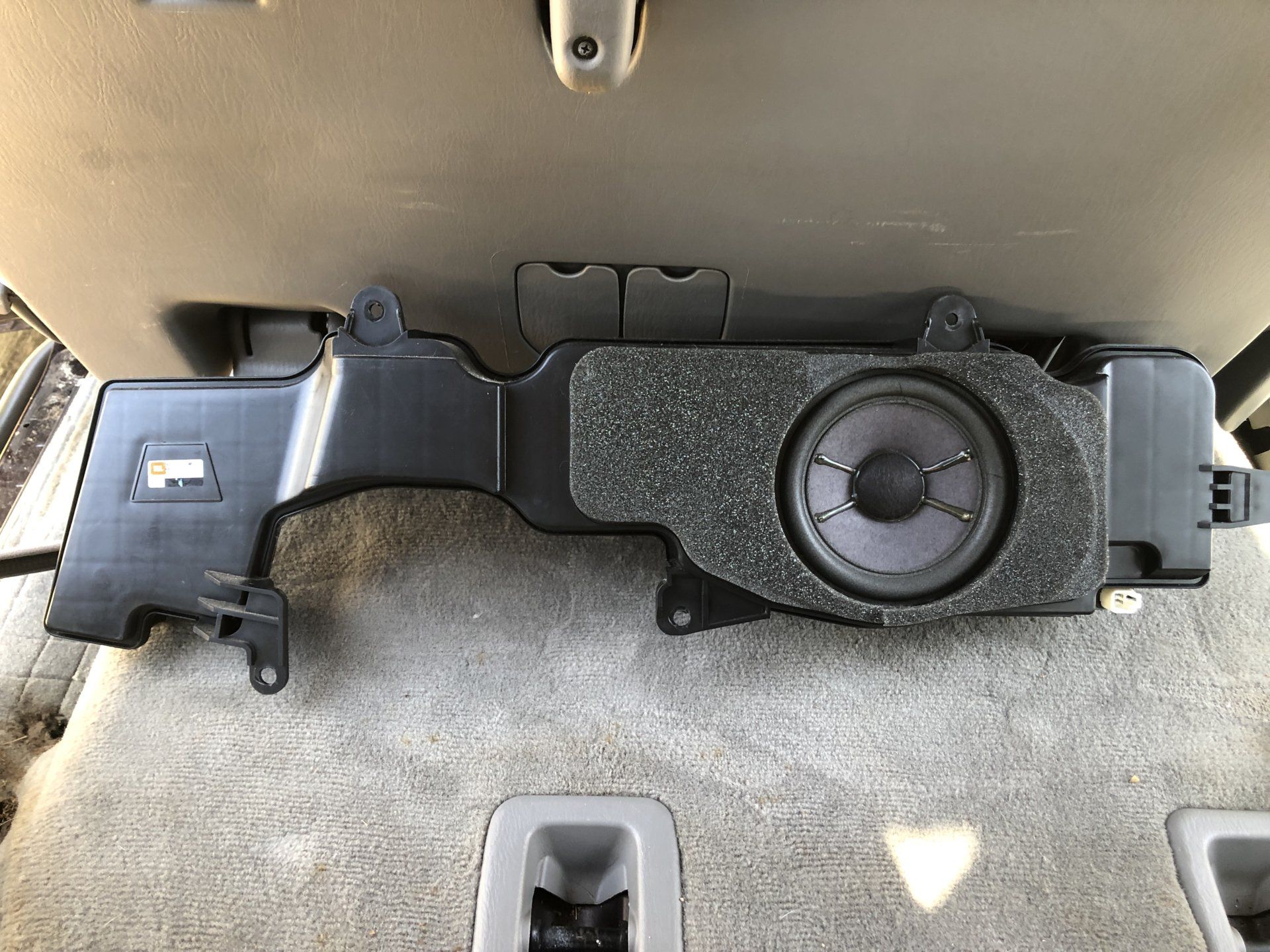

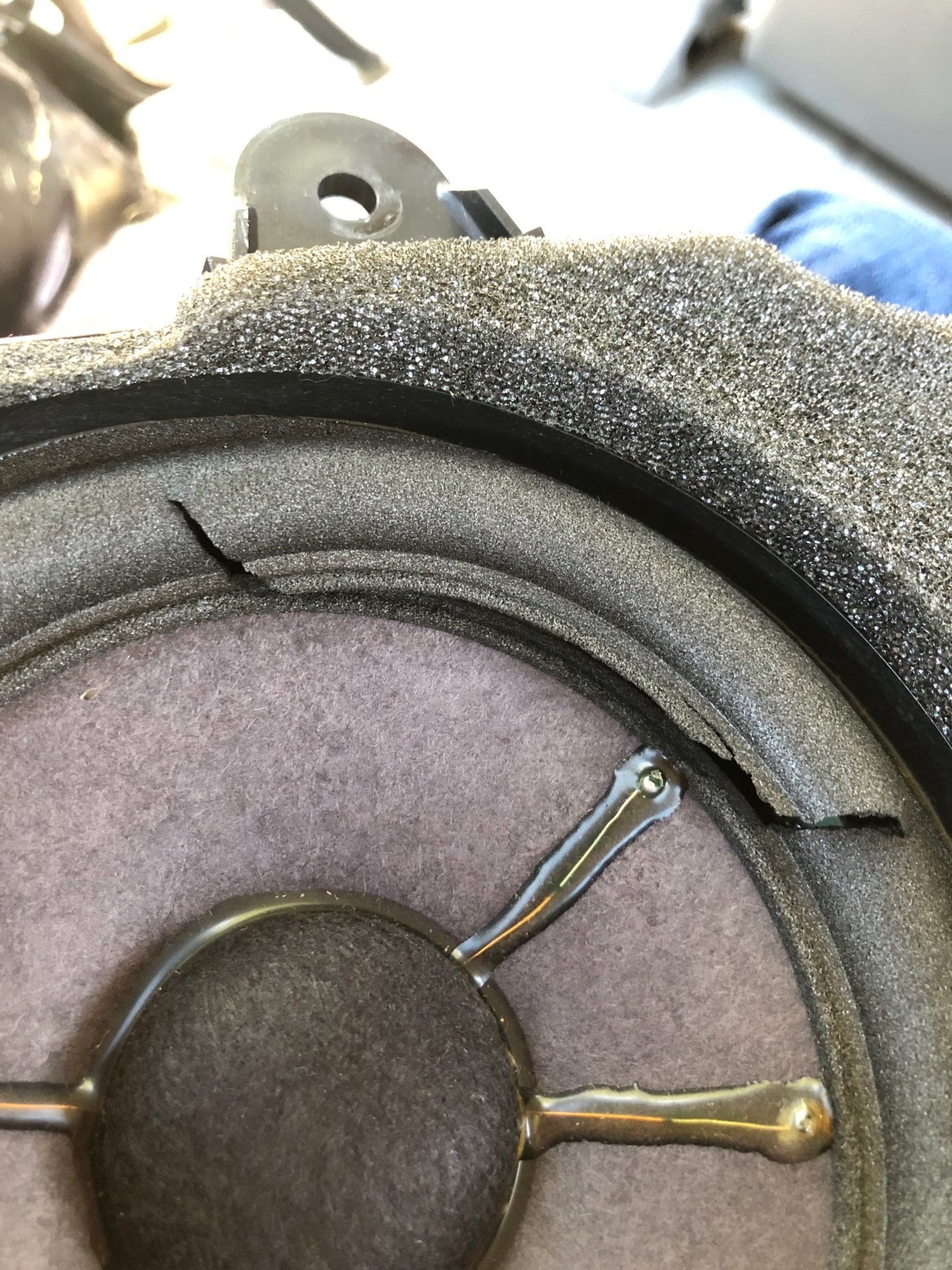

Well, I finally got around to swapping the sub. Thanks @abuck99 (PMs) for the assist on the wiring. And, as described, the sub sounds okay.
Overall, I’m surprised how much engineering, design and manufacturing/material Toyota dedicated to such a ****y sub, amp and enclosure... it really adds nothing. After getting it all sealed back up, faded the sound back to the middle, moved the bass up to about 70%... yep - it works. That's about all I could say. Sounds about like the factory sub.
So now, I’m considering a full speaker, sub and amp swap. Just gonna get an estimate next week.

You have a good memory. I did refoam the front door speakers. The sub failed the same way. Kinda tells me the back door speakers are a bass drop away from a foamy death too. I may take you up on the offer to listen to the upgrades you made. Maybe we can make the meetup dual purpose... and do some 'wheeling ;) Thanks Andrew.
