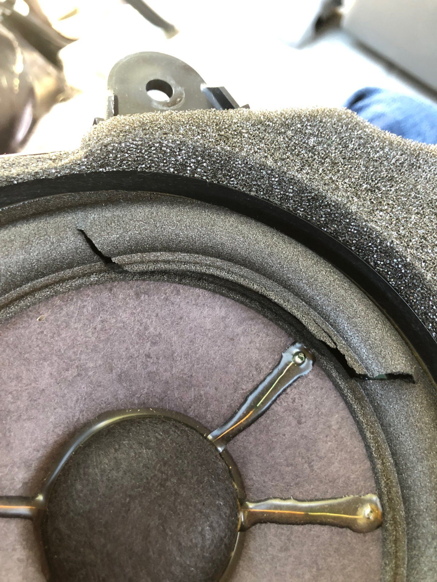

I had a guy refoam the front door speakers last year - they sound great. Is that the best option for the sub? I'm not looking to rattle the license plate, so this is one area where "failure = opportunity to upgrade" isn't as attractive.
Is there a reasonably priced drop-in sub... that works with the 2 ohm system? Or, stick with refoam?

Not sure on the direct sub replacement, as I went with an aftermarket box, but I am curious why you went with refoaming the front door speakers? Why didn't you just replace with a much better set of aftermarket speakers/tweeters?

The 100 has a 2 ohm system. The vast majority of aftermarket stuff is 4 ohm (and 8?). The research went in circles - decent speakers were the wrong ohm... some guys said it was fine... some said it wasn't... some said to refoam... I threw in the towel and had a guy refoam them.
If finding a sub that works with the O.E. system and fits is the same... it'll be another refoam

I dropped in a 2ohm Kicker sub. Its "ok". They're about $80. No major mods needed, just some trimming of the speaker grill to allow it to sit flush.

How did you determine that refoaming would fix the issue. My front DS sounds bad and probably will have a guy refoam too.
I have an 06 too. Overall, I imagine the speakers have broken down over 14+ years and refoaming would refreshing the sound system.
I too also got confused with the inconsistent reviews for the 2 ohm system and incompatiblity issues. Hopefully refoaming will be a good solution for me.

My speakers farted when at normal volume when a bass tone happened. If they make sound at low volume and fart at higher volumes it might be safe to assume a refoam will fix it. To fix it farting, you can lower the bass to the max negative value or unplug it.

The general confusion on this topic is widely caused bygeneral lack of understanding of ohms impedance, and people recommended what they did and validating it to be better based on their satisfaction
If your going to pay someone to do a refoam you’re likely going to pay more than just getting new drivers.
Also anyone that thinks those factory speakers lc or lx are made specifically for that factory amp is mistaken. Eq and crossover is determined at the amp and a good speaker is designed to perform within its designated frequencies. If you’re keeping factory amp match factory speaker impedance

And ^that^ reminds me of why I just had my O.E. speakers reformed.
Short of getting a full-on less in amps, ohms, impedance, speaker frequency... taking the information in a post like that and then shopping for speakers that...
- Fit
- Are as good or better than O.E.
- Match the impedance
- Cost less than or the same as refoaming
... led me nowhere.
Without your level of knowledge, I would've had to just keep posting links to speakers... "Will this one work?" "Never heard of this brand - is it as good as factory?" "How 'bout this one?"
Admittedly, I was hoping for: "Land Cruisers are my second hobby. Stereos stuff is my first. When my factor subwoofer blew, I swapped in a _____ and it was a direct fit" You know, like we get with all the other mods to these trucks ;)
I'm going to order that Kicker that @abuck99 linked. Thanks Andrew!

Factory subwoofers in these rigs are miserable. Just unplug it. I promise you won’t even notice the difference.
If you are an audiophile, you’ll hate the way the factory 8” subwoofer sounds anyways. It’s not worth the trouble. Unplug it and move on.

I dont disagree, even a suitable replacement is just “ok” but better than a clapped out paper speaker.

Dont expect to shake your body panels- it will add some improvement but not earthshattering.

Refoam it. That will take away the bad noises and actually make the whole system sound better. Simply speakers has the kits. Disconnecting works, but about 50% of the time to refoam. Easy DIY. Crutchfield has detailed speaker removal instructions.
Yeah, but an un plugged clapped out paper speaker is about as good as the plugged in paper speaker :)
I'd rather use the space for some electrical goodies like the folks do in the 60's and 80's rather than have a speaker in there.
