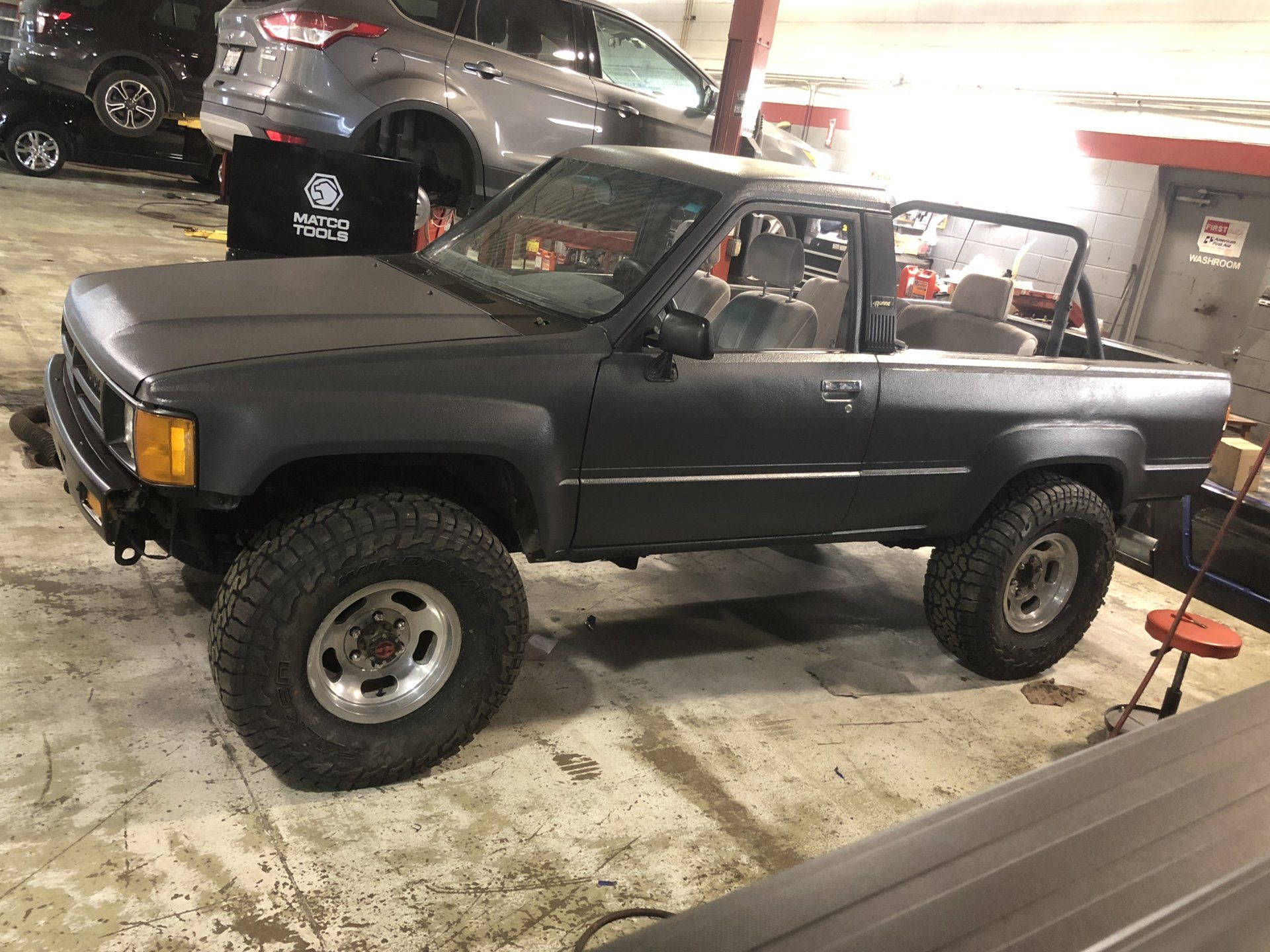

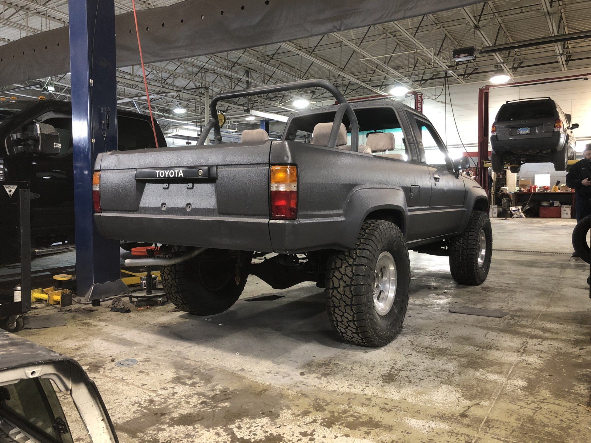

All done! Now curing in my shop for a day or two.
Application was much easier than I thought and I'm happy with the way it looks. This is my first time ever doing painting of any kind on a vehicle. The ML instructions are straightforward and easy to follow.
Based on my experience, I have some suggestions for other liner noobs:
Find a better/thicker tape or other solution to cover the holes left after the removal of the flares. In circles 1 and 2 you can still see small depressions left at the sites of some of the holes. I covered the holes with thin aluminum tape I found at Canadian Tire. After applying the tape, there were small concavities that I figured would be obscured by the ML. The liner didn't completely obscure them, however. No big deal to me but might be to others.
Spend more time masking than I did. While masking I was having difficulty with some of the tighter corners. I thought I had it sorted well enough but it doesn't take an eagle eye to spot some angular boundaries as in circle 3.
Anyhoo, those problems are mine and not Monstaliner's. The mixing and application was a breeze and I really like the texture that comes with the rolling.

Did you just patch over the holes or did you run a complete strip? Point being, is the monstaliner thick enough so that the edges of the tape don't show unevenly beneath the liner? What thickness tape did you use? I have a gallon of black monstaliner on the way and just picked up some 4mil 3m aluminum tape.
I patched over the holes with tape that I cut into rounded pieces. I can’t remember the thickness; sorry. The monstaliner is def thick enough to obscure the edges of the tape like you ask. What I was referring to in my post was the depressions caused by the tape not being thick enough (or maybe not tightly placed enough) to span the hole without being depressed in a bit.
Side note: my mechanic was pressure washing my truck one time and the pressured water blew through the liner and tape over one of my holes. He said he was up pretty close; I don’t know how close. Anyway, I plugged that hole with a little rubber plug thing and kept going. It’s fine for me. My rig is scratched and dented now anyway.
