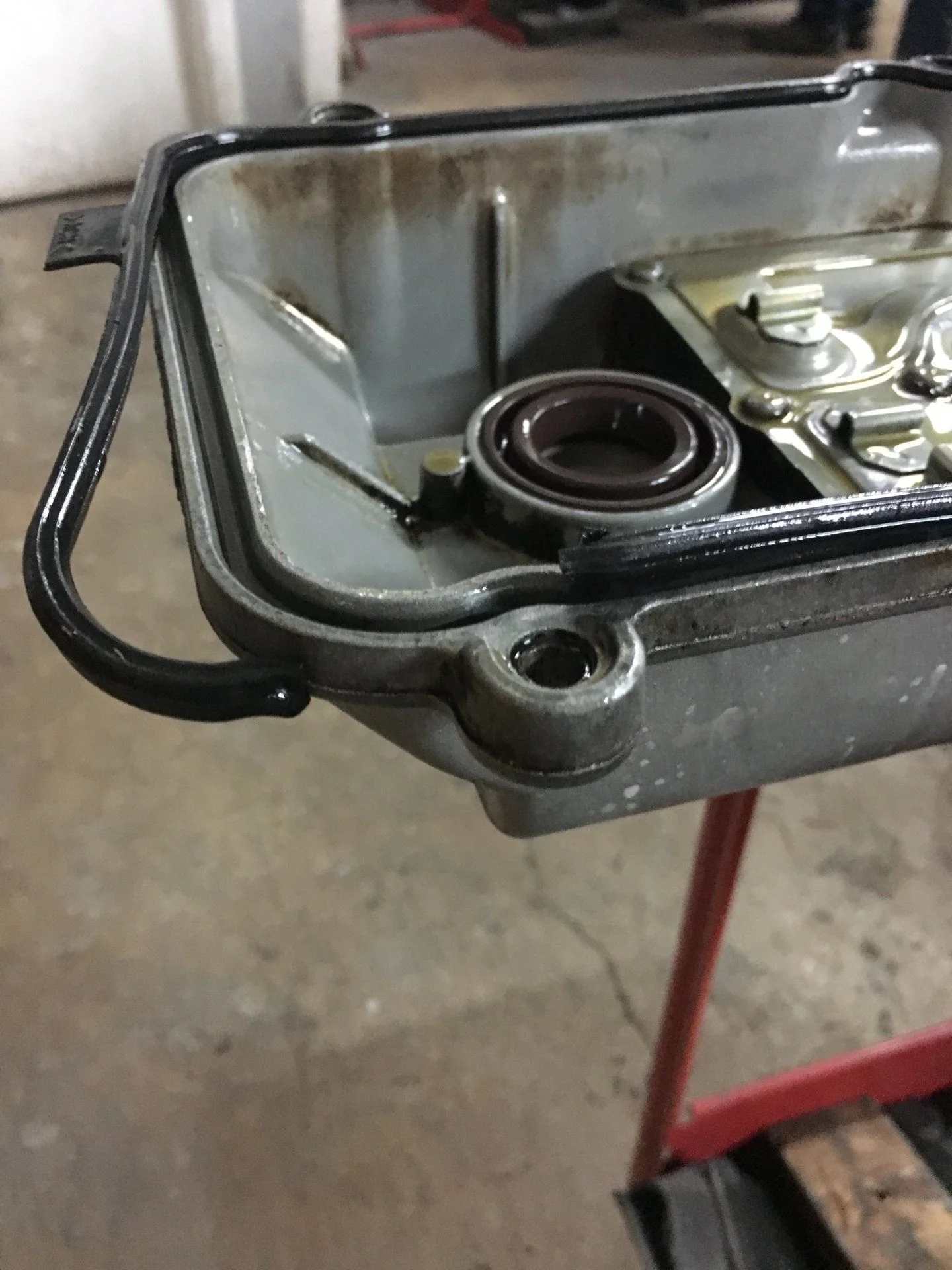

This is what appened:
Is the valve cover from the rear of the motor that is in the pic? If so, I bet the tranny is soaked and a lot of it just absorbed into the ecosystem that kinda finds a way to live on an 80. I found a pine cone from Colorado in my spring after it hitched a ride to Minnesota. There is probably from soaked out dust pockets up there and that is why you didn't see a massive drip.

^^^^Looks like back of valve cover. No flare for cam sprockets, or the fill cap collar.

Still, the most strange thing is:
Why it didn't loose oil in the city but it did in the highway? I believe that the POS Mobil 1 had also something to do with it

Synthetic oil seems to have a uncanny ability to leak when the opportunity is presented. Since you already have a few thousand miles there's really no need for break in oil. I'm not rebuild expert but if it were me I'd run some decent 10w40 dino oil for a few thousand miles since you are in a warm climate and then switch back to a 10w40 synthetic.

Because on the highway, you have more sustained higher RPM and there is more oil being retained on top of the head. In the city, you have up and down RPM and he oil has time to drain back down.
Sorta on the same idea..... I am a Studebaker guy and the early Studebaker V8's would fill up the valve covers with oil if driven at sustained high RPM such as 80+ MPH (4000+ RPM) on the interstate and then all at once they'd start smoking heavily. It was sucking the oil through the valve seals. The oil returns inn the heads were not drilled large enough, so they increased that size and the problem went away. Basically, a similar issue.
