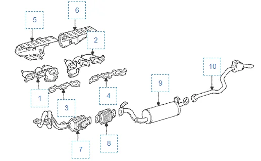

I will be installing a full new stock exhaust system on my 1997 CE in the near future. I had saved my pennies and I now have both cats (7&8), muffler (9), and resonator tailpipe (10).
I am having trouble findings threads that I thought I had book marked, addressing all the other parts I will need to bolt this up to the manifolds. I think there are gaskets at each joint that I need and the mounts too. Does anyone have the factory part numbers for the rest of the parts I need to do a full replacement?

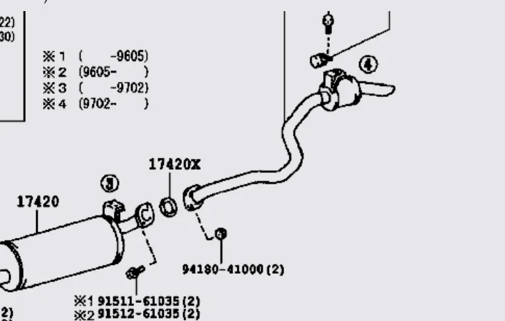

17420PIPE ASSY, EXHAUST, CENTER
17403-660411€ 498.56
17420XGASKET, EXHAUST PIPE, CENTER
90917-060761€ 11.15
17430PIPE ASSY, EXHAUST, TAIL
17405-660101€ 293.66

Ignore the prices; they don't mean anything.
Partsouq has diagrams with all the parts, part numbers, and if you want you can order through them
