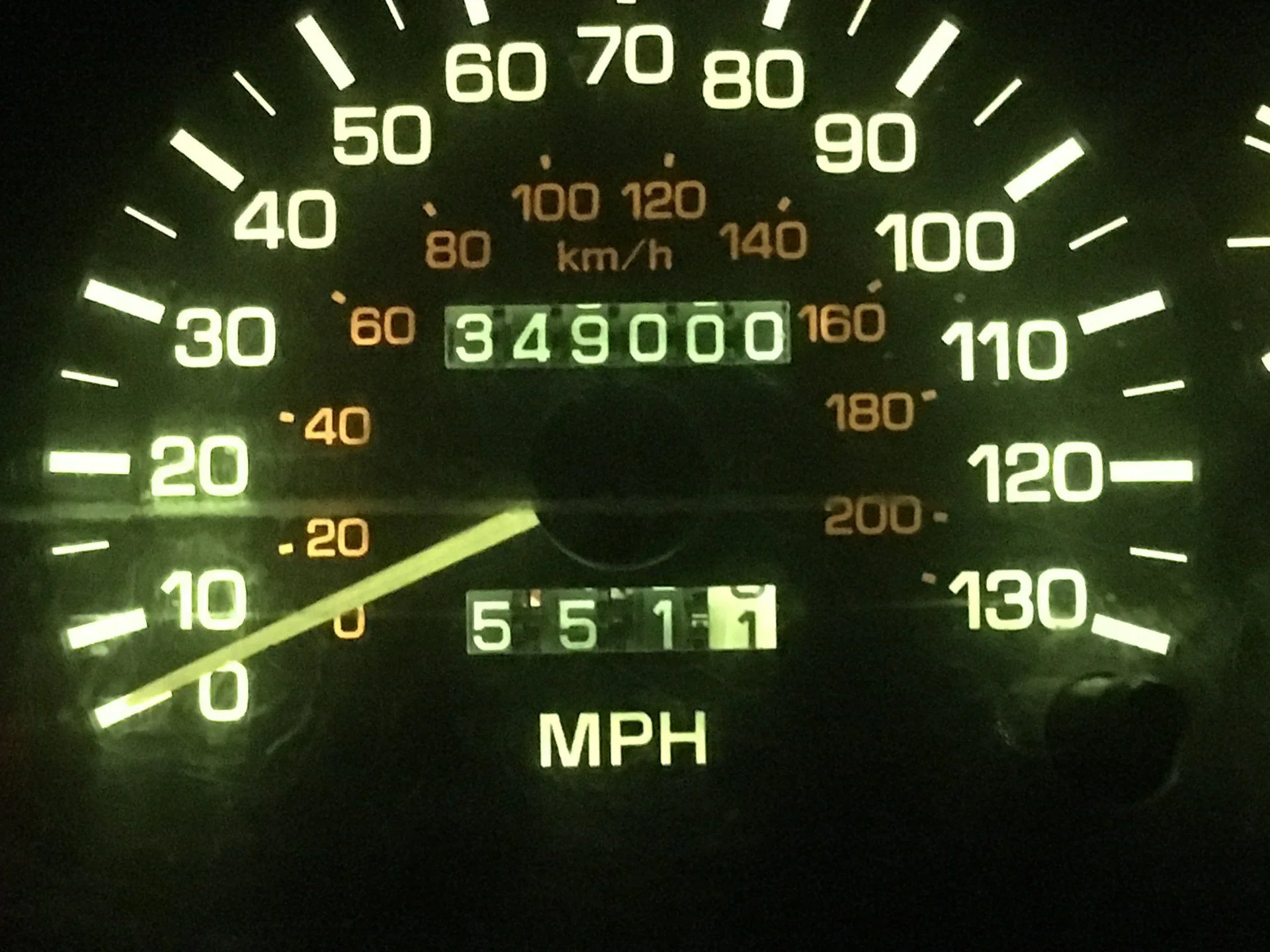

I reached this last night. Am I safe to drive it hard yet?
