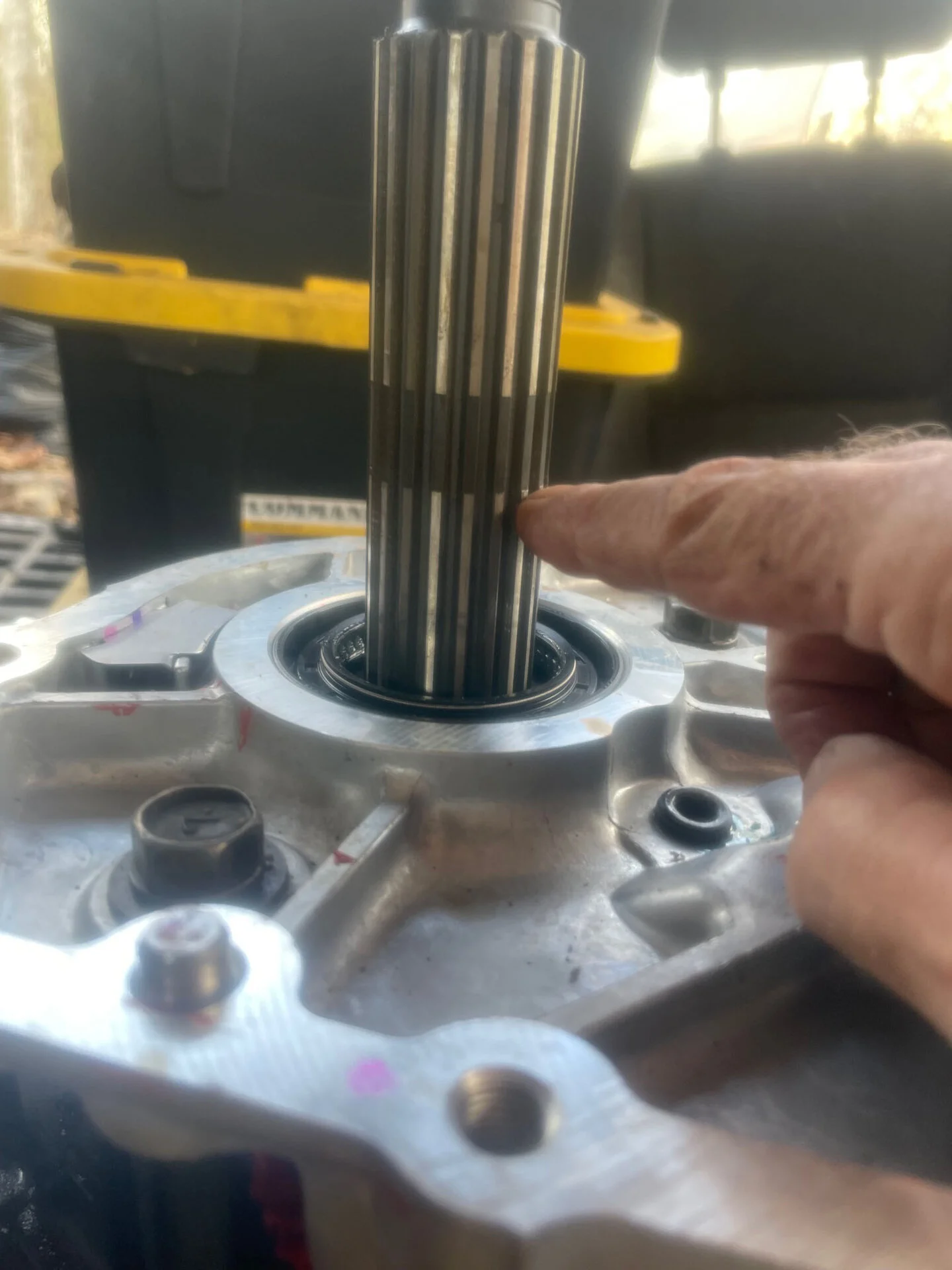

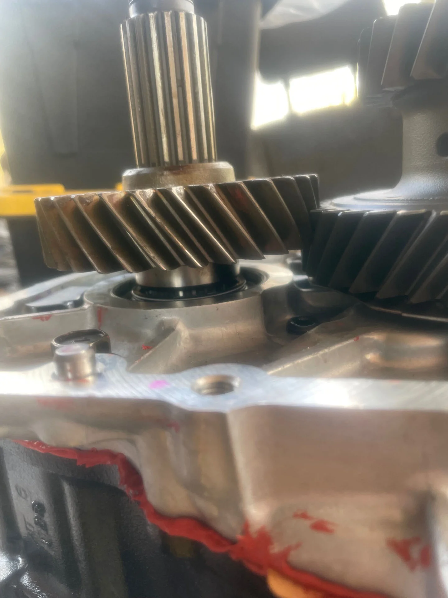

Next was installation of the t-case input gear on the transmission output shaft. This is a new Sumo gear and it would not fully seat. I flipped it over and checked for the point of interference on the shaft, which was where the dark band transitioned to light. I first suspected an issue with the Sumo gear, really this a new transmission and things ought to go together smoothly. The Sumo gear fit the old transmission without issue. I checked with the old input gear on the new transmission shaft, same interference issue. I had to also smooth down this section of the output shaft until the gear would fit.

It's common to take a thousandth or so off the input shaft snout with emery cloth so you get a slip-fit with new bearing/trans.

There's corrosion on the transfer case gears in your photo.. it appears like there is at least.
I had gotten a little orange sealant on one of the teeth and the other stuff that appears to be corrosion was a heavy grease substance that I cleaned off prior to final installation. This was new out of the box input gear with no corrosion.

I thought about heating cooling of the parts for fitment I think the interference was greater. The male shaft was ca. 0.4-5 mm (IIRC) than the female bore of the gear. I tried tapping the gear on with a rubber hammer and but it could not be driven on more than a couple of mm past the spline transition on the shaft. Once I had the shaft sanded enough for the gear to slide down most of the way I still had to drive on to fully seat it.

As for the transfer case gears…. No clue.
