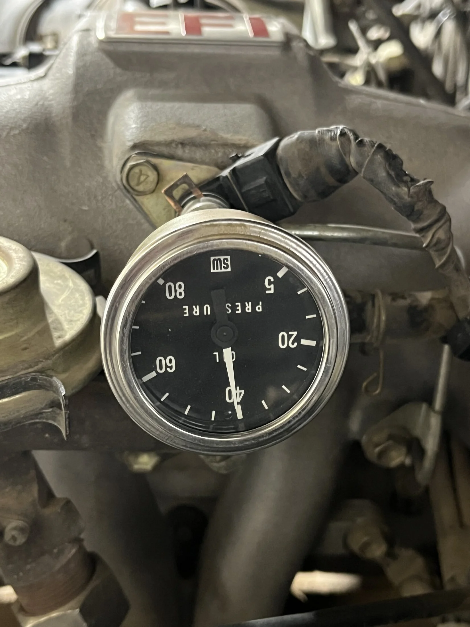

Just reference for yourself or anyone reading the thread to troubleshoot fuel issues... install a 1/8 NPT direct reading gauge to test pressure using the LCE adaptor 1093076 at the cold start injector. Eliminates the guessing.
