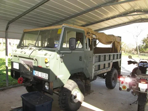

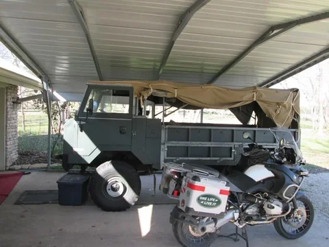

Great link! Someone in the Land Rover club has a line on several sets of 7.50 x 16 XZL's - funny how these things come out of the woodwork after you've already bought...

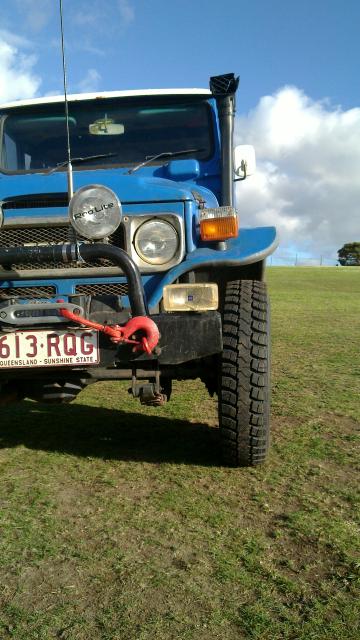

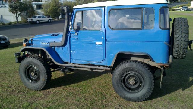

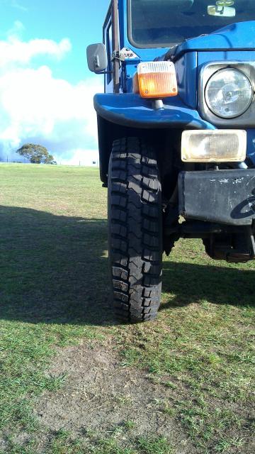

Weird I find it hard to get the impression those 9.00r16's are a 36" tall tyre.. for those in Oz I managed to source some 8.25R16 which measure a true 34". These are truck tyres and I'm told they are use for mine spec vehicles.. also 10 or 14ply.. so pretty tough... I thought these tyres would be too rigid for a shorty but they aren't and ride comfortably at 30-40psi. Wet weather performance with a rear locker is to be expected but for the most part they are pretty good..
The turbo'd 3b does ok pushing them but struggles with hills or when towing a load.. reckon the 15b-f wont have any issues at all..
Oh these are Haulmax tyres : http://www.tyretraders.com.au/index.php/tyres/truck-tyres/haulmax-tyres-att-304-detail on stock 16" split rims.. with tubes..
