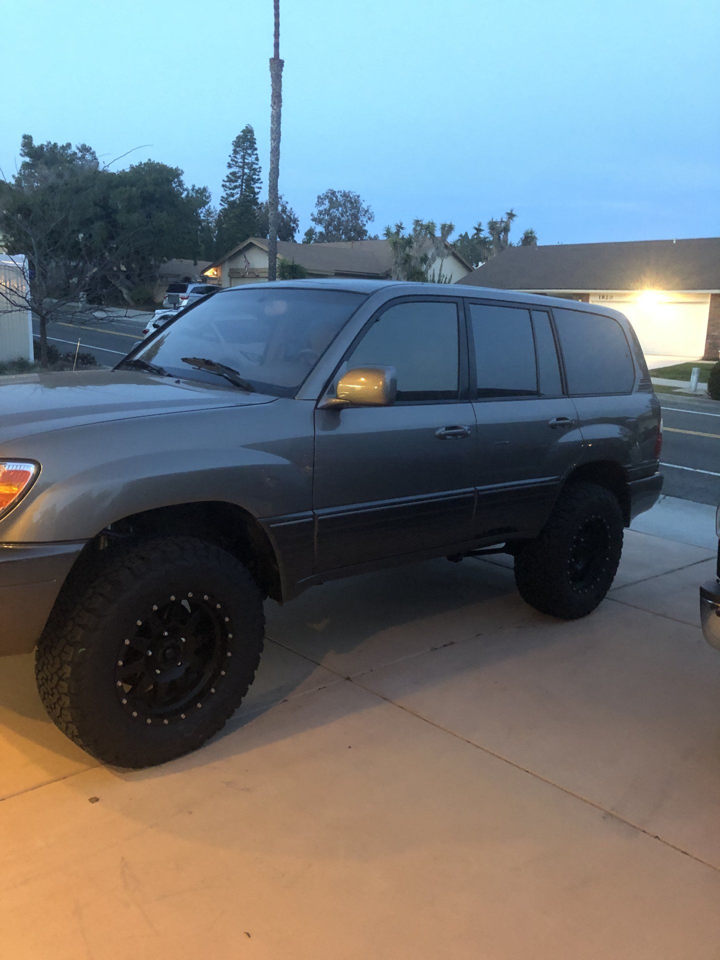

275 70 r18 . No spacers, with OME lift there was only slight rubbing at full lock till I took care of the pinch weld then did a body lift for good measure. In the pic truck has OME lift , 1 inch body lift , and is fully loaded for a 3 week Colorado/Utah/Nevada trip.
