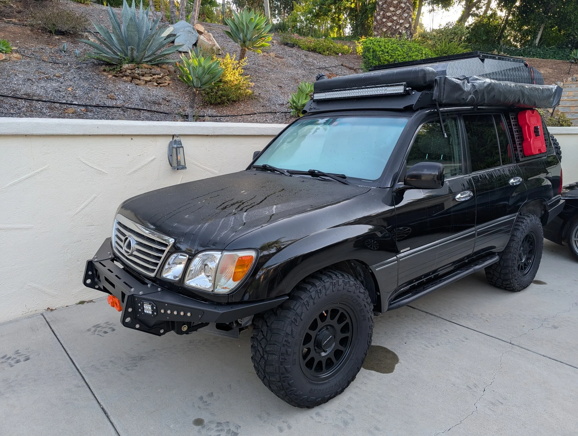

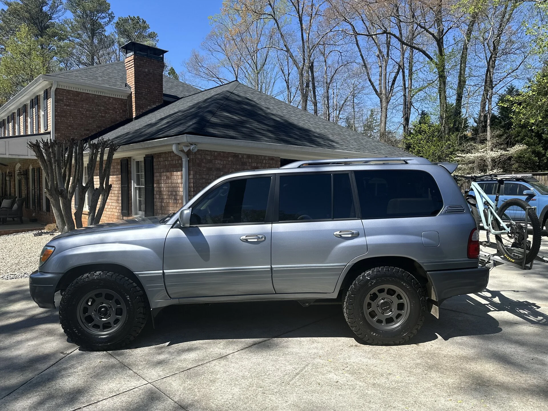

I have the same color 07 LX, this is the best looking setup I've seen for our rigs! What lift have you done and do you have any rubbing with the 285s? Thanks in advance.
Standard AHC setup. No rubbing at the 3 different AHC settings lock to lock.

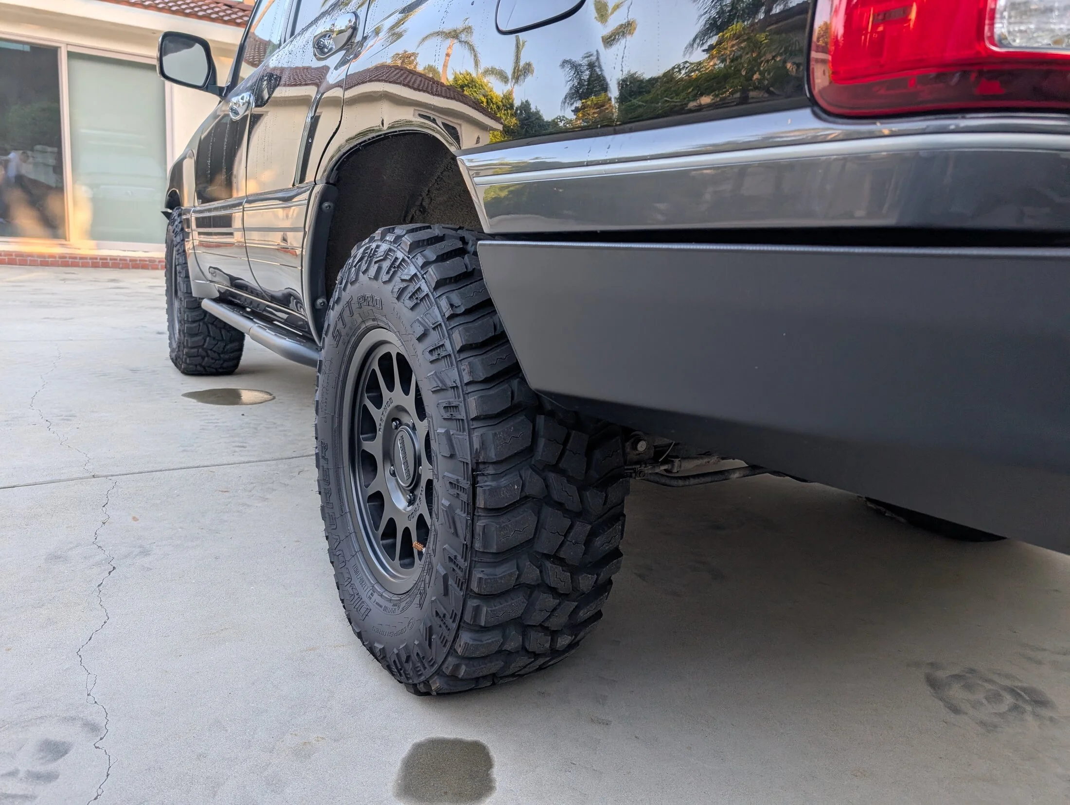

Posting pics of the 703 with Cooper STT Pro (285/70 R17)

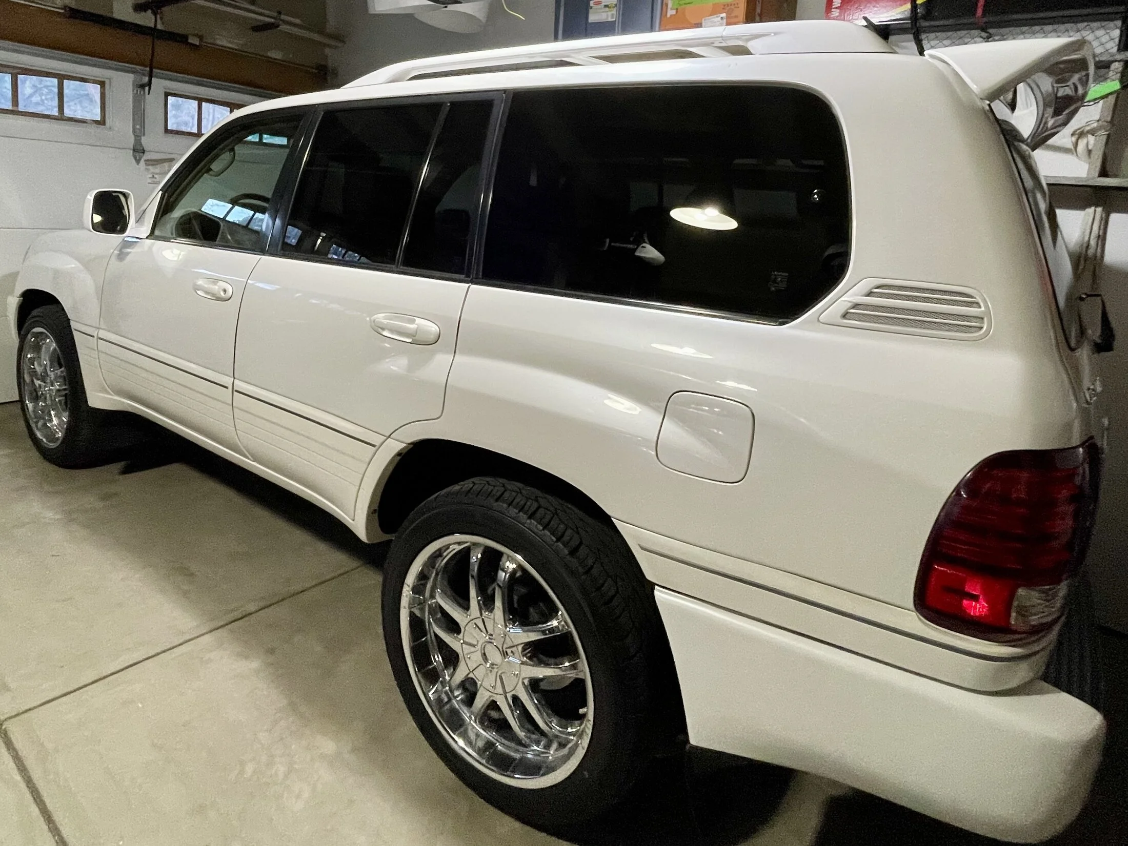

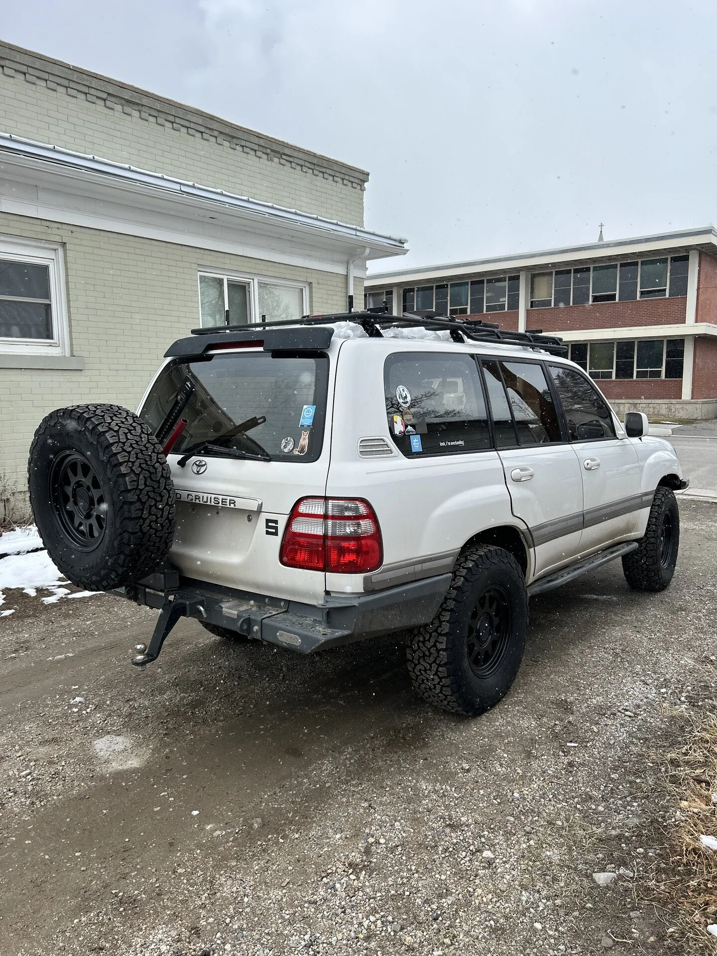

Picked up a 2006 LX470 for a new build. Single owner from NV, dealer serviced its entire life, incredibly clean at 283,000 miles. Starting with the wheels and tires (see attached pic for current set) and looking for feedback. Needs to be capable enough to go over high mountain passes but also get to/from onroad. AHC still functions, otherwise completely untouched from the factory until now.
Thinking of going with K03's at 285/75/17's with the Method 316 +25mm offset. Any concerns with that tire size and rim for fitment, AHC low, and the use case?

I have these exact wheels and same size tire but in KO2 on my Land Cruiser with zero fitment issues and I love them. I did hammer the pinch weld prior to installing.

+25 offset is perfect. Overall the method wheel spec you want should work w/o major issues. Any update on your build?

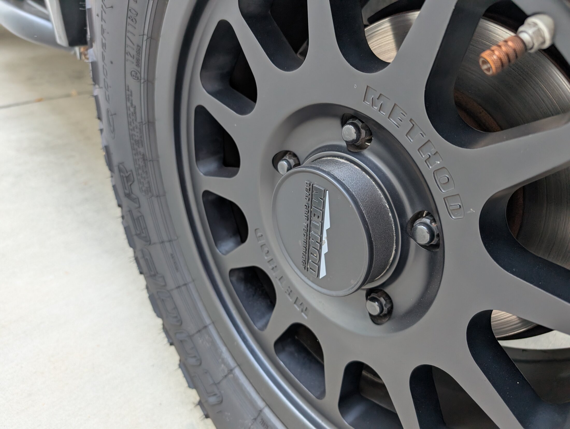

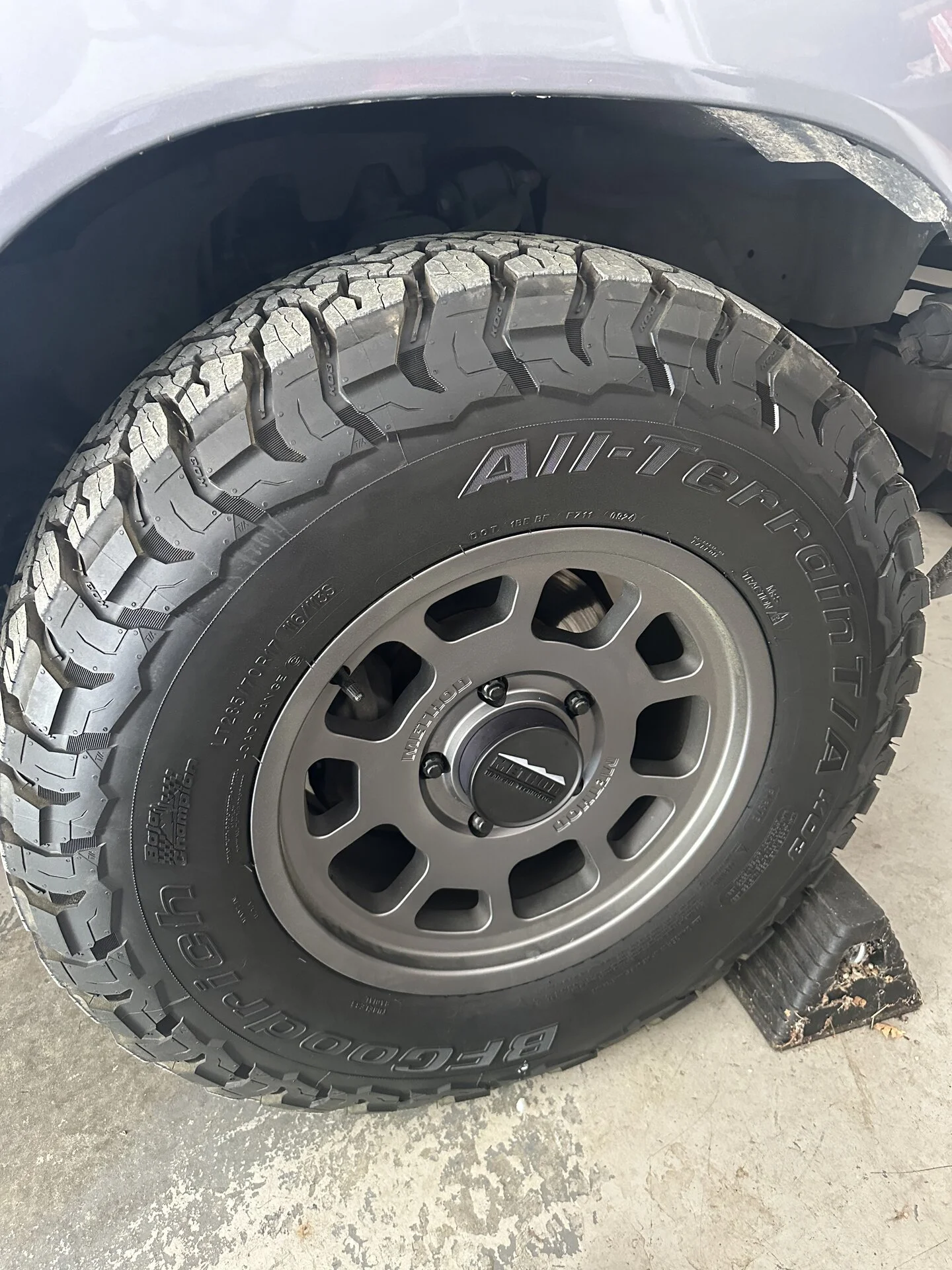

Method 314 17x7.5 +25 Offset

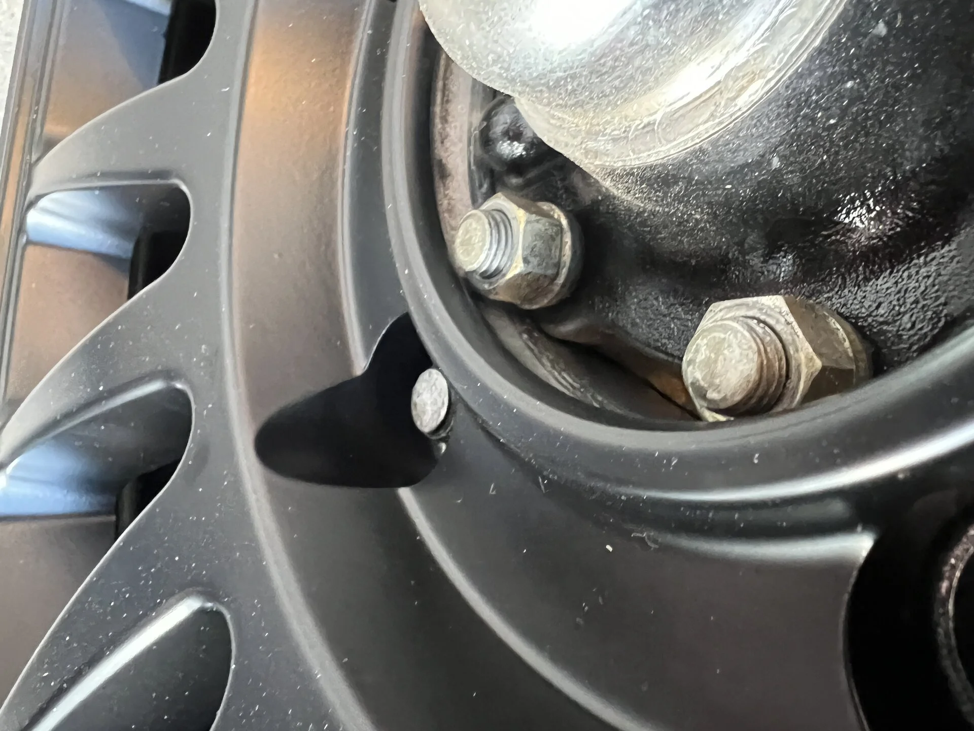

Looking to get this wheel as a spare, does it clear the front hub? I look at the center bore and it’s like rolled
The Method 314 clears the front hub just fine.

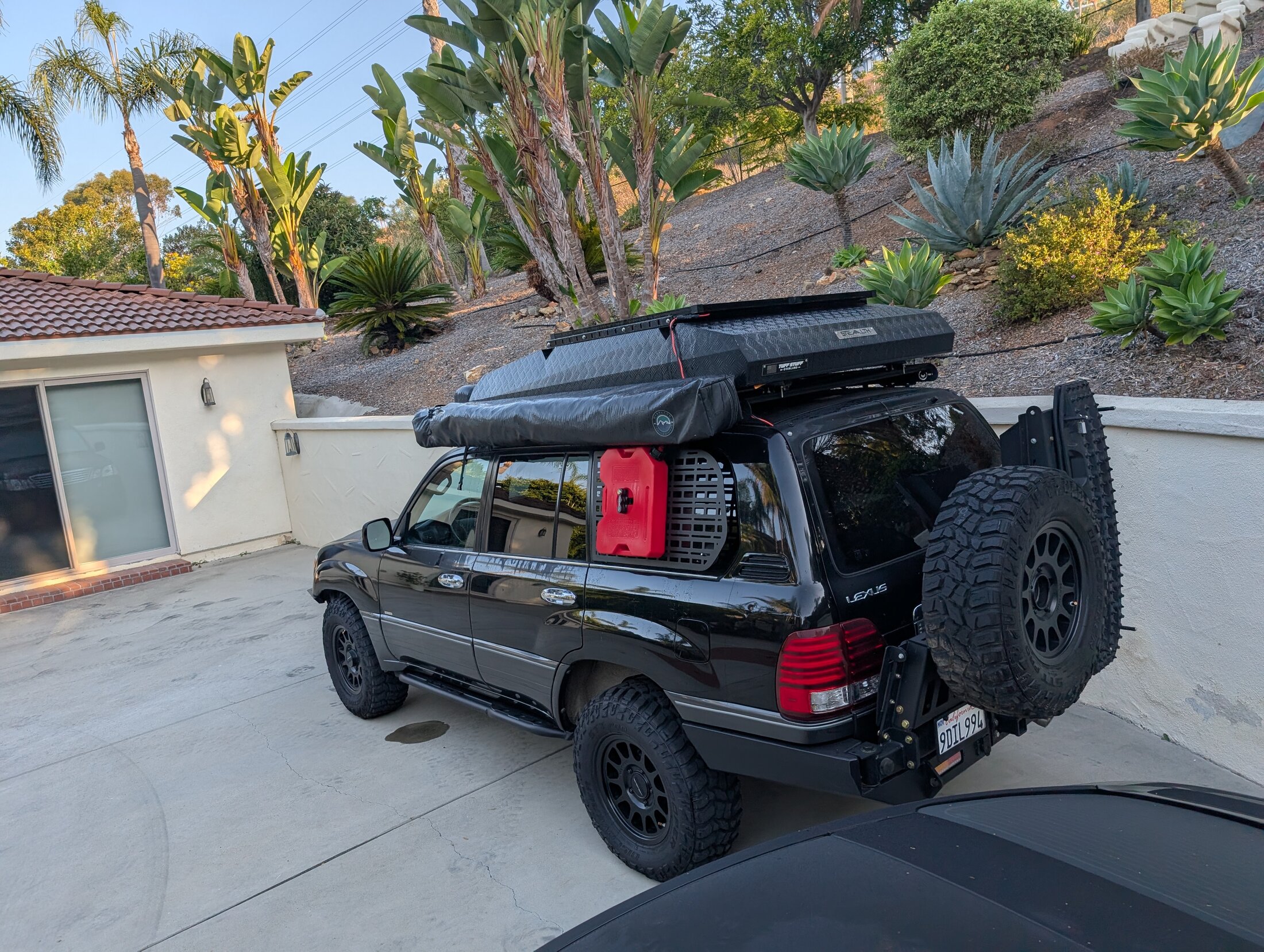

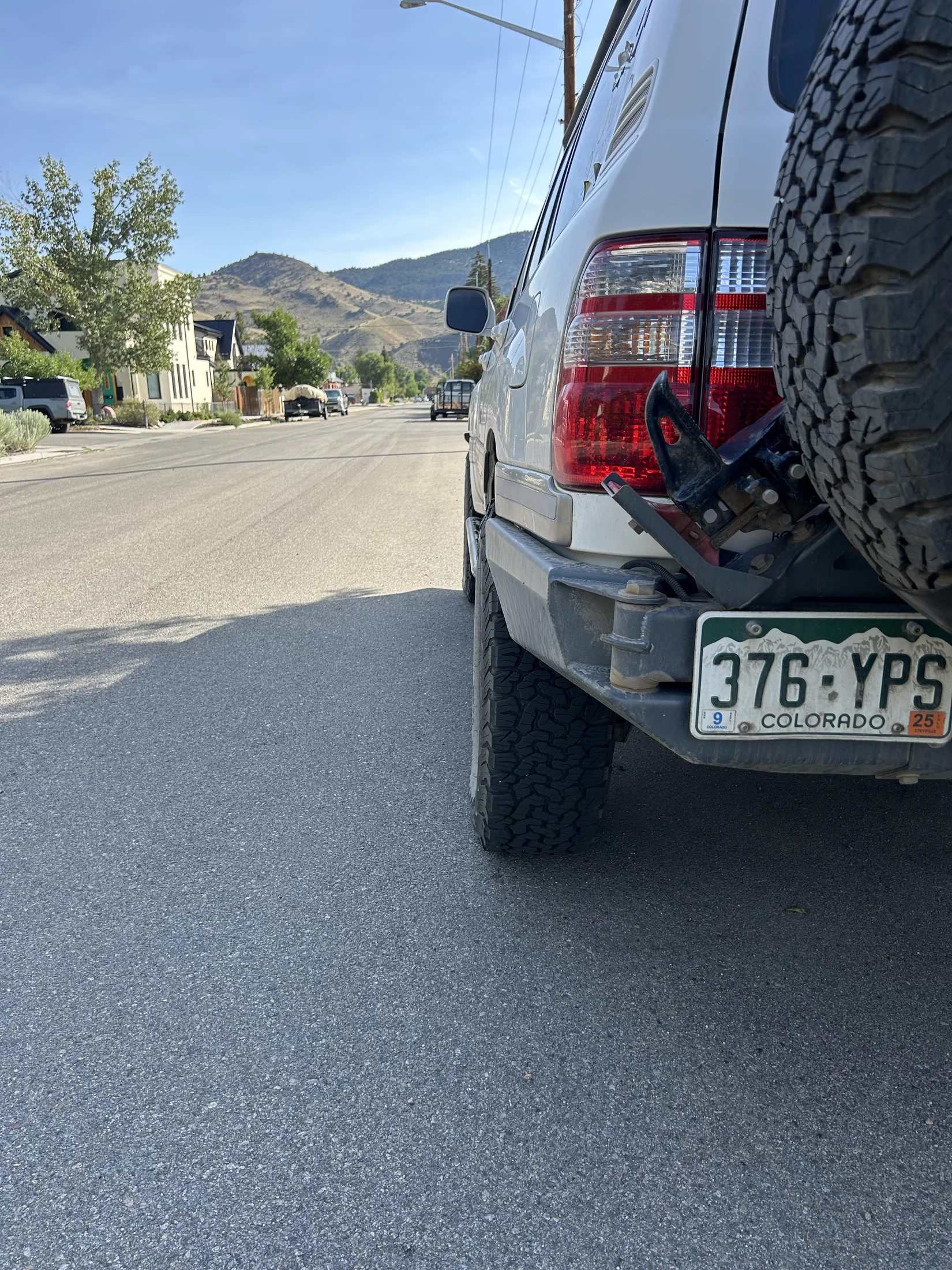

Method 316 17x8 +25 offset with 285/75r17 KO2s. Absolutely perfect stance IMHO, zero rubbing so far but we’ll see offroad (already did the pinch weld mod). Friend with a 3D printer working on a spacer for the front caps from the file posted earlier in this thread, but honestly wouldn’t mind painting the grease caps and running it as is.
do you happen to have any photos of how much these poke? I'm eyeing these wheels hard to pair with 285/70/17 KO2s. I was hoping to find a wheel with +35 offset but maybe +25 works because this wheel in on 17x8

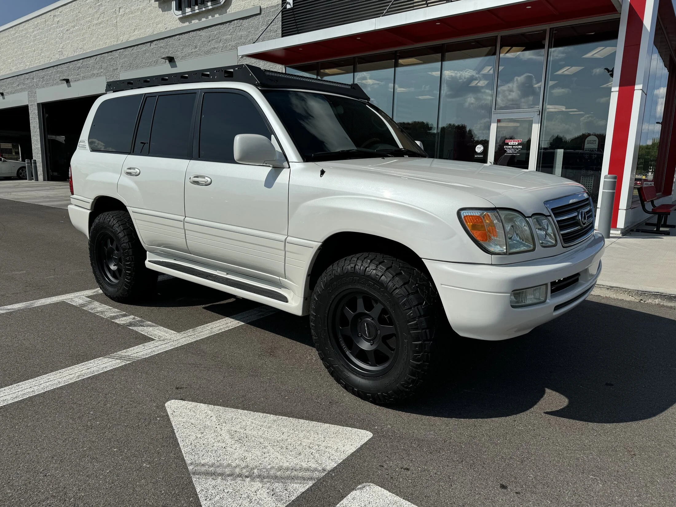

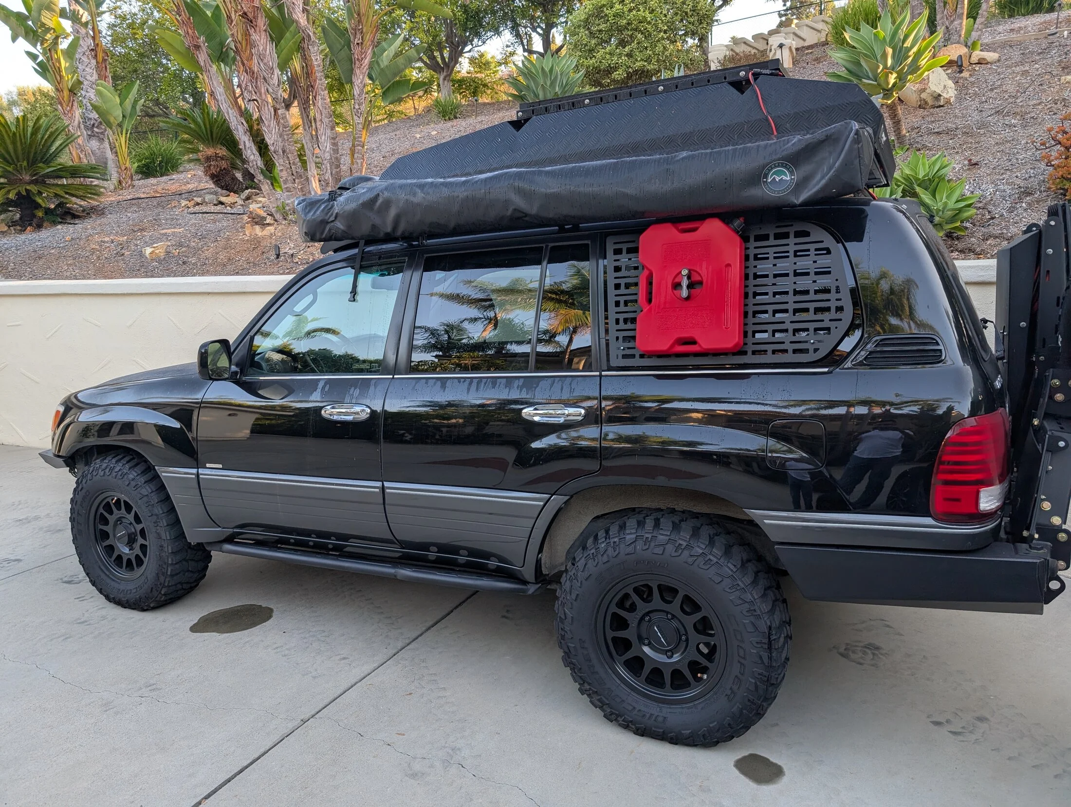

Method 705s, 17X8, 35mm offset. 285/70R17 K03s. I painted the hub dust caps black initially but ended up using cryptyk's 3d file to get a center cap extension built via Shapeways. View attachment 3596732View attachment 3596733View attachment 3596734
Oddly Method's website says the 705s don't fit a 100 series. But they clearly offer the 5x150 bolt pattern. I am definitely eyeing these and the 316s but those are a +25 offset and +35 seems more ideal to me. Do you have any side profile pictures of the poke on these?

Sorry for the delay! I don’t have any but can try and snap some. They are right at the fender, no bro-dozer look at all. With the 285/75r17 I did have the do the pinch weld mod but otherwise they clear. Perfect offset IMO.
