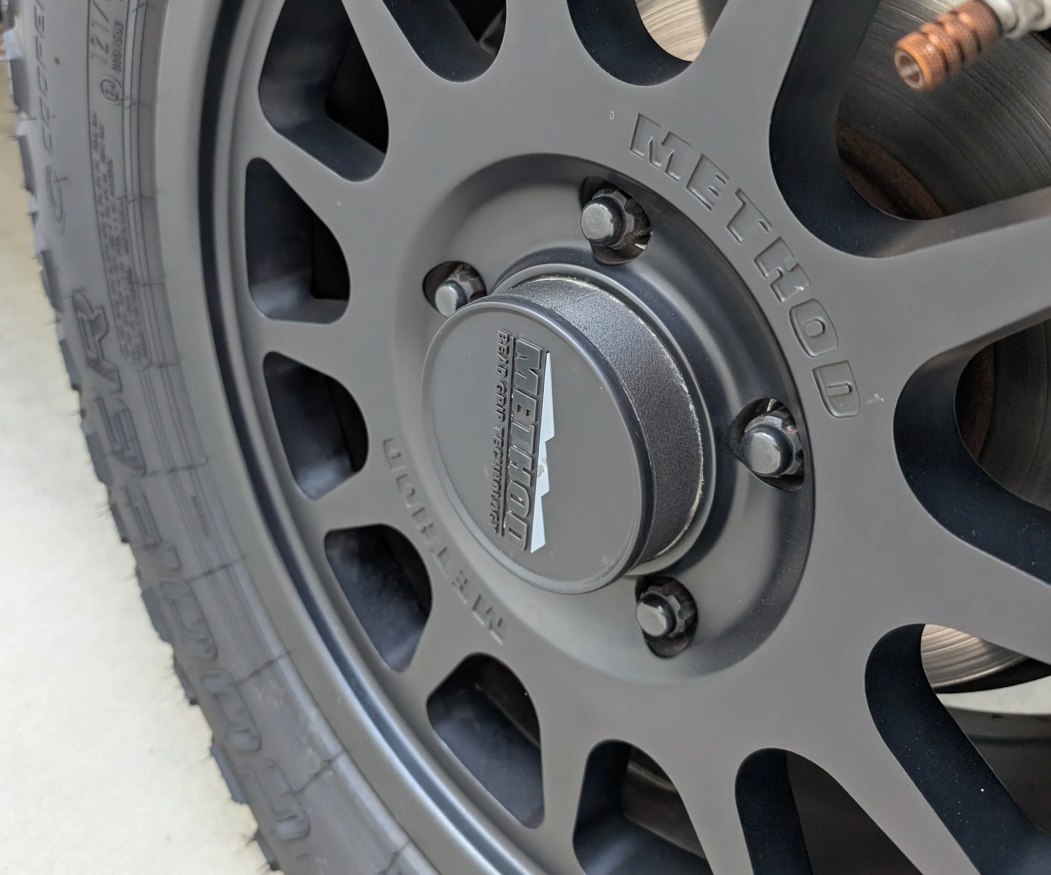

The best way to know if these will fit on your Method Wheels is to measure the stock center cap. If it looks like this, it should work perfectly:

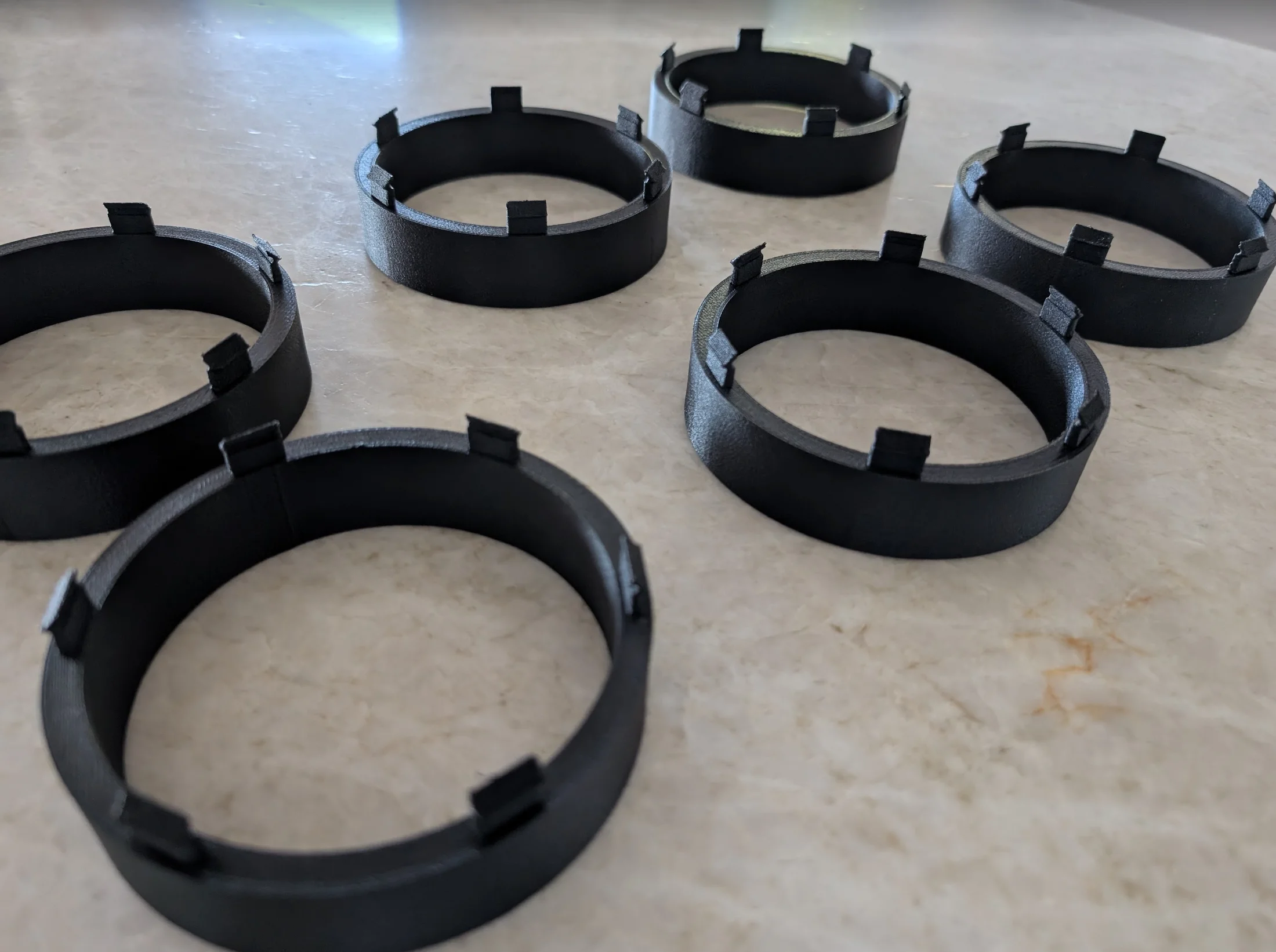

I can print these in two different materials: NylonX and PETG:
NylonX - $50 + shipping for a pair
NylonX is a matte black nylon material with shards of embedded carbon fiber. This makes it more durable and also gives it a little bit of texture on the surface. Nylon is temperature resistant, UV resistant, and chemically resistant. I definitely prefer this material and it's what I have on my own truck. The material is also more expensive and harder to print, so they cost a little more.
PETG - $30 + shipping for a pair

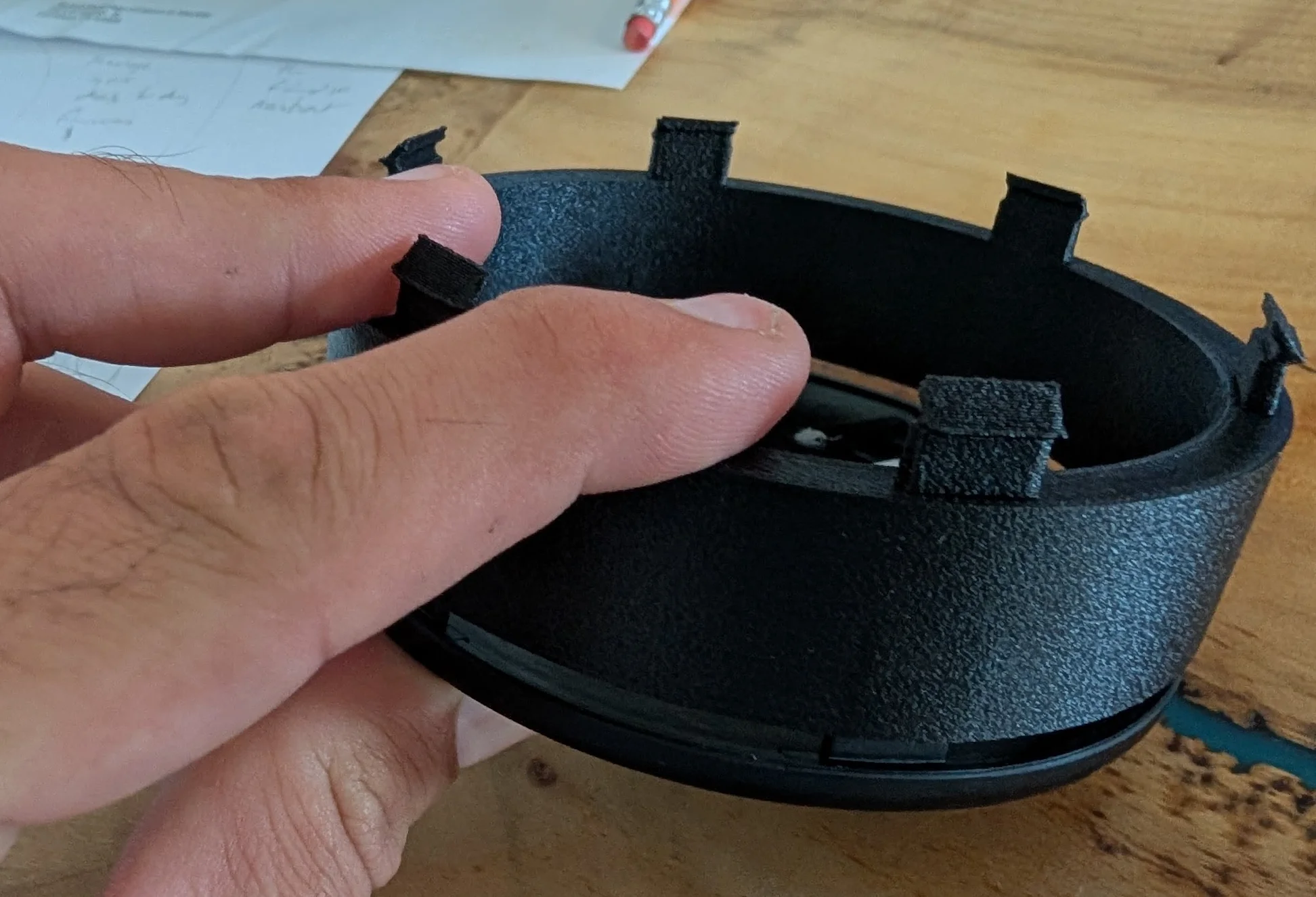

Start by lining up the center cap with the extension holes like this:
Now pick it up and carefully push each tab into the corresponding slot. Just the tip until it clicks. Don't push them all the way in yet.

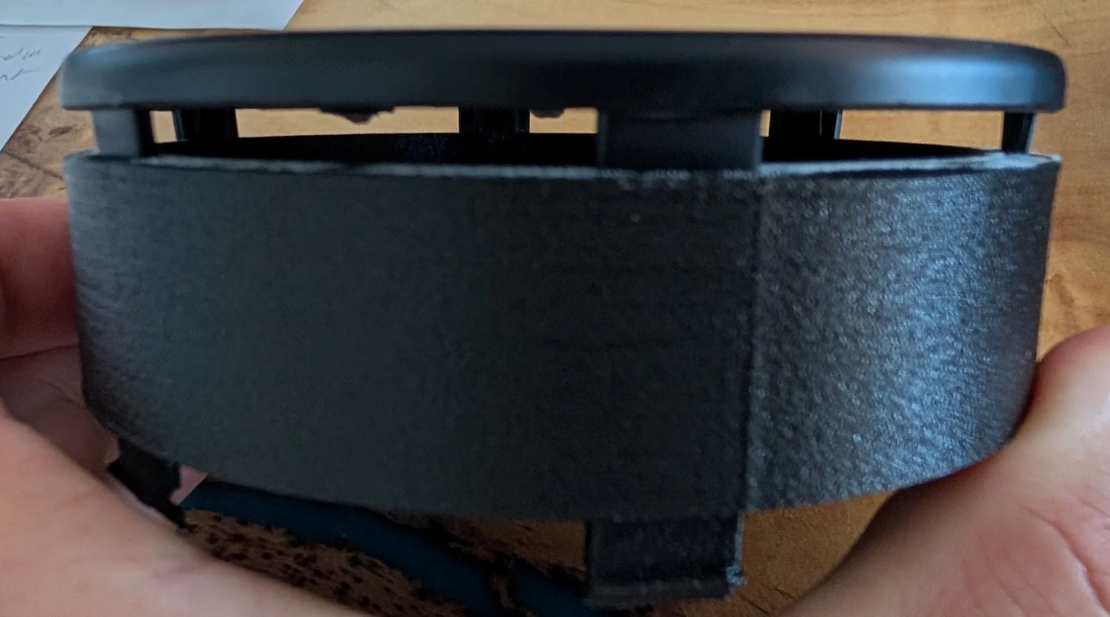

Now you can start pushing them in one-at-a-time. They're supposed to fit tightly. I don't want anyone losing a center cap while off-roading:

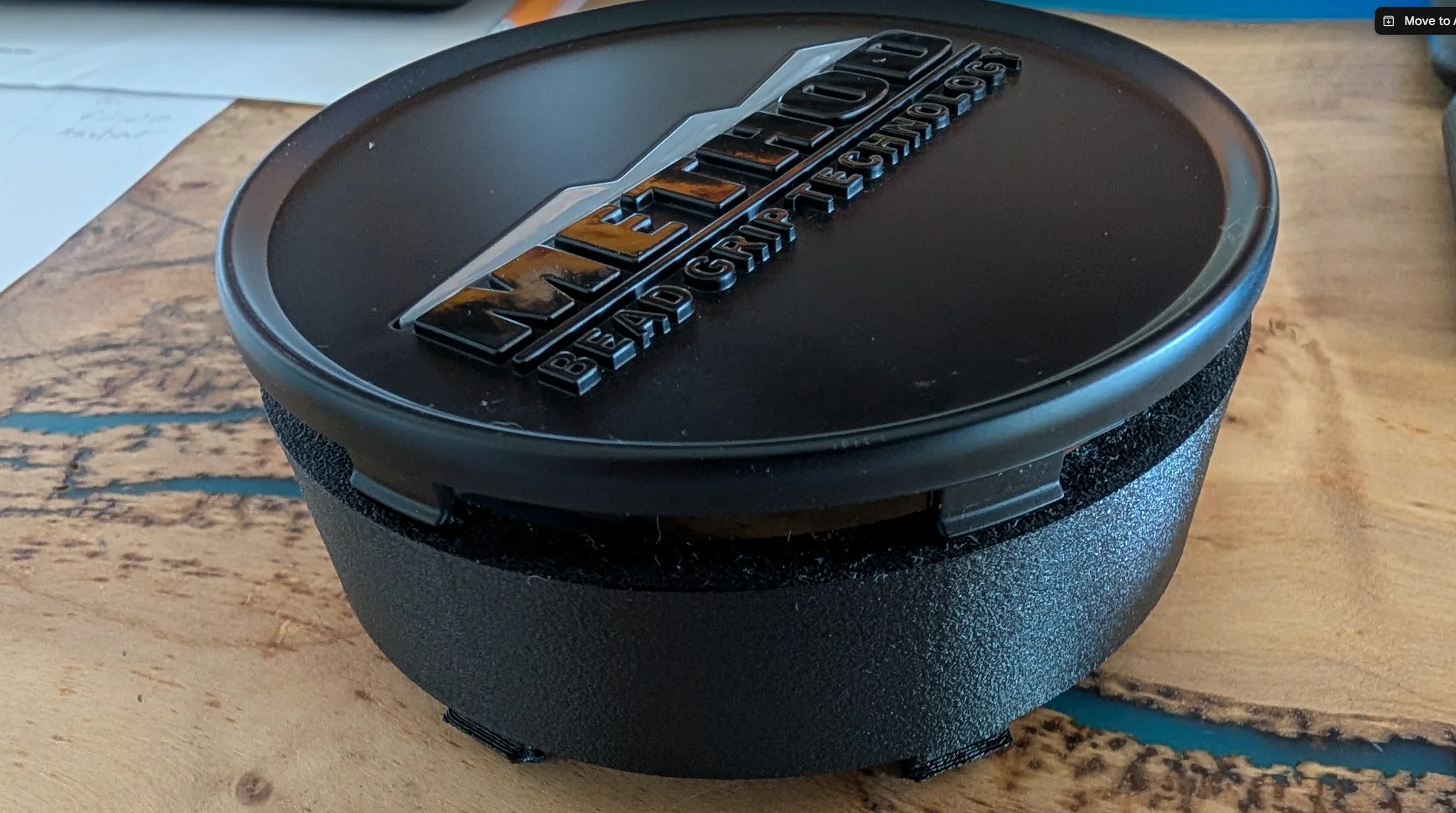

Once they're all pushed in and there's no gap between the cap and the extension, you can snap them onto the wheels. This is the most important part:
MAKE SURE THE TABS ARE LINED UP BETWEEN THE NUTS ON THE HUB
If the tabs hit the nuts on the hub, they will snap off. Make sure the tabs are BETWEEN the hub nuts. Then, just push them in and they'll snap securely.

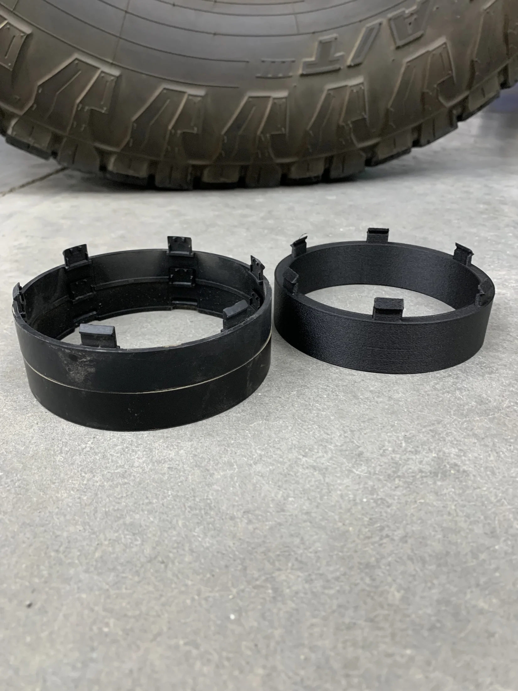

Thanks cryptyk.
These extensions fit great, perfect amount of tightness and beef.
Compare to Method #ext107

I need a set of these. I keep losing the Method extensions off my front wheels. Let me know how to proceed.
Happy to print a set. Just let me know what type you want (most people go with NylonX Carbon Fiber) and DM me your mailing address!

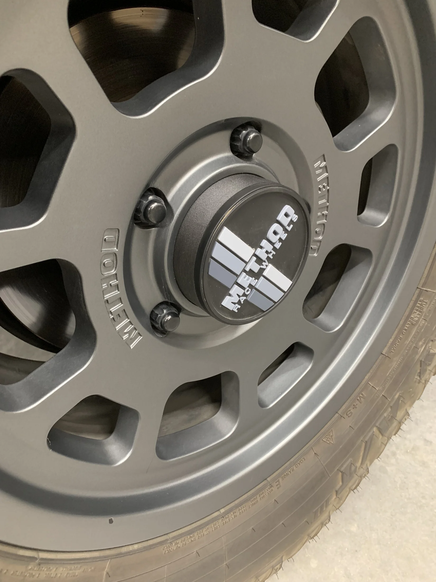

@cryptyk Thank you so much for getting me a set of these so quickly! Here's what Method 707s, in matte black, with +25 offset, and 285/75r18s look like with the extended center caps. On the 707's the extension makes the cap completely flush with the inner lip. I was a little unsure if these would drastically enhance the look of the 707s however after putting them on this morning I can say they were definitely the correct call. It may not come through in the photos but they really make the wheels look complete and tie them into the truck. I included a couple before photos so anyone that wants to, can compare and contrast.
