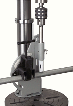

My advice= borrow or buy a GOOD notcher. Not one of those Chinese knock-off copies of the Ol Joint Jigger.
If you can swing the dough- go for the Notch Master from JD2. I've used the piss out of mine and it shows none of the slop lesser ones will show. If you're part of a club, split the cost up several ways. It really should be a one-time purchase.

This is the notcher I use. They are between $40-55 at Harbor freight. I don't even put it in the drill press, just use a 1/2" drill. A little easier to handle big sticks of tube that way. If you do buy this one, spray it down with brake cleaner first to get the packing oil off of it. Then lube it and use it...
