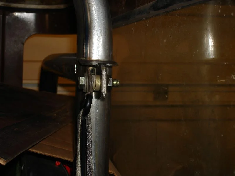

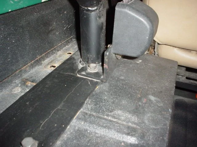

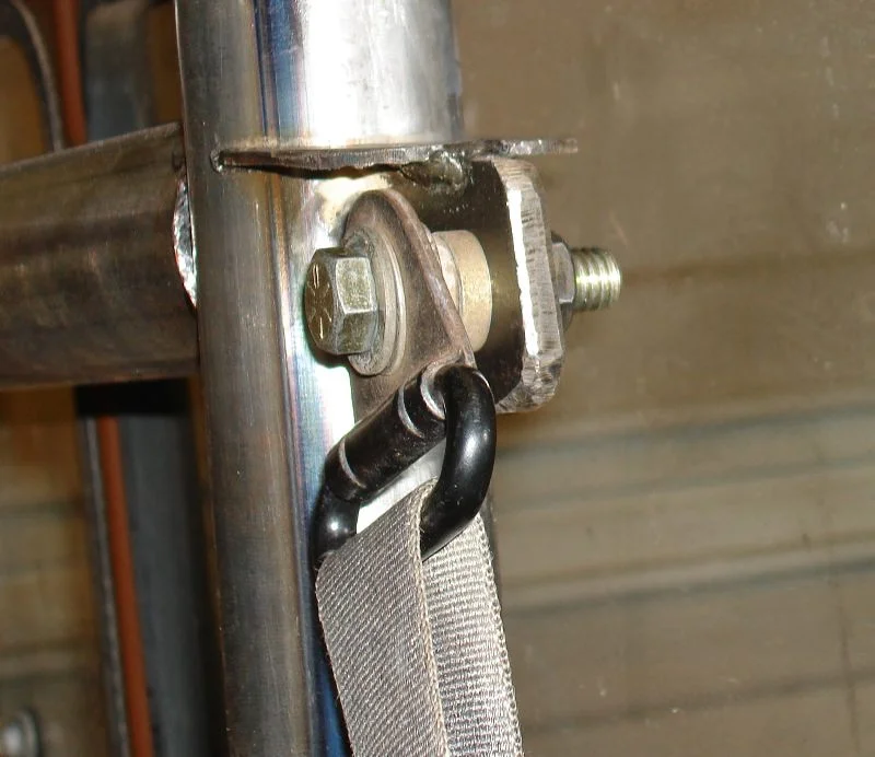

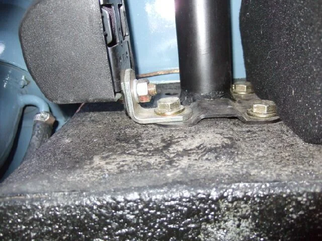

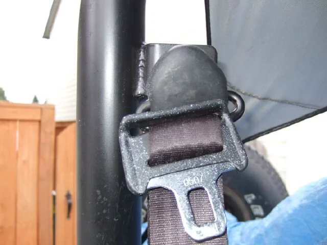

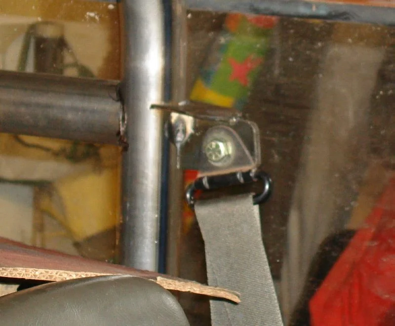

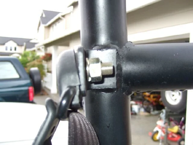

Here's mine. It is a Metal Tech OEM repro roll bar. A simple "L" bracket welded to the roll bar holds the top part of the seat belt. Another "L" bracket holds the seat belt roller (?) to the base of the roll bar. Not pictured is the other end of the seat belt that attaches to the stock location. So, basically, 2 "L" brackets holds mine on with grade 8 hardware.
The seatbelts pictured are CCoT seatbelts.
Good luck! :cheers:

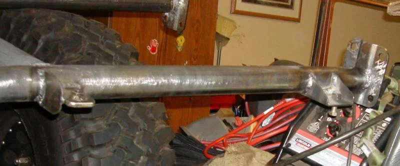

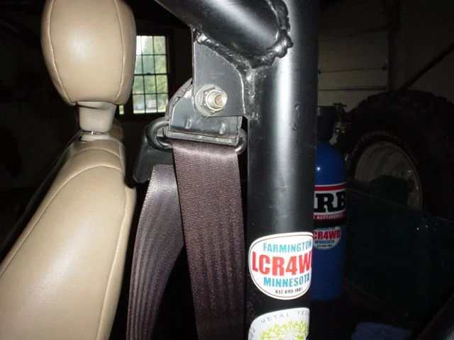

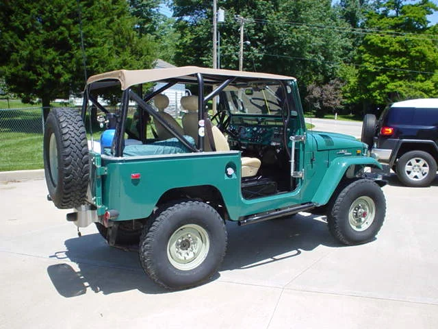

Greg, here is how Poser did mine......MetalTech family cage:beer:
Ed
