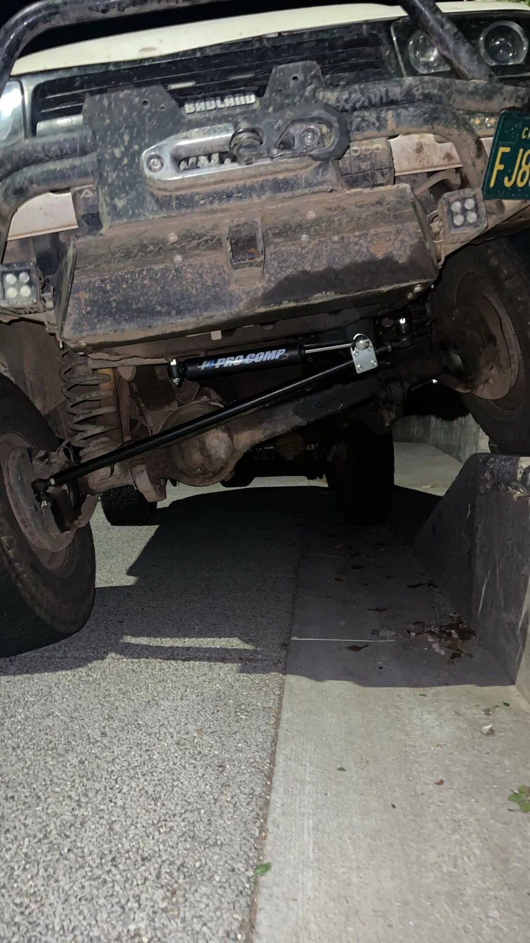

First major issue I started to deal with was the transmission. Although the A442F is seemingly bulletproof, the lead foot and adrenaline filled driving habits of a 21 year old can really test things like that. It was having issues shifting and I ended up finding out the filter was completely clogged. So I got to learn how to work on the transmission as best I could and cleaned the solenoids as well as replaced the filter and she was back together! Soon after, I found that the drag link is no match to a 35” tire dragging on a K-Rail, and ended up bending the drag link into a banana. Got a heavy duty kit from Trail Gear and threw it on and made my confidence doing my own work skyrocket!
