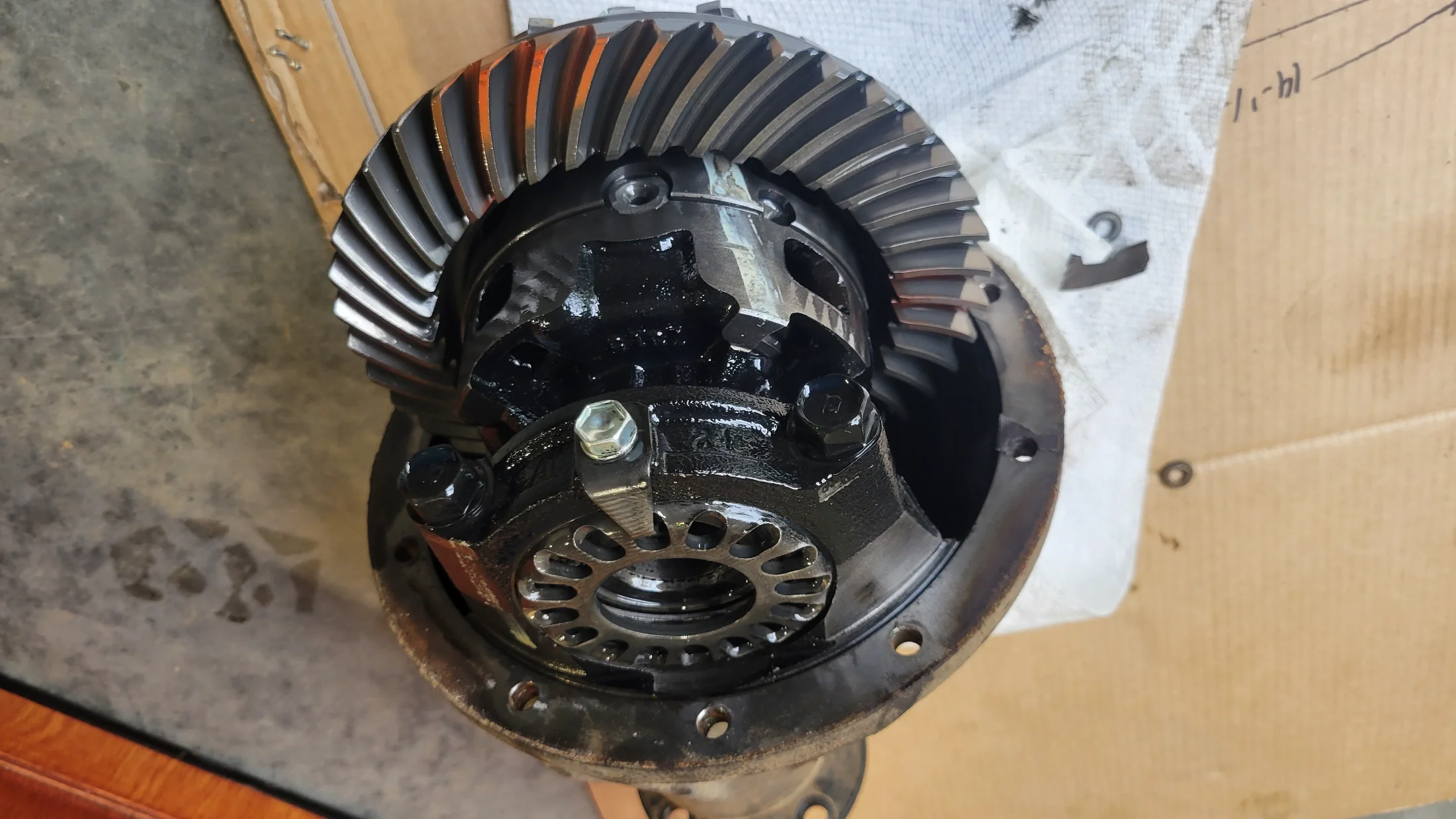

The diffs and T-cases in these rigs most definitely do not need any kind of special or expensive fluid. IMO, what's more important is the frequency of the fluid change rather than the type of fluid. After all, the diffs don't have any kind of a filter in them, just a magnet for metal parts.
My TC gets Mobil Delvac 75w90. It is a great synthetic gear oil. It's commonly used in HD trucks and it lacks a limited slip additive (and is one of the only synthetic gear oils that doesn't include it). Oh - it's cheap too. It runs very quiet in the transfer case, including in the cold.
The diffs on these rigs are even less picky. Prior to upgrading diffs on my GX, I was running cheap Valvoline conventional 80w90 in the front and rear, but changing it yearly (as I do lots of creek crossings and submerge the diffs - and there would be evidence of some water in the diffs at each yearly change).
In June I removed both differentials in order to swap them out with upgraded diffs from ECGS. Here is the OEM 3rd member with 190K on it (with 55K of those miles being mine). Perfect condition in every way, with even the OEM paint markings still being visible. The rig was used hard over my 55K, including lots of wheeling and towing.
