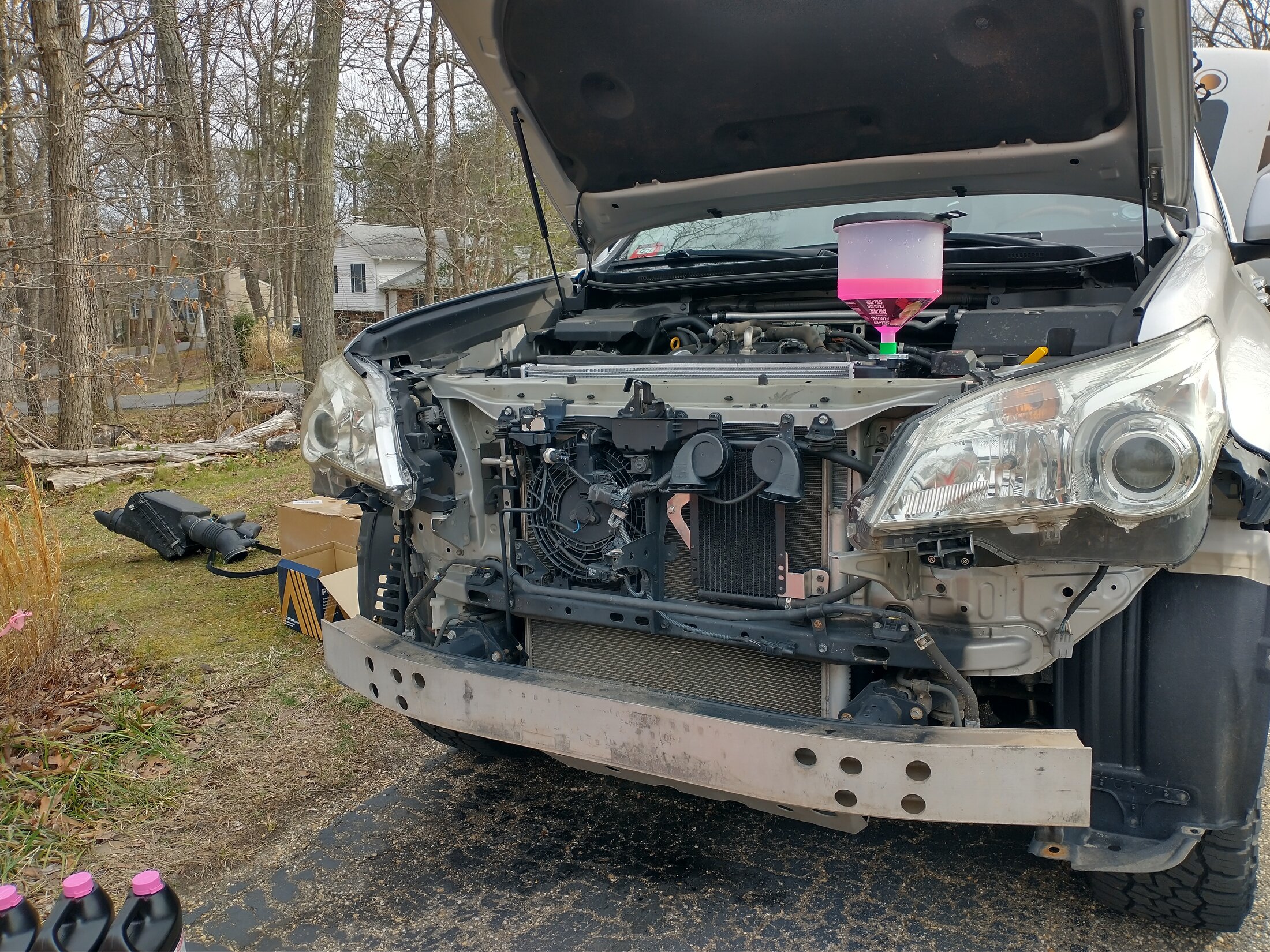

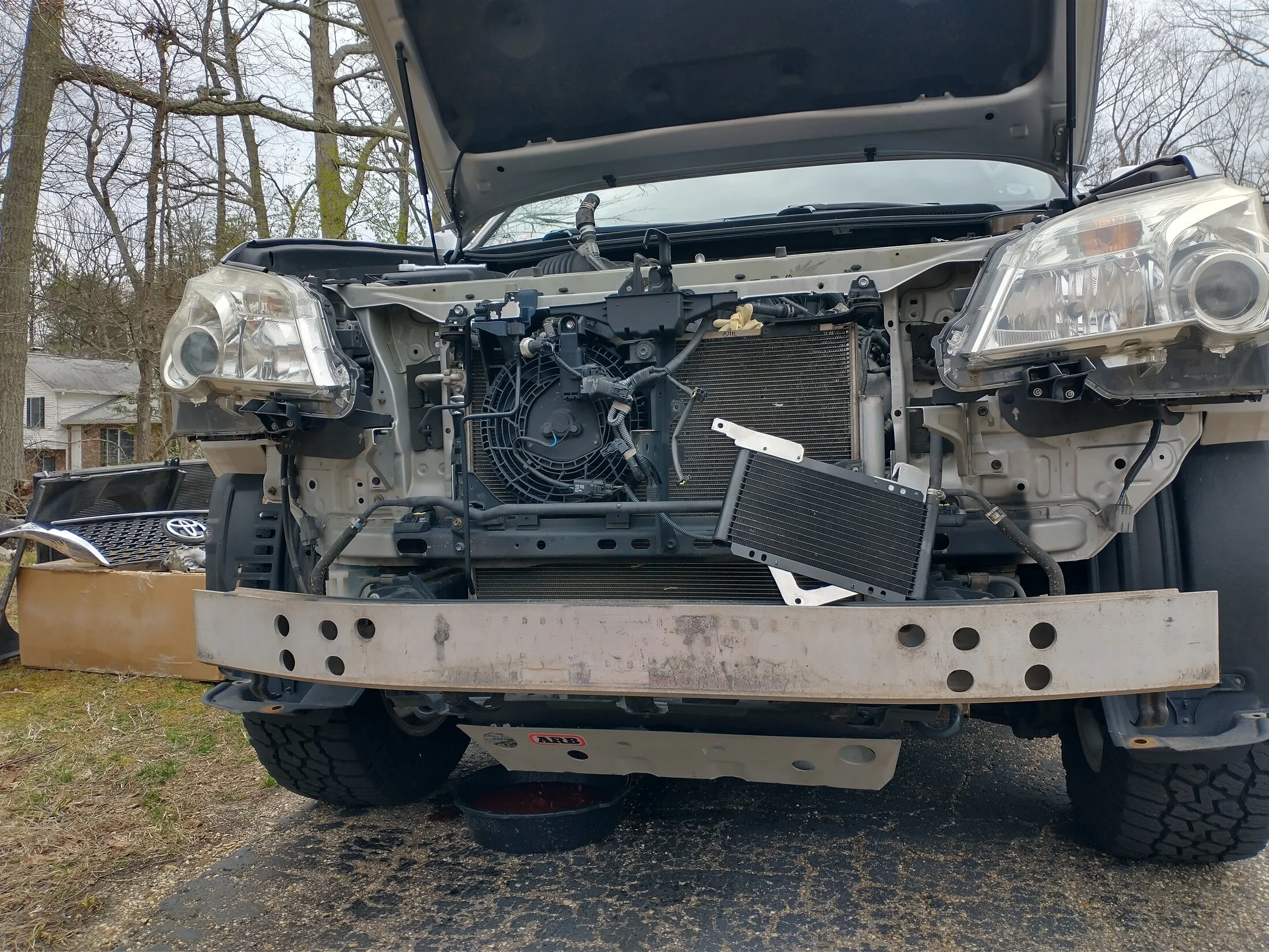

Going with the radiator removal and belt-related stuff seems like the way to do it. Everything is out of the way and the only tight spots are during the fan shroud removal and twisting the alternator past the vane pump.

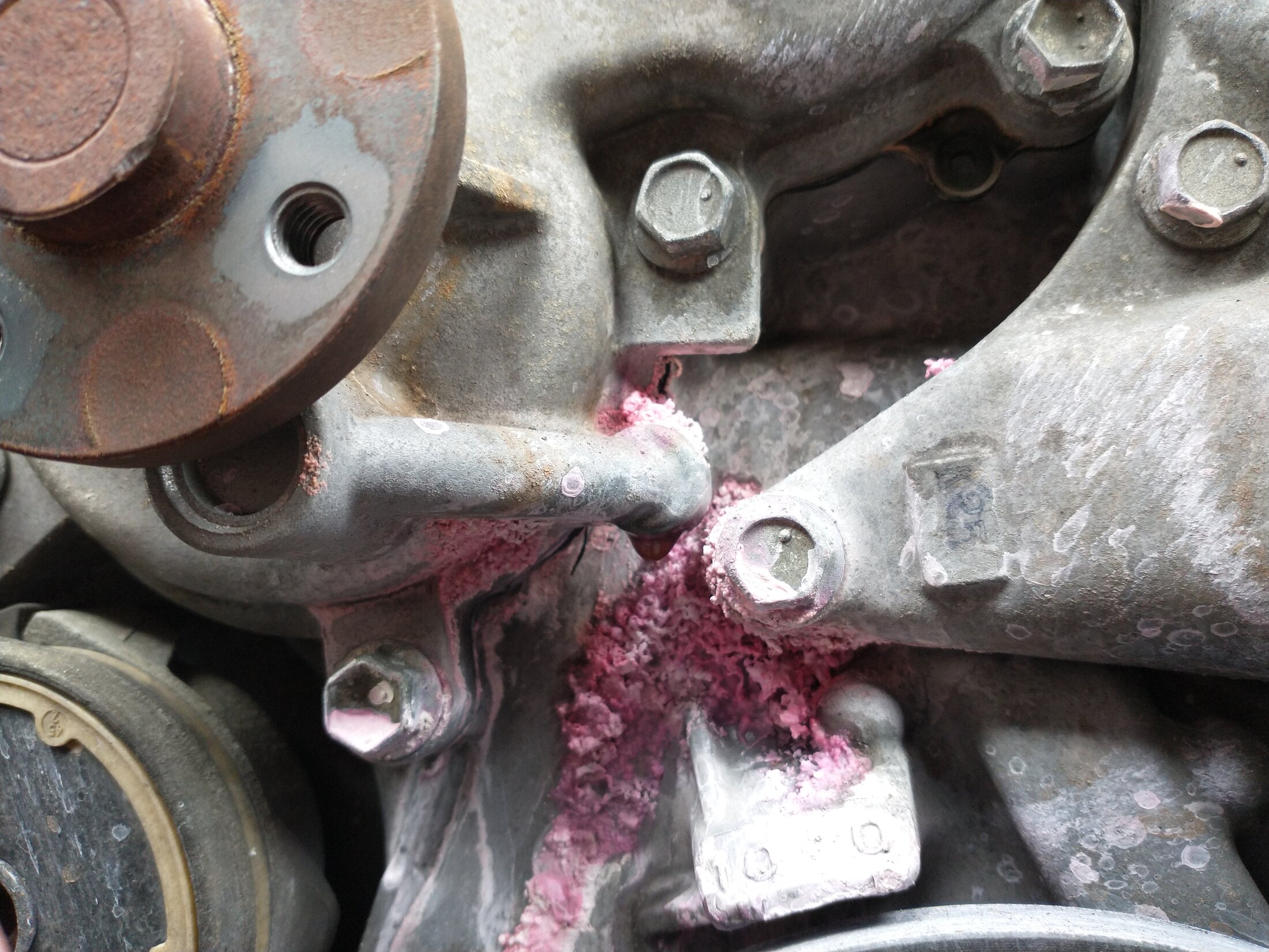

Upon removal of the water pump, I found that the gasket material had failed around the 5 o'clock position. The material on both sides of the gasket was just flaking away.

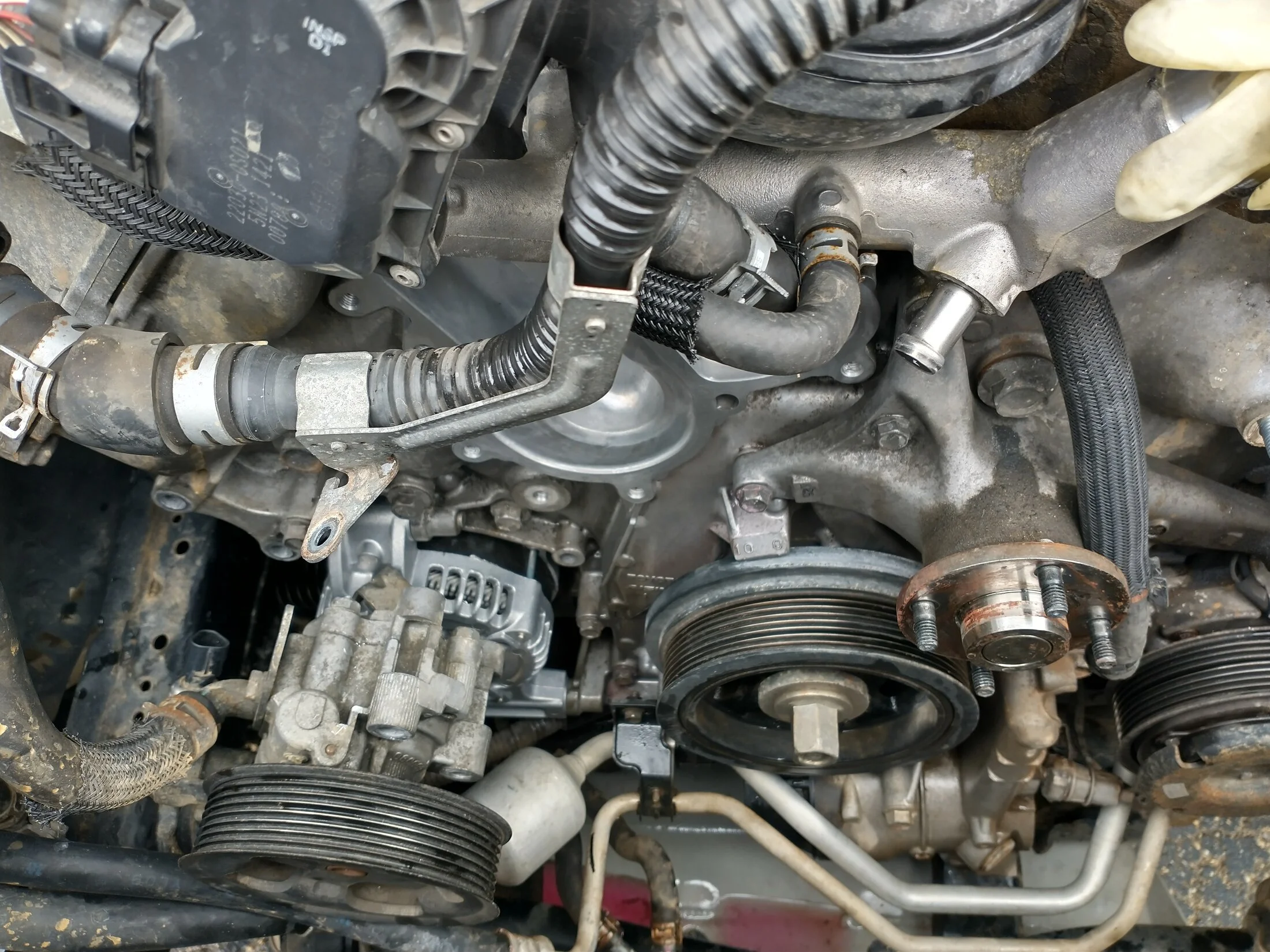

With the vane pump pulled out of the way, you can see that there really isn't much room. Having the radiator, water pump and tensioner removed really makes this easier.
