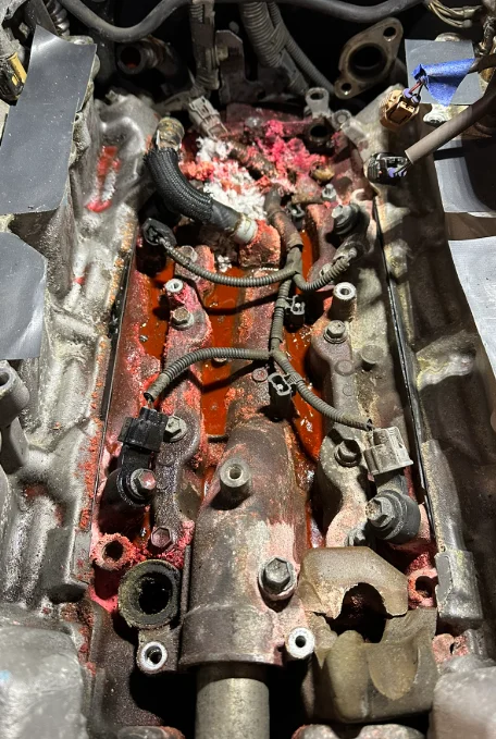

The knock sensors were very heavily encrusted with pink residue when I first dove in. This is how bad it was when I first got into the valley:
The fluffy stuff at the back seems like critter nest stuff to me but I never found evidence of chewed wires or such.

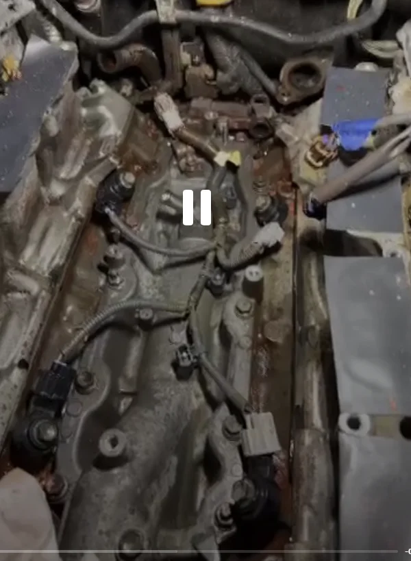

I was able to get it pretty clean before attempting reinstallation:
Sorry for the poor image, it's a snap from a video. You get the idea.
I think I'm at 1,200 or so miles since repair and the only change in level occurred during the first hundred. I blame that on the long plumbing for third row heat and time to burp. You did a nice job cleaning up!
Thanks. I just brushed on some water with Dawn (carefully) and then blew if off with compressed air. Then repeated that forever.
