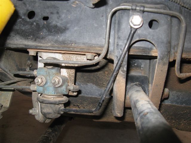

I studied the system and saw a strange stuff about it. The circuit for the front end of the truck has a T piece just under the master cylinder that gives pressure to the ABS unit for the front end, and the other exit goes all the way to the LSPV for no reason, to my understanding. I got myself two M10 brake bleeders, took the pipe that goes from the T piece to the LSPV out and blocked the exit with the bleeder, and did the same on the LSPV. The result was unbelievable! I had a truck that was now stopping just like a normal one!

Looking at your picture and reading Bear's post I am having a hard time to understand what he means.
There is one line in, and two lines out. Correct?
If he blocked one of them off, would it be the line-in one? Then would the rear wheels still be able to brake? How? Is there a separate circuit?

Yes, My LSPV is doing no proportioning at all. I have had all the parts to remove my ABS for about a year, its just not high on the list.
As for legal ramifications Im not worried because now I can stop:D

For our trucks removing or bypassing of the LSVP will give you better braking without question. My rig is part time without ABS and at speed with brakes locked (yes brakes locked with 35's;)) my truck slides straight for the most part. Trucks weight is ~6500lbs and very close to equal front to rear. The balance could contribute in achieving the braking results above.:meh:
Hey Phil, is that the full up position? I have a 3 inch lift on my 97 and have been fighting ( like everyone) with brakes, full up and give the rod a bend?
