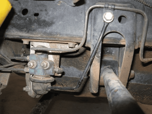

This is what we are talking about right?
Yup, that.
My rod is currently contacting the control arm and it does droop some with the axle as it’s still connected with the pumpkin.
One of these days, I may pull the LSPV, but braking still seems adequate for now.
Yup, that.

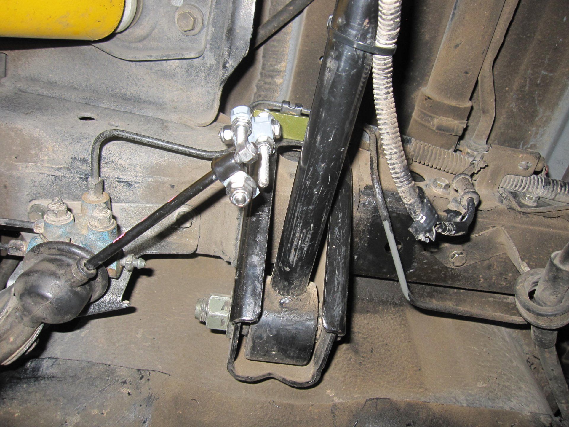

Here's mine - adjustable fixed position, no longer Load Sensing at all.
Made from a couple of 1/4"-20 x 4" stainless fully threaded bolts and other bits & pieces.
Now I suppose I'll have to get that bleeder pressure gauge setup to adjust it to some specific front/back ratio.
9 months down the road...
After installing the threaded rod adjustable fixed position mod to my LSPV(see above) - apparently, I proportioned way too much to the rear brakes - and wore them down to metal (on one side, a little pad left on the other) - so - rear rotors & pads replaced & made a tentative LSPV adjustment towards the front. Braking seemed fine - I couldn't feel any different for the lesser front end braking.
A second part of the story came in when I went out to break-in the new pads - I took the IR gun thermometer along for the ride so I could know how hot the rotors were getting...
And noticed a consistent +30 to 50 F hotter on the side that wore out(rear), while the fronts were very even - so - I suppose there is something hanging up the caliper action on the side that did not wear out - reducing its contribution (& wear rate).
The lesson here is that an IR thermometer is a pretty good tool for checking up on your brake performance - for even proportion - side to side, front to back.
