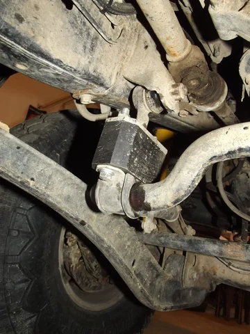

Next on the list was the suspension. I wanted to have it leveled and to upgrade to 35" tires so I ended up with a +4" OME kit along with OME steering damper, front and rear adjustable panhard rods, double cv front and rear drive shafts, OME adjustable rear upper control arms and I have yet to make front caster correction plates. I enjoy fabricating stuff my way so I bought a chunk of polyamide and built the bump stop spacers and sway bar spacers.

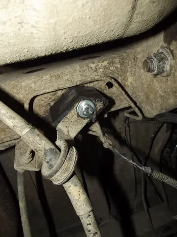

The brake lines also needed some 5 cm / 2" extensions and after some research I found longer OEM replacements.
Here are the part numbers:
Front right: 90947-02447
Front left and rear axle (it works for both) 90947-02589 / 96940-34305

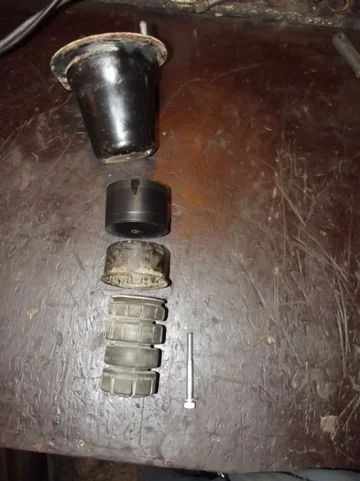

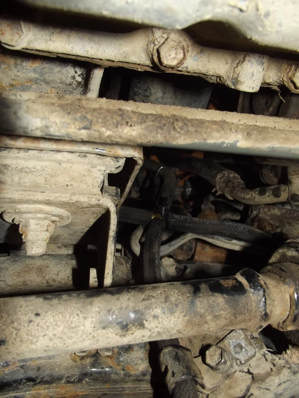

For the bump stop spacers, I noticed that all the suspension kits available on the market have spacers for the ones inside the springs for the front end but for the rear end they have spacers for the bump stops next to the springs. I made the spacers for both axles for the bump stops inside the springs, since I thought it would be more sensible to have the same bump stops lowered, and in the future, I plan on also lowering the ones next to those by the same amount (~2"). I also made drain channels in the spacers. I’ve noticed upon removal of the original bump stops that there is a hell of a lot of dirt sitting on top of them with no way out but there are however drain holes in the chassis.

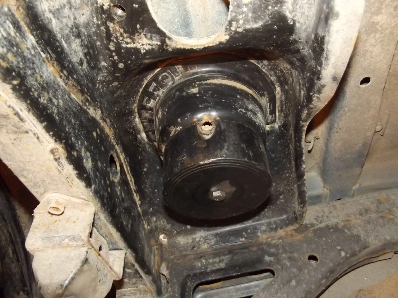

The front bump stop support did have drain holes, but they were too small and jammed with rocks and dirt, and the support was full of water. I have drilled bigger holes.
In the rear the holes are already big enough but have nowhere to drain :idea:

I also did a hand-brake cable drop mount:

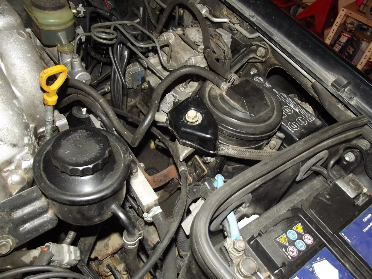

Today I installed a nice steering column bearing. I saw that several people said that the bearing was making noises when turning the wheel, I didn't want that to happen so I took some time to remove the small black panel that the bearing gets bolted on to study the problem. I saw that the bearing could not properly sit against the panel because the center hole through which it is supposed to pass and swivel is not large enough. So I enlarged it, grinded away some extra metal of the bearing housing (top and bottom) and there it was, sitting nicely against the panel. Once installed I applied grease onto the two studs on the flex plate (because the shaft is not moving anymore now, the studs may touch the other side when turning and it may squeak). The steering is now stiffer, feels a lot better and is super quite.

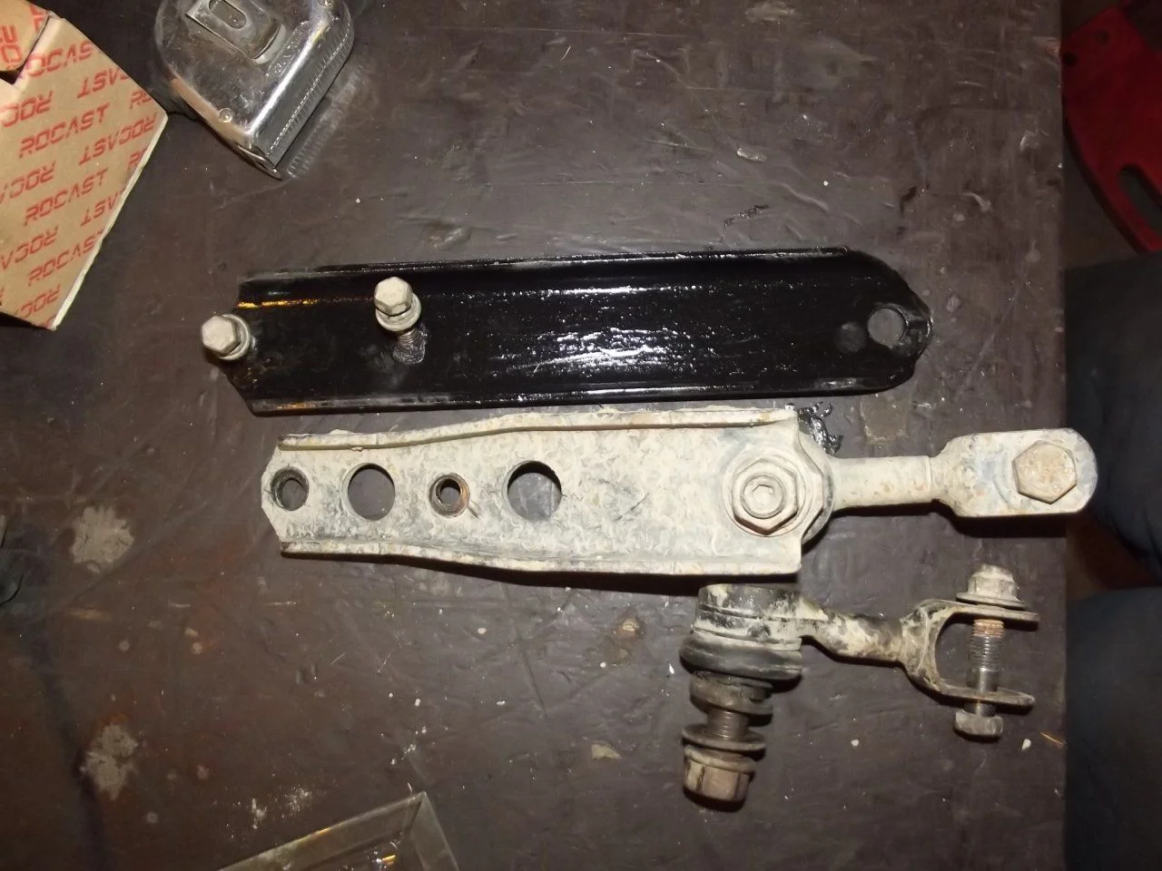

Eventually I builded up my own caster correction plates after doing some sketcing and measurements, and I also bought a pair of nice adjustable rear upper control arms just to keep the rear driveshaft happy and to have the lift kit completed. Afte all that work the truck finally drove great both on road and off-road, no more grinding noises, no more wobbly steering.
