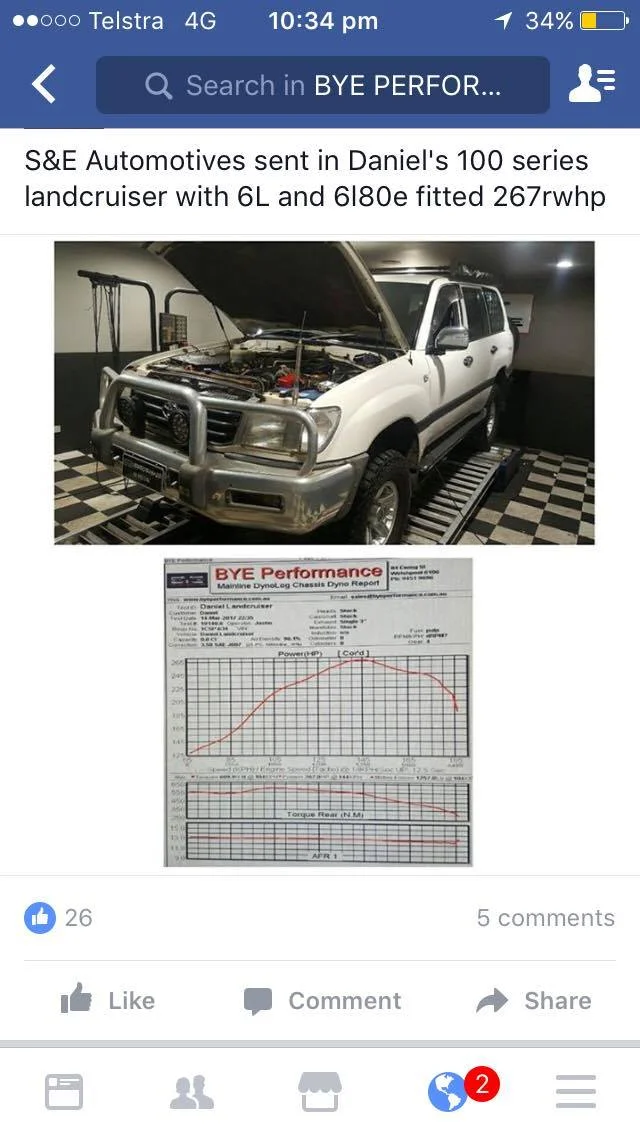

While you might get 2x as much power as the old 1FZ, do not expect huge power. Here is a dyno from a guy with a 6L and newer 6 speed auto that only made 267rwhp. Stock 1FZ makes about 135awhp, and almost 200awhp with the TRD SC. A good turbo setup will make 350awhp. It is a lot of expense to go through to get 267rwhp.

This was just an Aussie truck, a 105, the guy took the 1FZ out and spend close to $20k Aus, and then found out it had less power than his buddies truck with a turbo. So they took it to the dyno and the Toyota drivetrain must just soak up a lot of power because that 400+hp V8 only put down 267rwhp. I thought it was our transmissions sucking all the power, but must be the transfercase? Either way, just throwing it out there.

Without more info regarding what they did with intake, exhaust, MAF calibration, VVE calibration, fuel system... lots of stuff.. I'm not willing to give up on my swap just yet.
