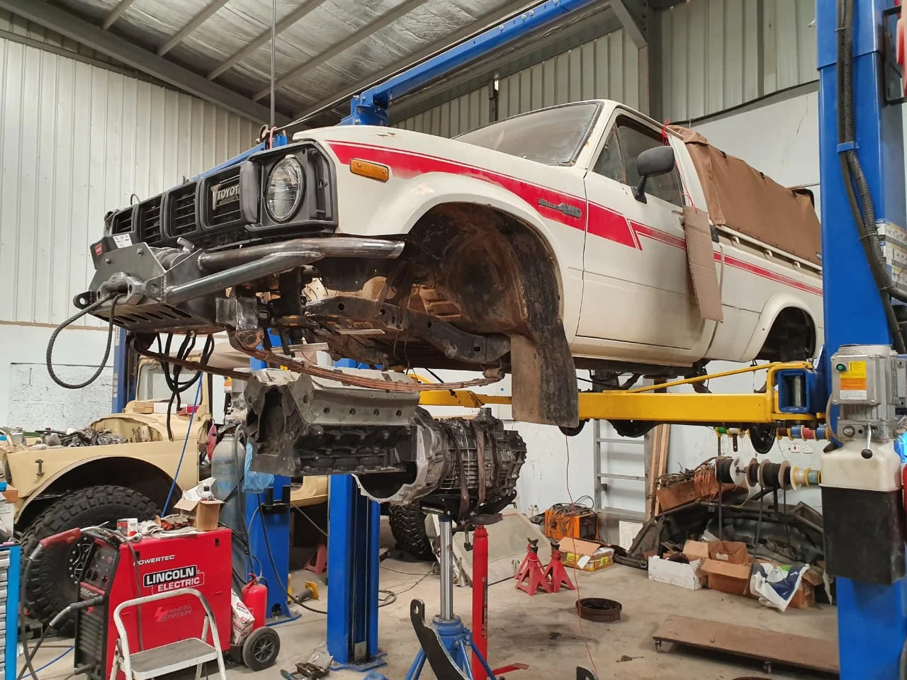

The engine is so HUGE in this engine bay. We had to cut through the firewall and the floor to accept the V8 and bigger heavier duty trans.

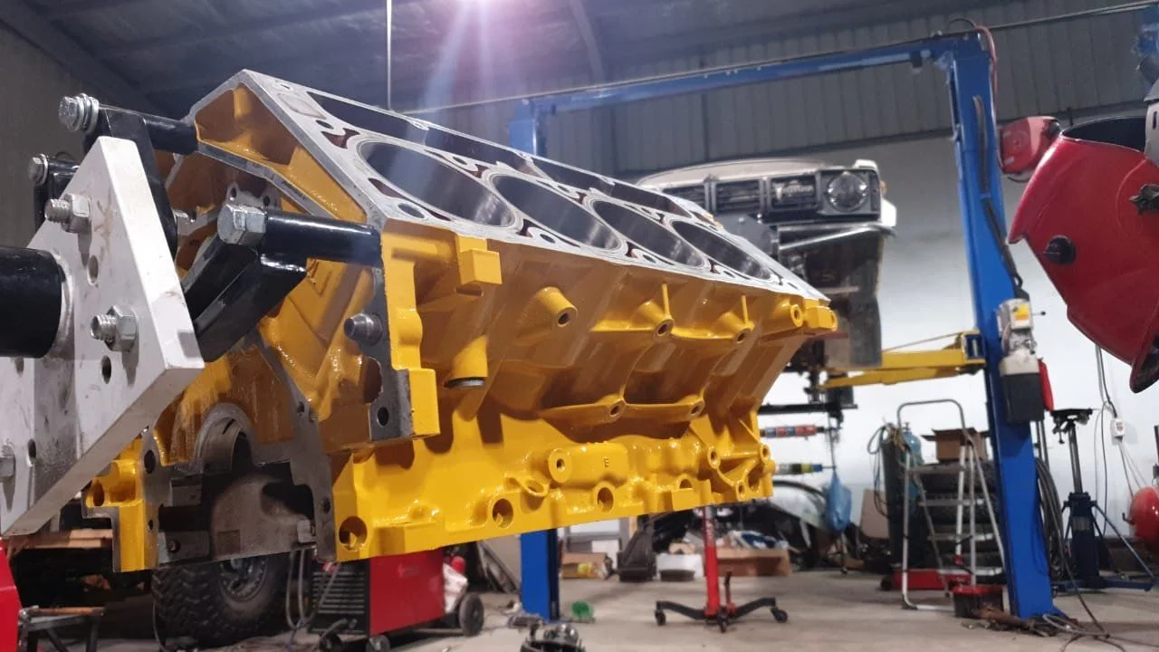

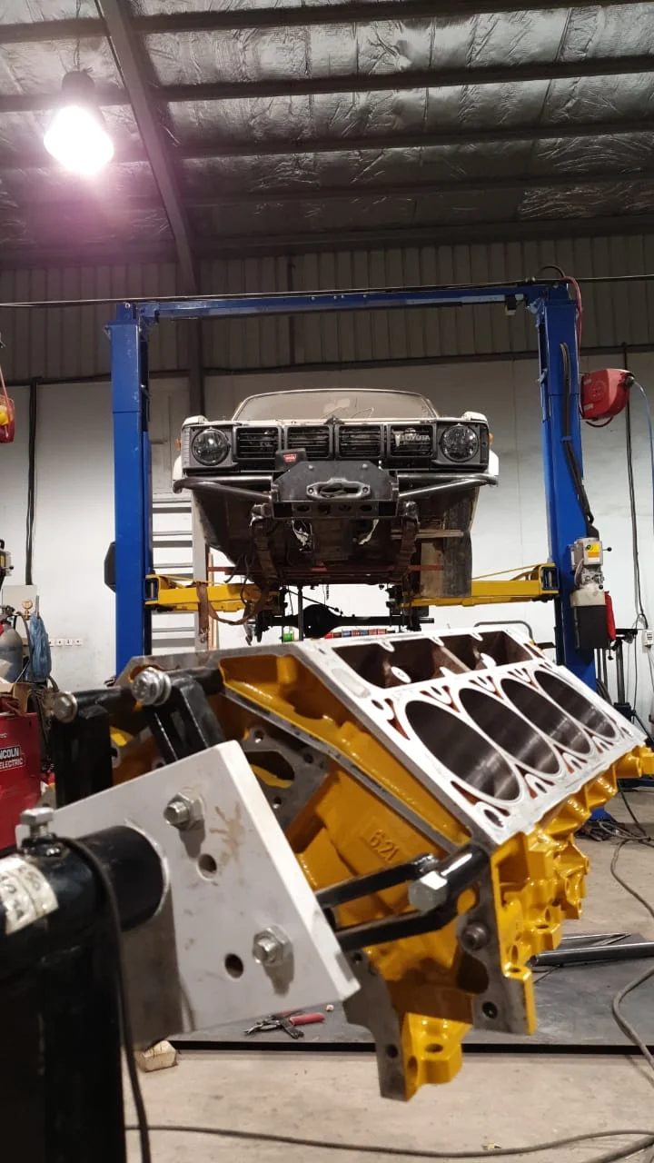

Here is the engine after we went through it. This is the block. We are waiting on some parts for it from the US so we decided to paint it Caterpillar yellow. Turned out great!

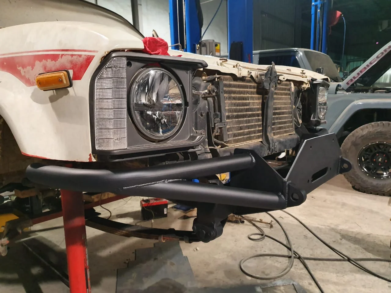

Chopped the front body panel and made a front bumper for it. The goal here was to keep weight down as much as possible. New bumper has provisions for a winch (M800 installed) and shackle points as well as improve the departure angle and points for Hi-lift Jack. Really happy with it. knocked it out in an afternoon. New bumper weighs 12kgs. I don't think we're too far from factory.

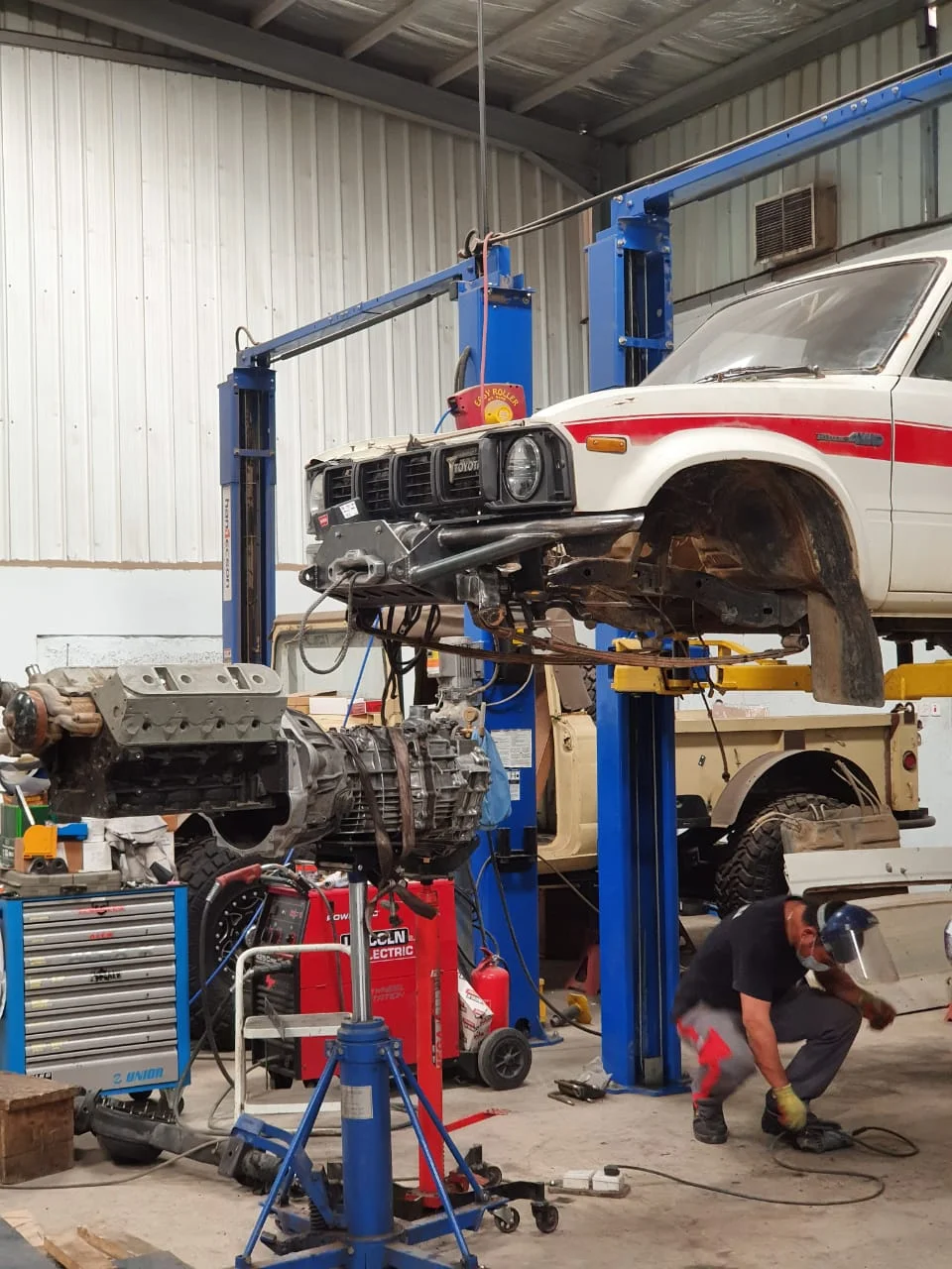

Here is the plastic engine bolted to the rest of the gear. Going in for mock-up.

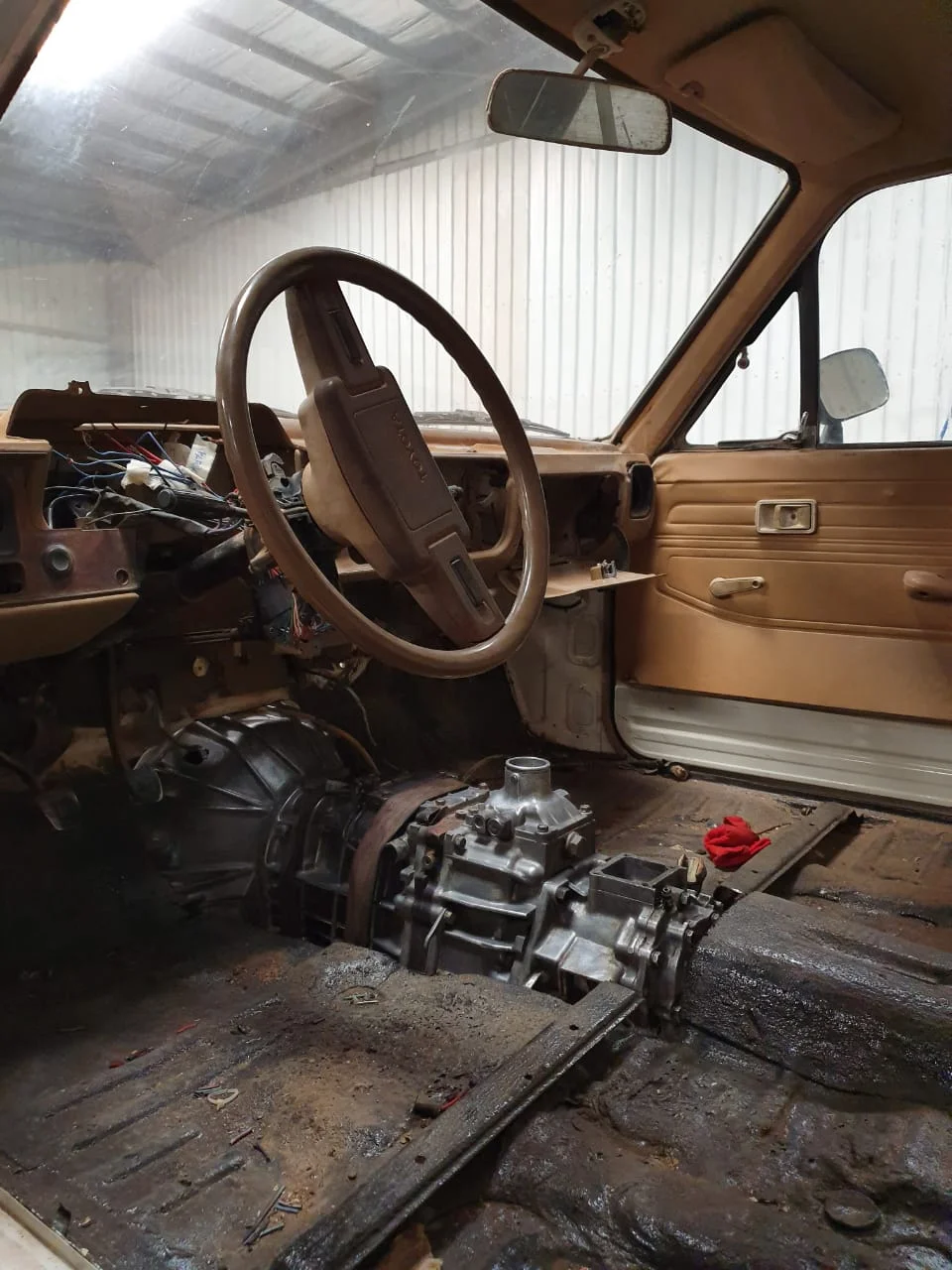

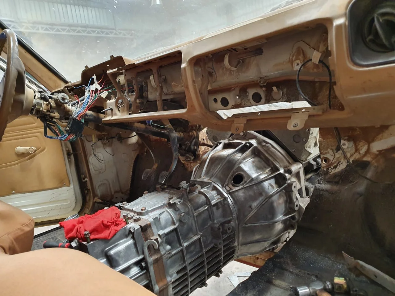

Here's a closer look inside the cab. the drive-train is huge for this chassis.
Plan is to re-locate the 3 pedals. I had to do so because of the bell-housing is in the way from the driver's side. Also , the factory pedals were never centered to begin with. Never really liked that. So this should be a good fix.
I'm going to build a new tunnel cover and dynomat it for noise and heat.

This is how I located the engine in the bay
I considered engine service, engine heat radiation, noise, front accessories clearance, exhaust routing and axle clearance.

Found a picture of the Hilux Right before we pulled it in.

H151F and HF1A part-time case are huge inside the cab.

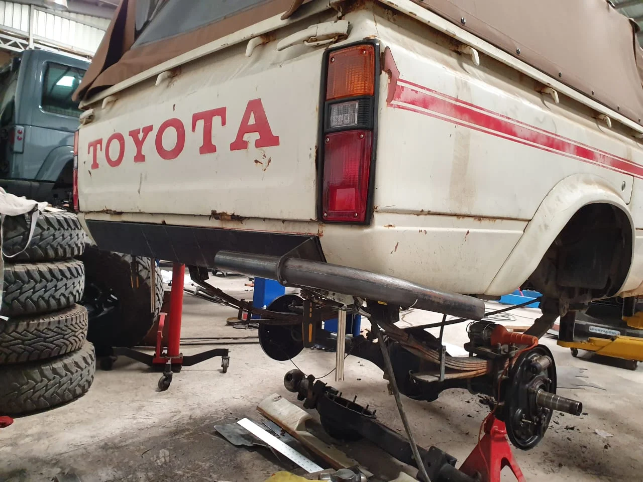

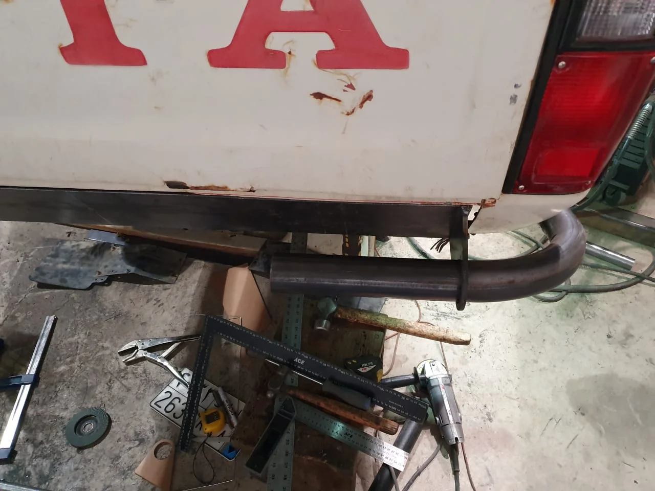

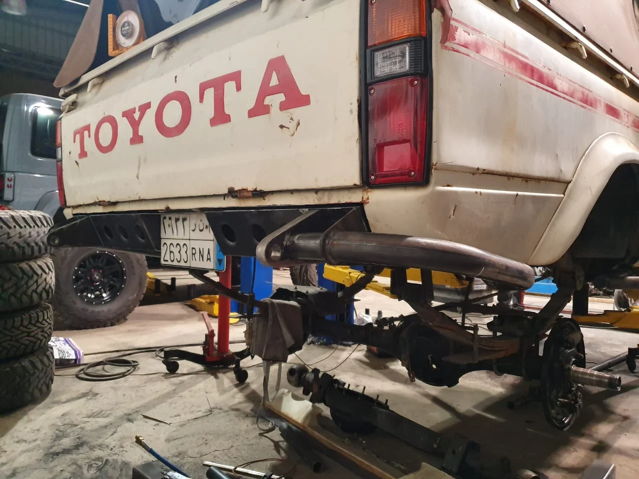

Here is the rear bumper in the making
A better view of the rear bumper in the making. Notice that FF flange :cool:
Also removed the cross-member in the frame, that carries the spare tire. Made a new one in the end of the frame. I plan to use the space between the rear axle and rear bumper for fuel. The only real issue I see would be pluming for the fuel filler. It's somewhat high on the side of the truck. Will need to figure out how to route the hoses.
Did a rough calculation on the new space I have between the rear axle and rear bumper. Might be able to squeeze in an 80Liter fuel tank and 20L water tank, all without sacrificing the departure angle or having the tanks low. I plan to slope the tanks towards the rear axle.
Key functions of this bumper
Light weight
Corner and rear protection
Attachment point for hi-lift jack (integrated)
Pin through shackle attachment points
Improved departure angle over stock
This thing is awesome.
hmmmmm... FF rear axle. can fix that any where

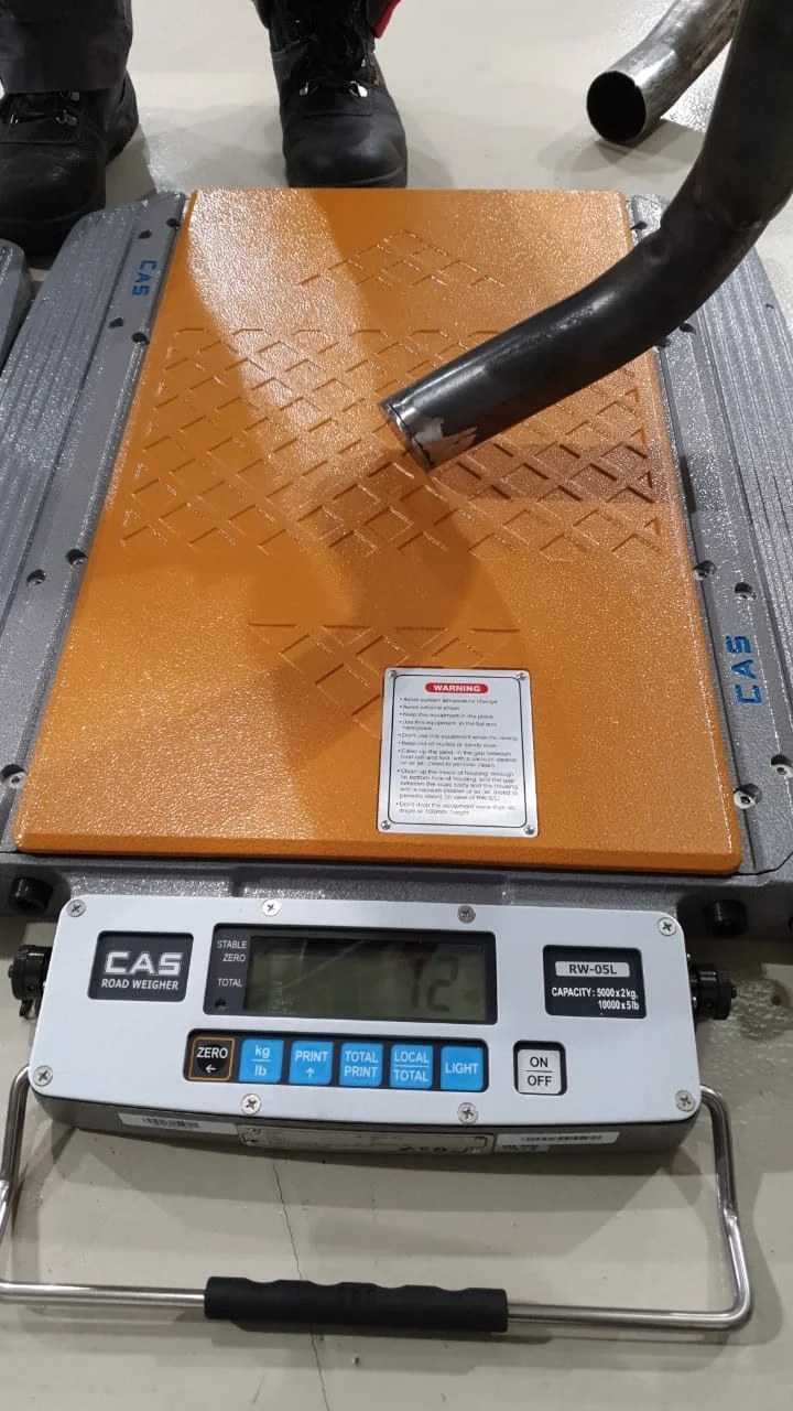

The rear bumper is done!
Just needs paint then weld it to the frame. It weighs 9kg/ 19lbs

Front bumper painted

I like the minimalist bumpers. How did form the large holes with emboss in the rear bumper? Sitting in the cab that guy is never going to forget he's got a V8 on tap...
