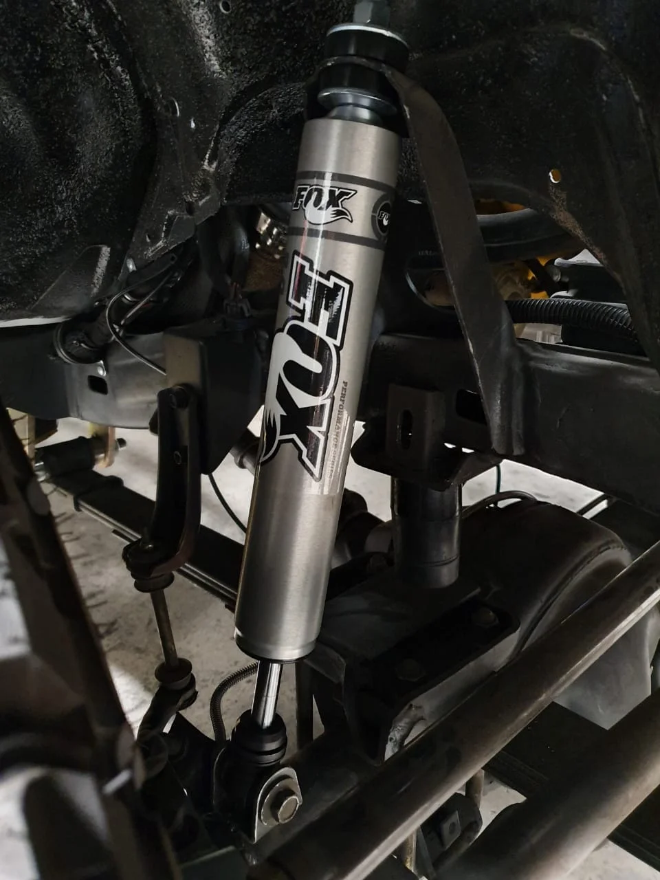

Front shocks got located. I just need to cycle it one more time before I finalize the lower bracket. That's a Daystar bump-stop on the frame.

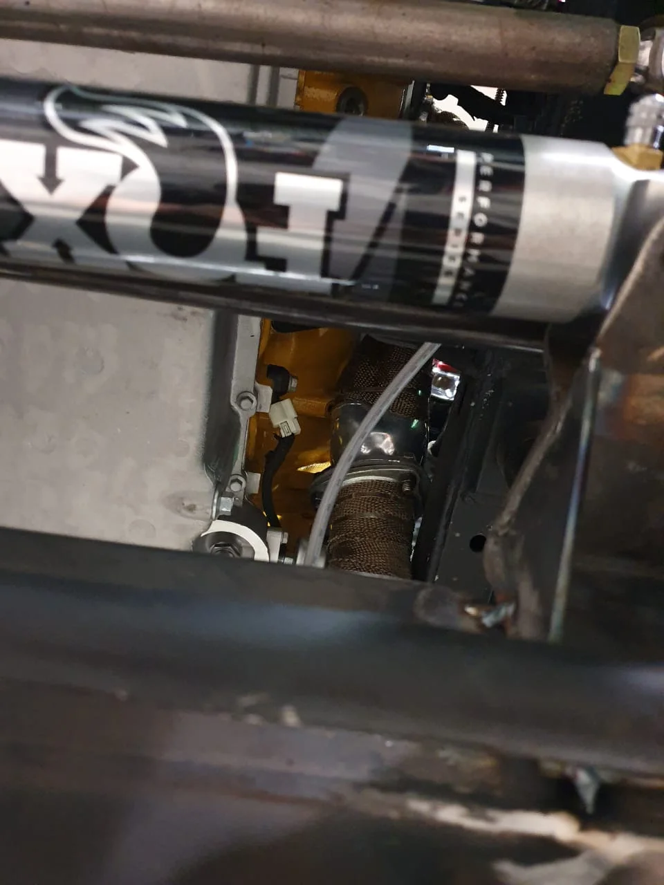

Installed a Fox steering stabilizer. Also showing the area I didn't wrap on the header.

Wouldnt mind a better look at the headers too......
