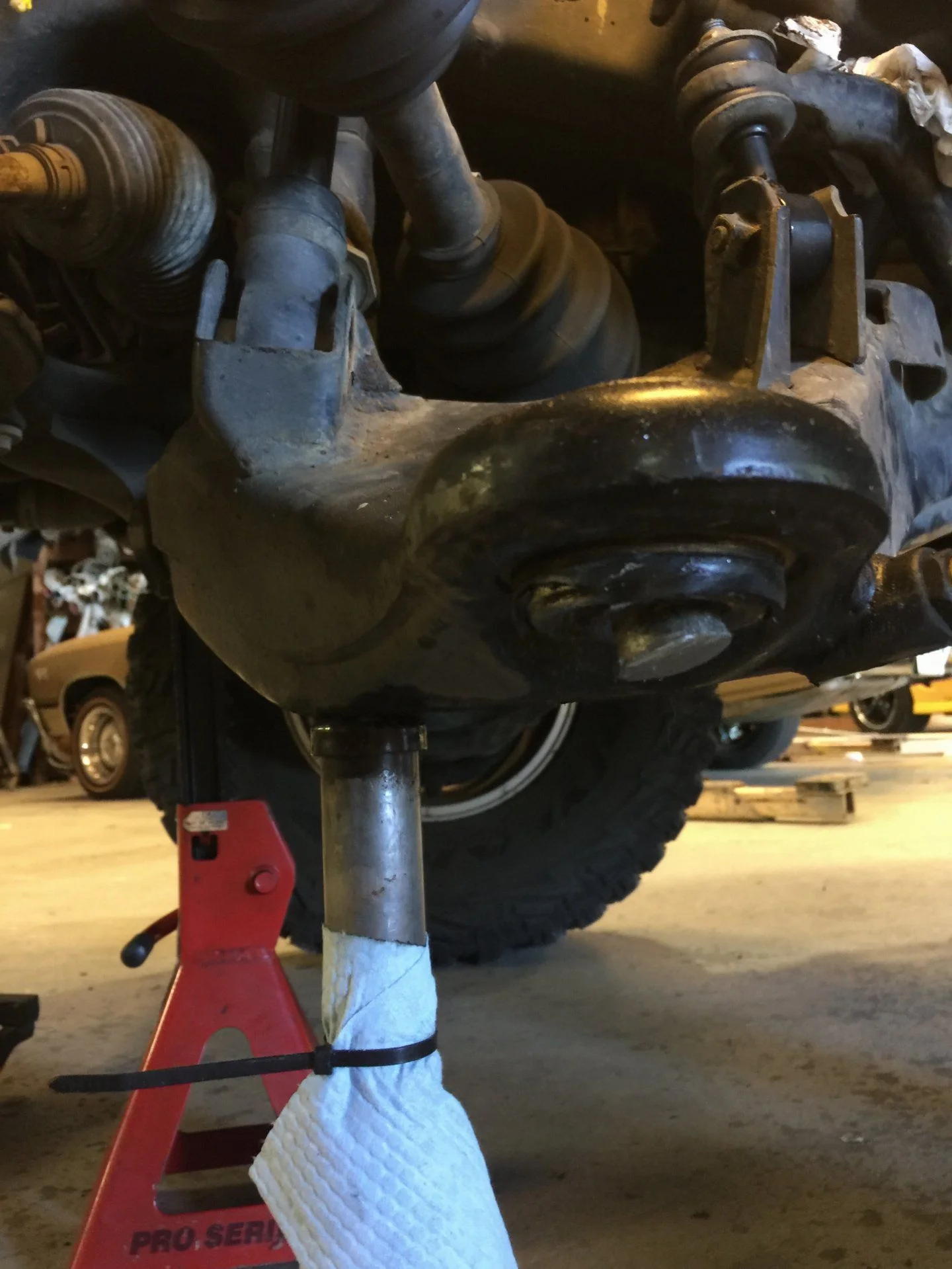

Then I tried putting a jack under the lower control arm and tried the tests again (while still on jack stands) and no play again.
Only when the vehicle had all tires on the ground, DS LCA lifted via jack could I notice some play in the ball joint via the pry bar method. It would move about 1/8", so not a ton, but the PS was rock solid.

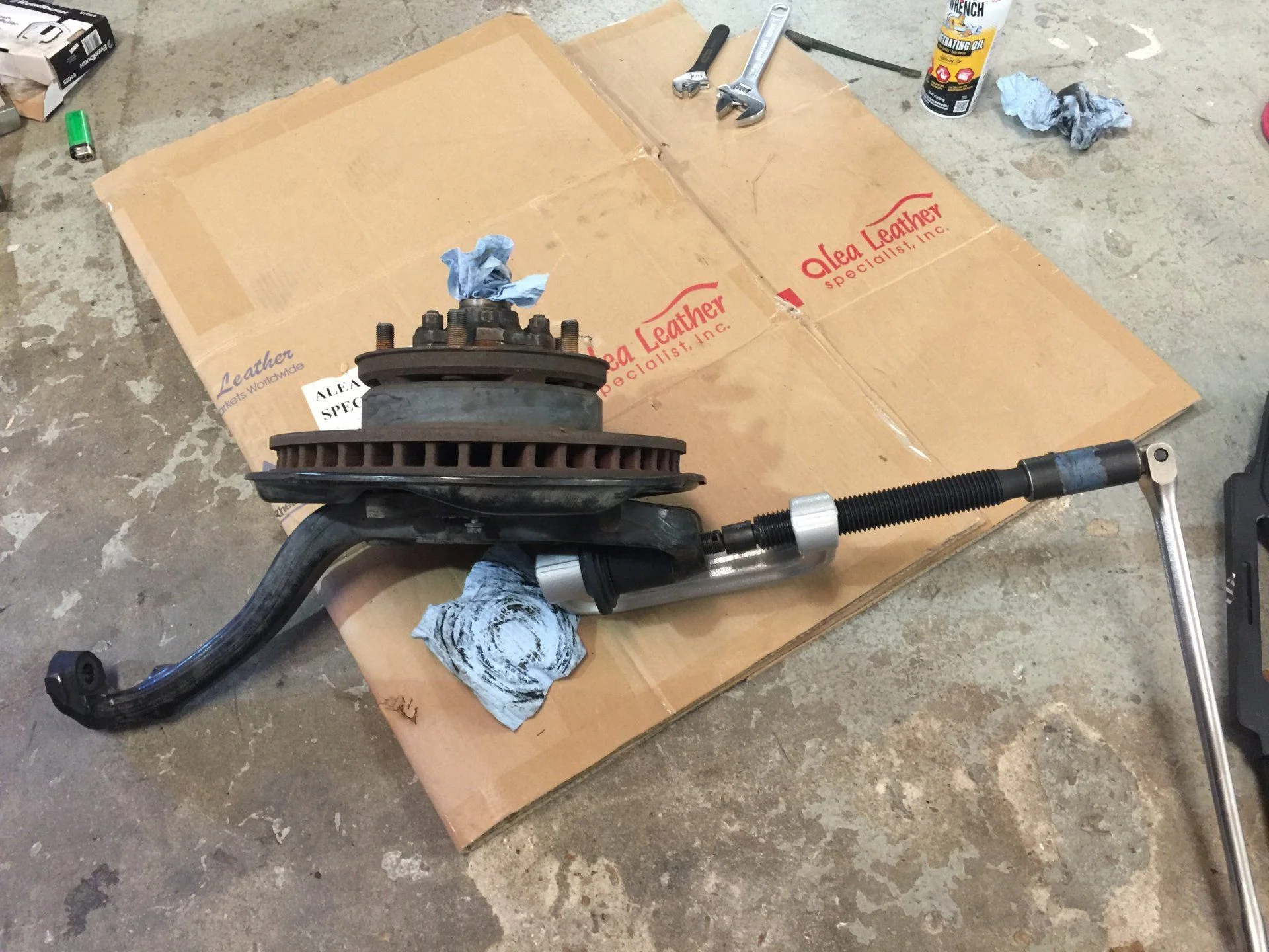

I've spent in total about 9 hours trying to get the lower ball joint to pop free of the spindle.
Tried putting the lower control arm at normal height (supported by jack) and at full droop, tried ball joint forks, beat on it with a sledge, sledge and fork at same time, tried a pulley puller as my ball joint separator won't fit in there, tried torching it.
Finally the morning I said F it and cut through it with a sawzall. It is definitely heat treated and hard as heck. Once I cut through it then I was able to use the ball joint separator kit from auto zone to pop that SOB out. Now to finish the rest of it lol....

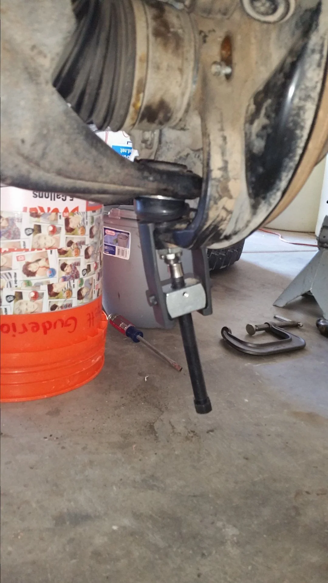

Completed replacing my lower ball joints last night. It wasn't hard at all, just time consuming. I was having a really hard time separating the ball joint from the knuckle so I decided to break out the air hammer with a pickle fork attachment. I got both sides off in about 20 minutes with that, and that was after beating on one side for about an hour. I couldnt see myself doing this job again without one.

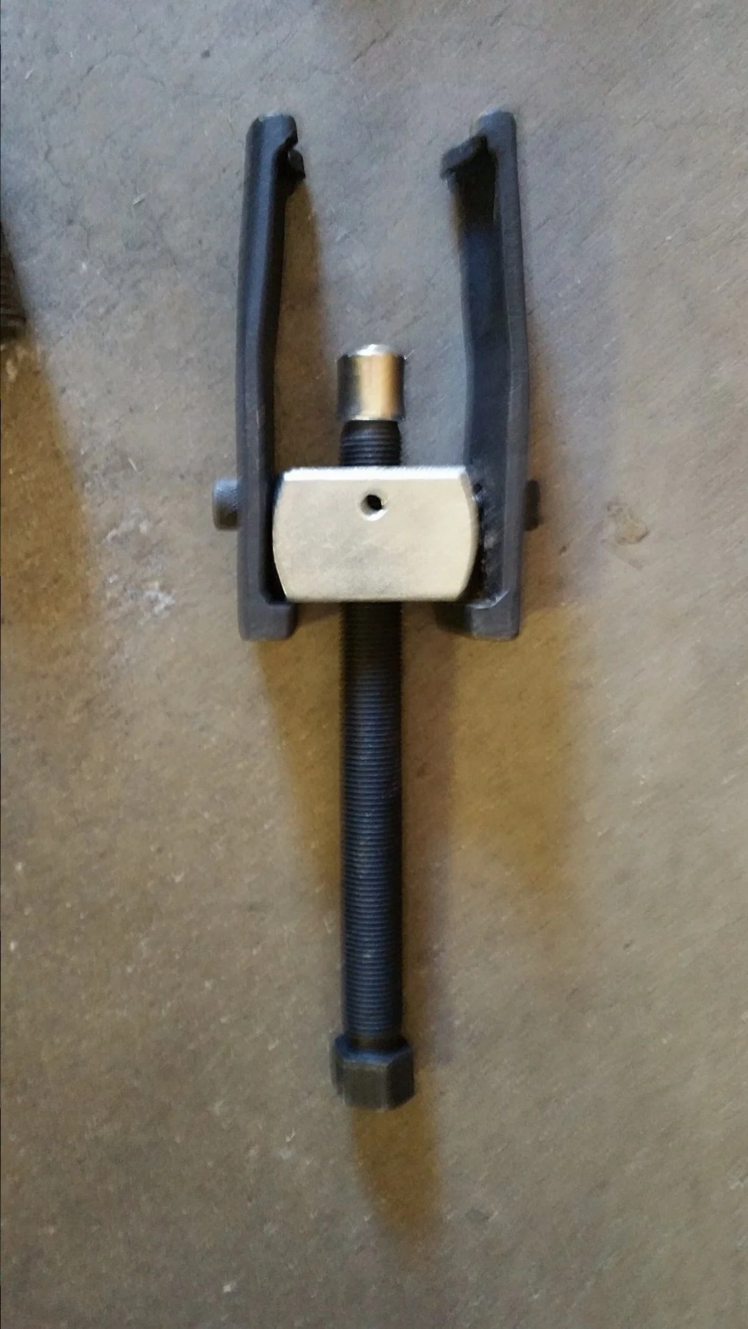

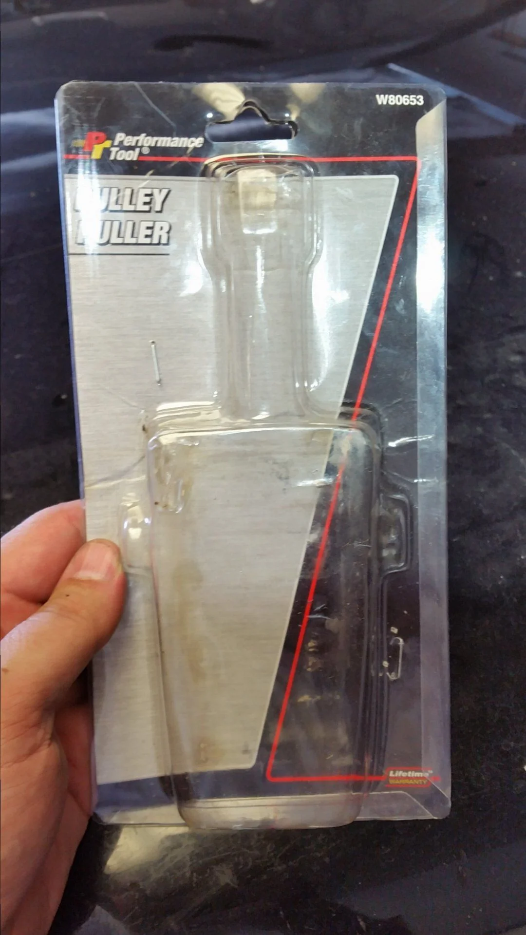

This puller worked on my lower joint without removing the dust shield. Bought at O'Rielly's. Performance Tool W80653.
Yes! I will be buying this tool. Much prefer this method over the sledge or pickle fork.
@soreneagle of course you post this the day after I buy a 555 on Amazon for 88$ haha (thankfully prime has easy returns). Called Napa and they will have me one there tomorrow and are doing the bucket 20% off deal. I need to replace a LCA bushing and my PS ball joint is looking a little suspect as well, so may as well replace it while taking everything apart.
Well, I got it done... I bought the pully puller shown earlier in the thread and was able to get one side free. The other side wouldn't come free no matter what. I ended up cutting it as shown by Layonnn and it worked like a charm.

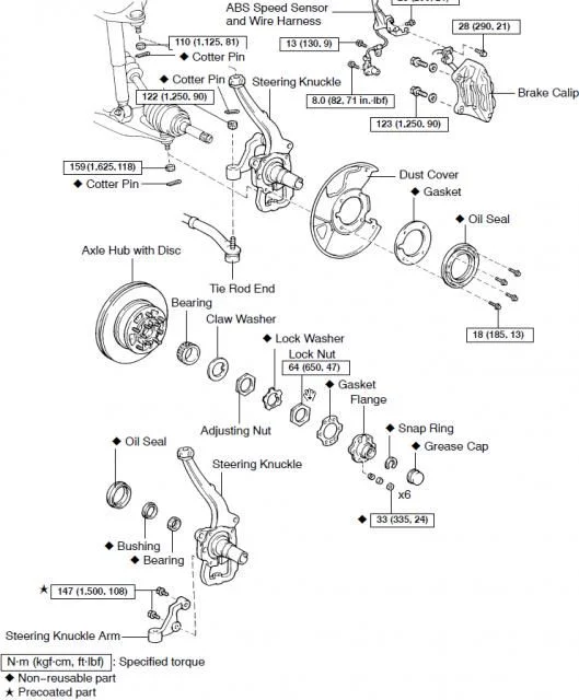

Not sure if you really need to remove the hub/rotor, just the wheel to get better access to the LBJ. The dust shield bends easily so be careful. But to answer your question, you'll need to remove the caliper to remove the hub/rotor. You'll need to remove the snapring, flange, and the locking nuts that hold the hub/rotor on the spindle. Good opportunity to repack bearings and grease spindle bearings. See Bearing repack GURUs for good tips.
Doesn't the CV axle come out the back of the rotor/hub once the snap ring is off? I would very much prefer to get the calipers off but am in a bit of a bind given how stuck they are at present. I think that like a lot of parts on my truck there's not heavy rust but they haven't been apart since Feb of 98....
