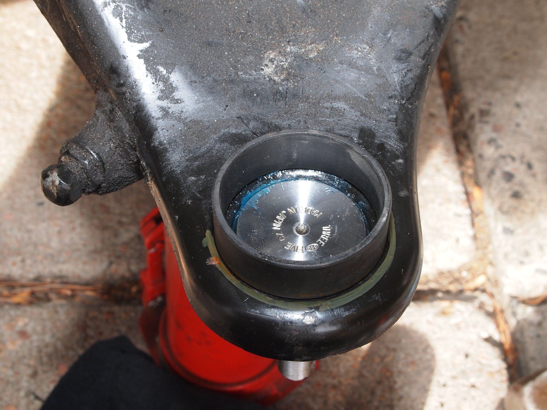

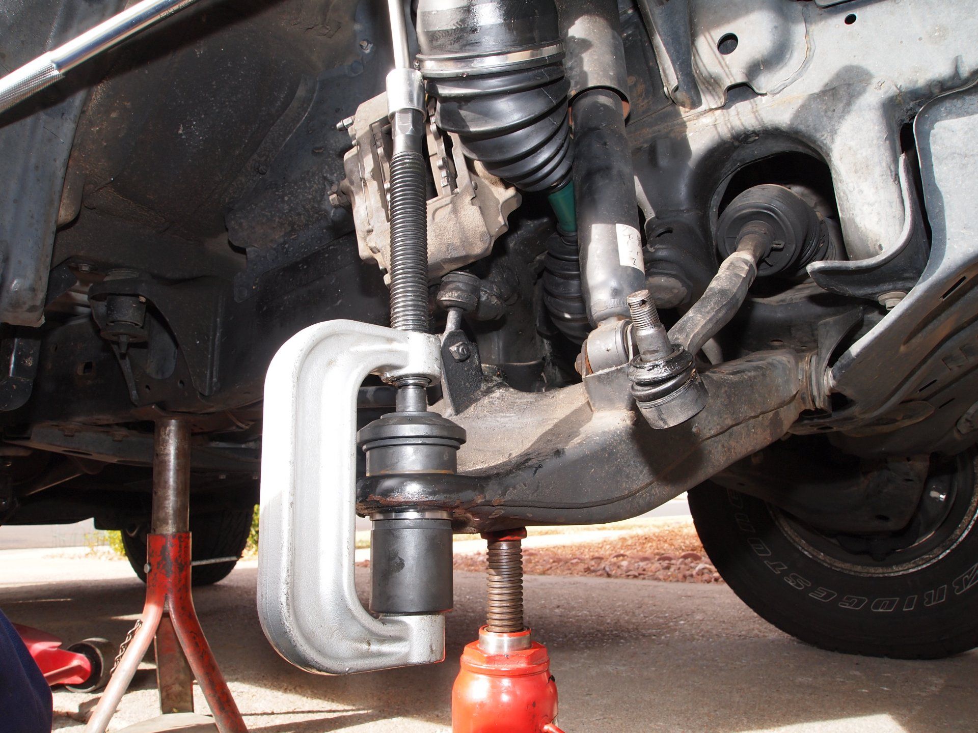

I done more than a few lower ball joint. I find the Powerbuilt 46 kit has everything I need. No need for a 2 1/2 pipe adapter. As @Biga27110 said: The trick is to take off the ball joint boot. You want the adapter the fits very sung on the bear ball joint. Otherwise it will be difficult to center and keep square.
Centering marks
Boot is off.

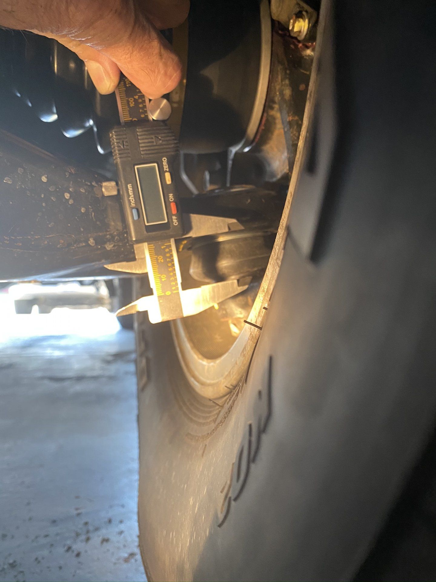

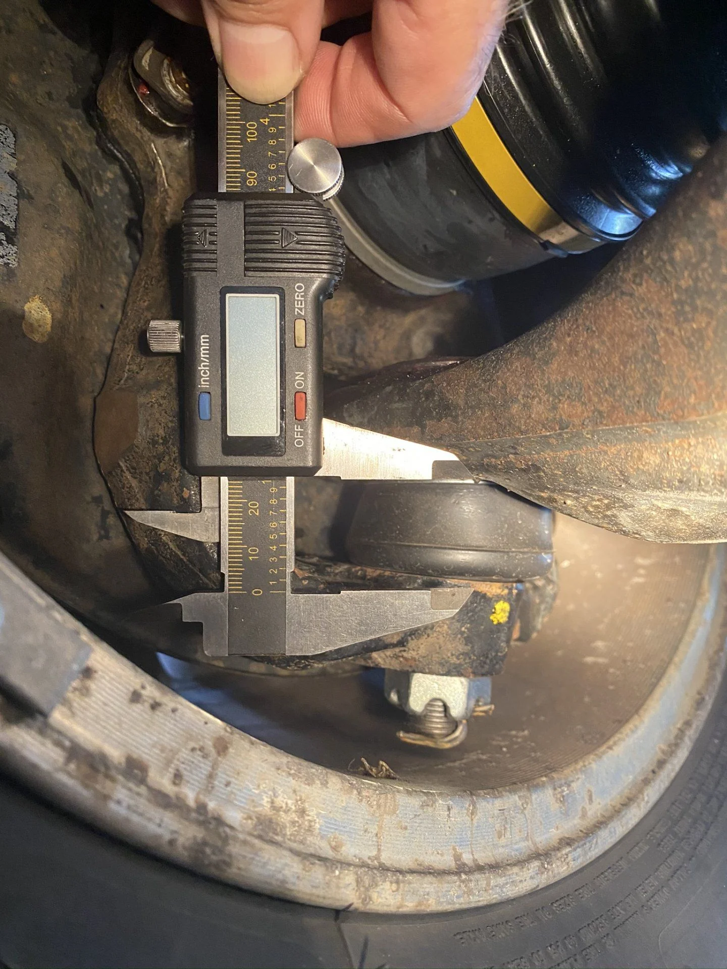

On another note. I found that the spread between knuckle and control arm is ~2.2 mm less with 555s, than factory. The gap we see between snap ring and lower control is the ball joint coming up ~2.2 mm to far, before seating. Not sure if this has any effect on suspension or alignment. But would be nice if it fit like factory. I'm looking for a large 2 or 3mm thick washer to place on ball joint, than press in BJ.

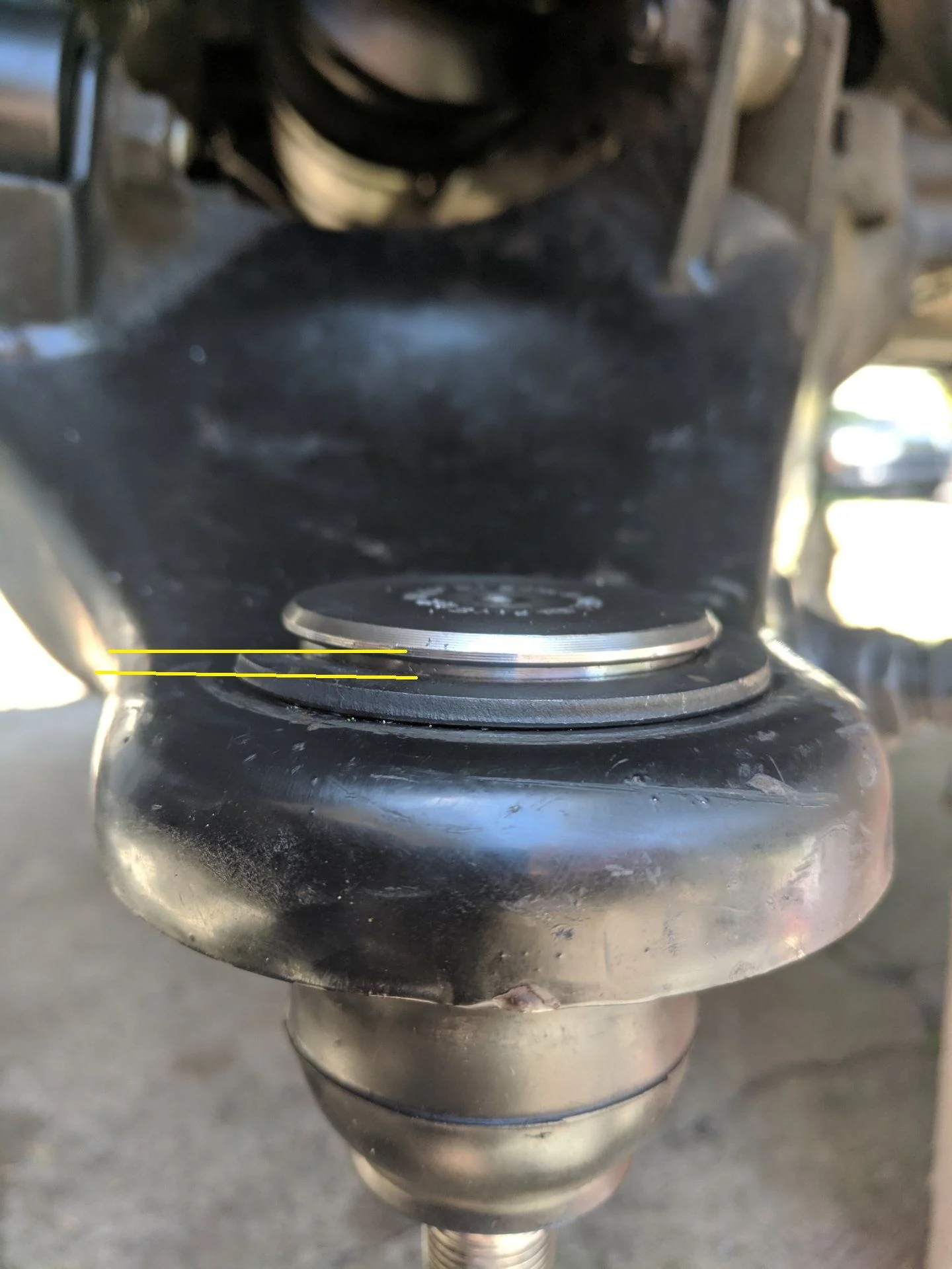

Notice the gap, which is due to ball joint seating to high. In this picture gap looks uneven, which mean not seated squarely/fully.
Factory 26.2mm gap
555 24mm gap
Centering marks
Boot is off.
On another note. I found that the spread between knuckle and control arm is 4 mm less with 555s, than factory. The gap we see between snap ring and lower control is the ball joint coming up 3 mm to far, before seating. Not sure if this has any effect on suspension or alignment. But would be nice if fit like factory. I'm looking for a large 3mm thick washer to place on ball joint, than press in.
Factory 26.2mm gap
555 24mm gap

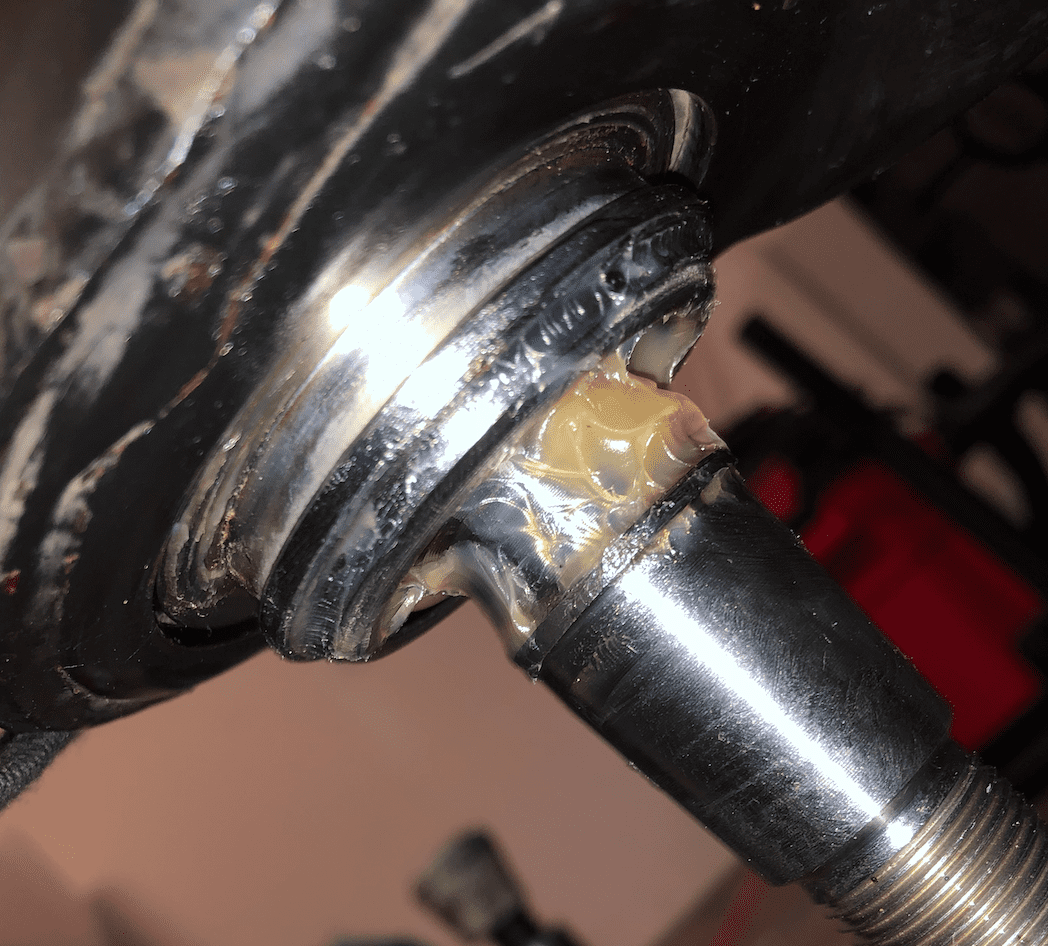

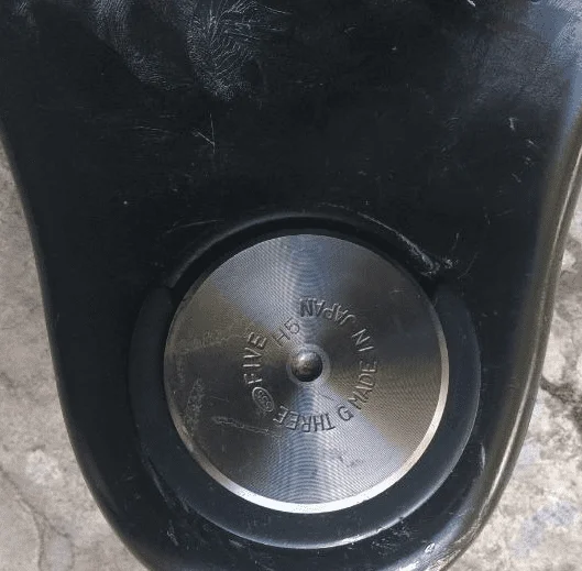

Heres the underside of a 555 LBJ without the rubber boot for reference. You can see the surface that you want to press and it needs to go all the way in like pictured.
Heres the underside of a 555 LBJ without the rubber boot for reference. You can see the surface that you want to press and it needs to go all the way in like pictured.View attachment 2436577
Omg thats a picture I was hoping for! Now there is no grey areas in this install. Thank you so much. Im ready to take on this install when the part comes in from cruiser outfitters.
Yes remove the boot to get the install tool on sung. The sung fit helps keep ball joint aligned as you press in.
You do not need to lube them. Just keep very clean until boot back on.
Factory 26.2mm gap
555 24mm gap

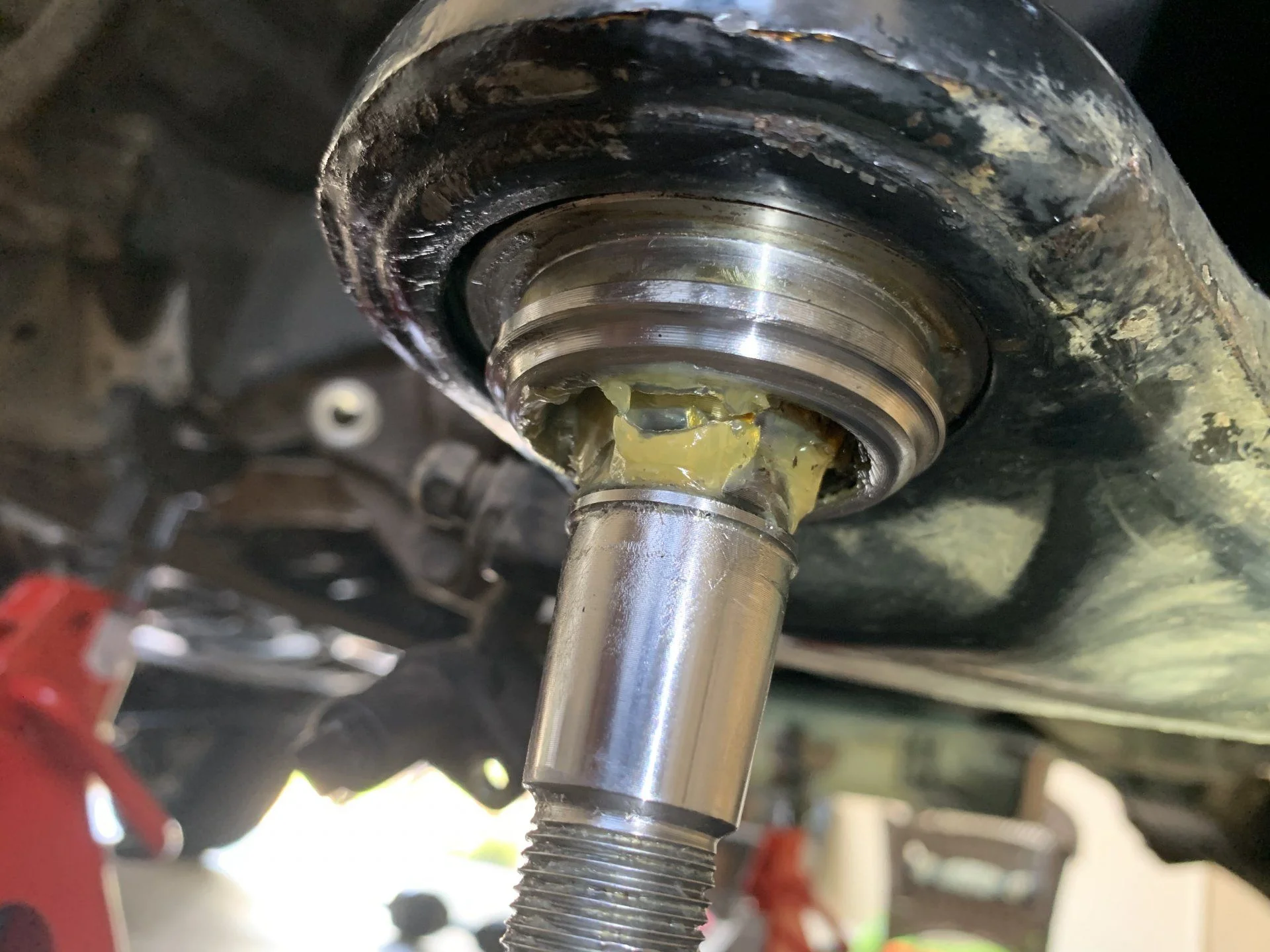

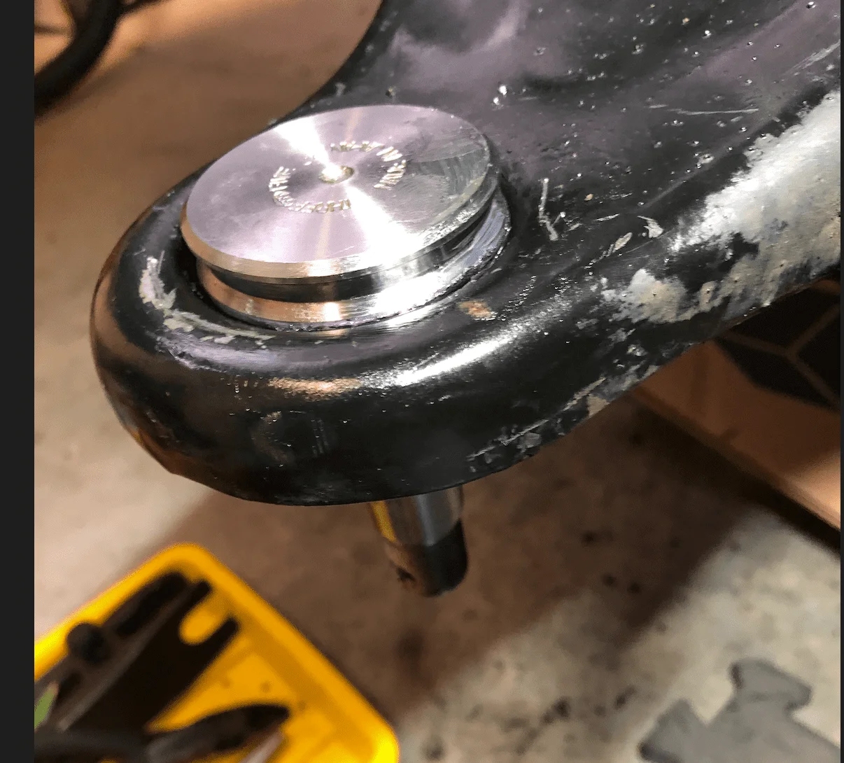

Working on my LBJ, Did I press it out too much? Please let me know your suggestion before I put on snap ring, Thanks!
You're okay, put the snap ring on. Pressing in until it stop, is proper procedure.
Unfortunately the 555's are not a perfect fit. The stop on them, is cut about 2mm deeper than OME. It would be nice to find a SS washer ~2mm thick, and place on them before pressing in. But I've to find one a perfect fit.

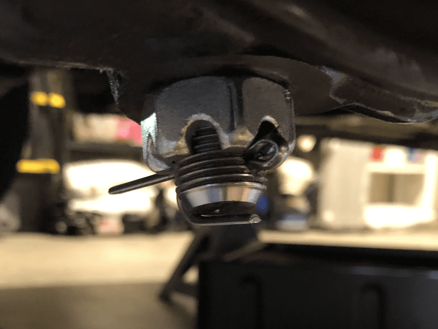

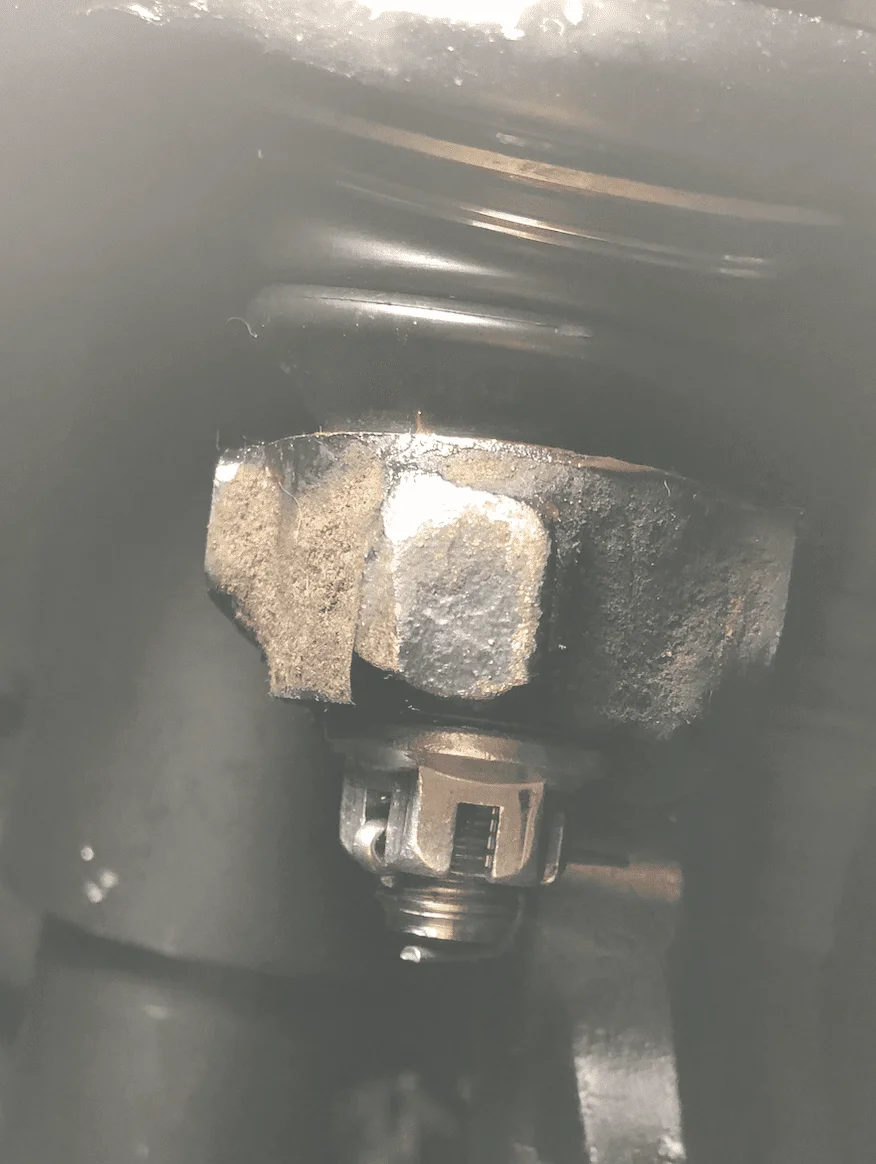

Do I need to put any lock-tight to the bolt which connects the ball joint to the wheel knuckle? Is it ok if there is a little grease on these bolts?
(because I greased the hole on the knuckle when I put it on to prevent thread damage, so there will be a little grease on the ball joint bolt. I think it would be ok because there are cotter pins, but I'd better confirm this ) Thanks!
