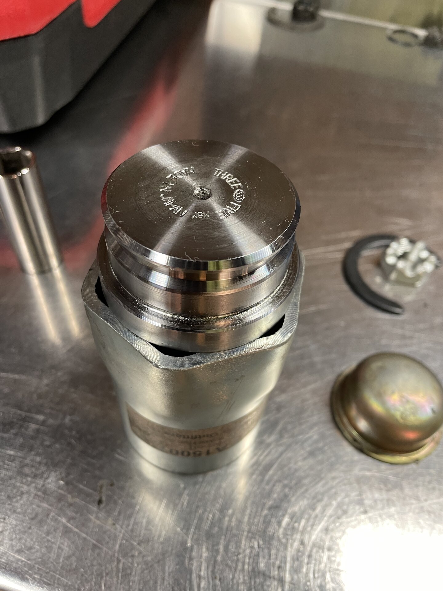

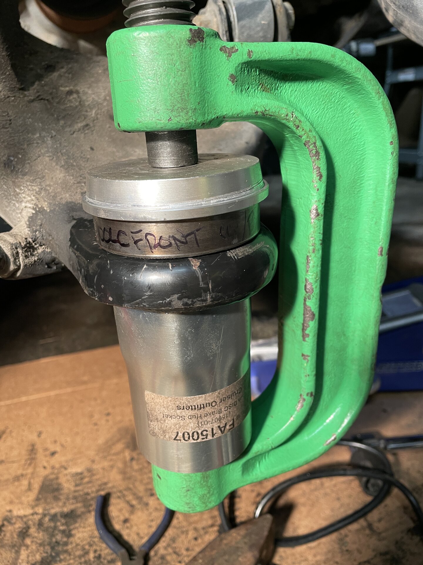

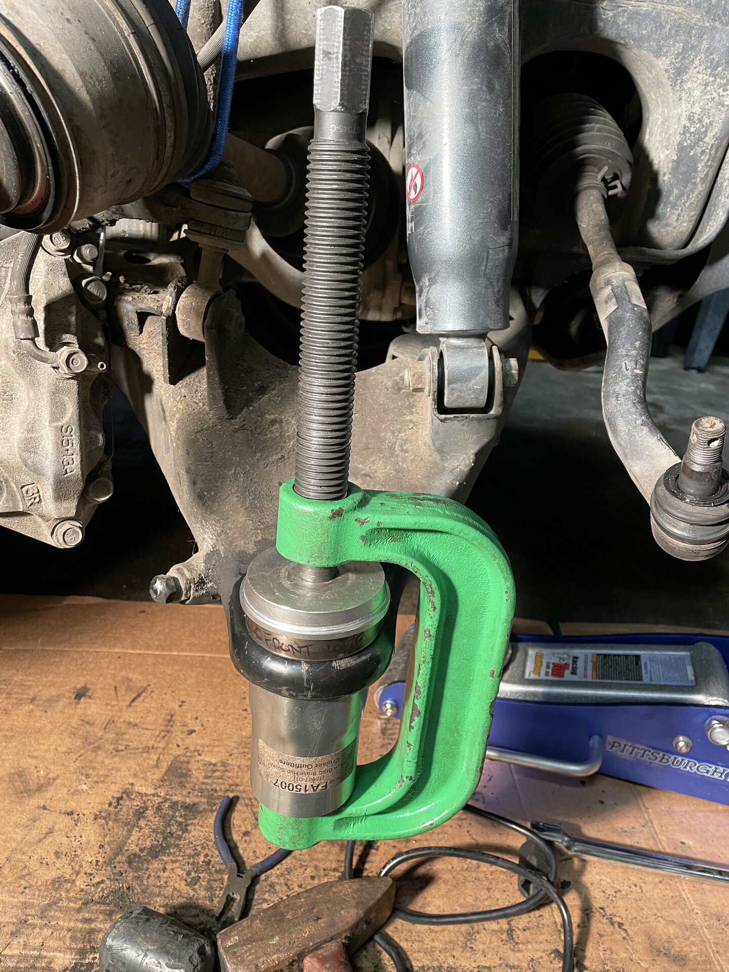

Not sure if this will help anyone or not but I was doing upper and lower ball joints and having a horrible time trying to figure out a way to get the LBJ pressed back in using the part store crap ball joint press kit. The piece that fit over the ball joint was a little to big and once I got something setup with the kit parts above and below the ball joint the C clamp wouldn't fit over all of it. Total sh!t show.
The week prior I did wheel bearings and still had parts/tools out. I ended up using the Cruiser Outfitters 54mm hub socket, my old front wheel bearing race and a race driver to press the lower ball joint in. Worked awesome. I originally tried using a piece of 2 1/8" id exhaust tubing as mentioned by a member on her in another thread but it buckled and didnt work for me. @cruiseroutfit maybe you can mark the 54mm socket as a LBJ press now too lol

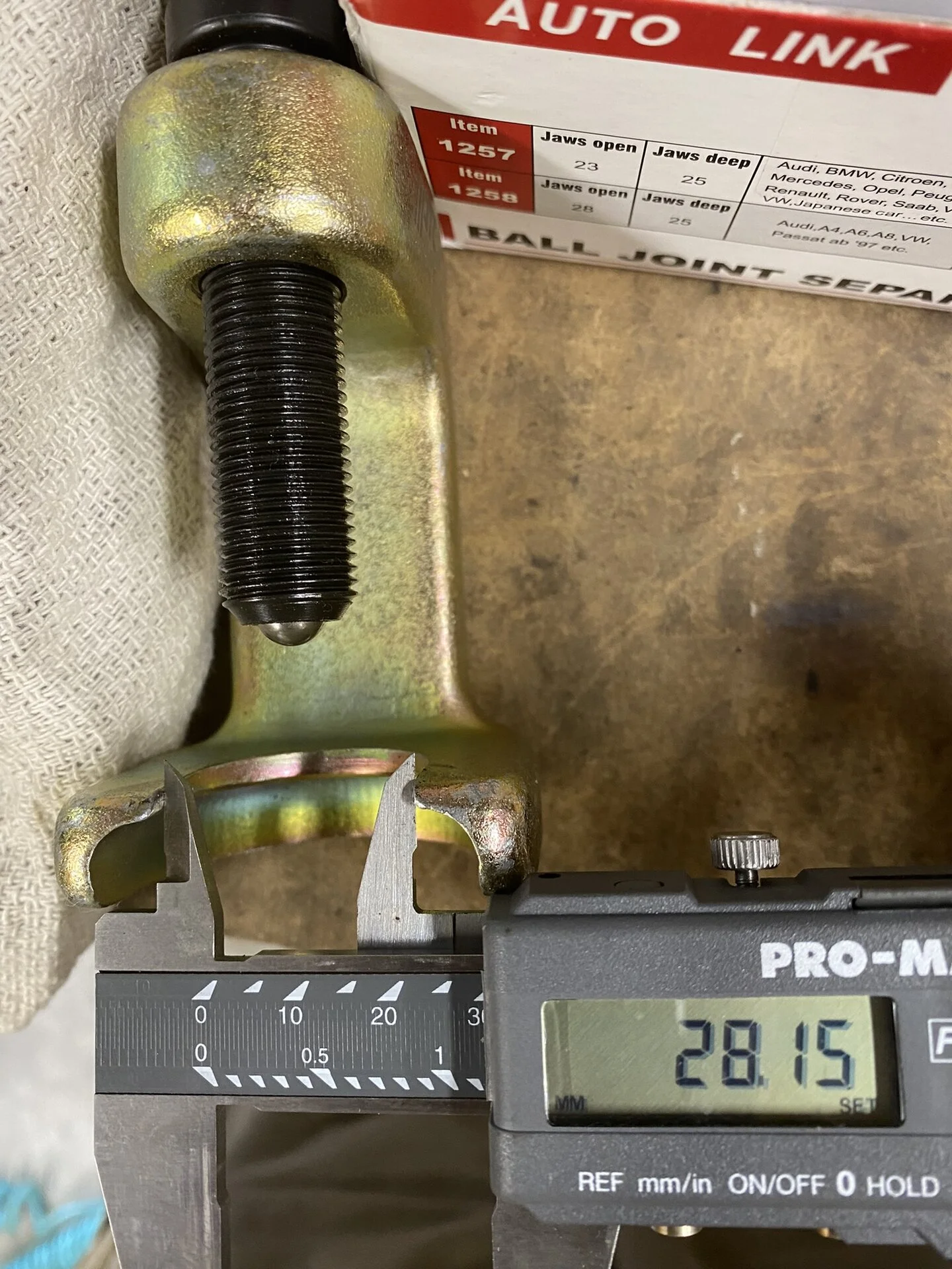

BTW: I finally have a puller (JTC 1258, I modified) for TRE, with brake dust shield/wheel hub on.
I did needed to modify by grinding ID, just a little larger.
Fit's like a hand-in-a-glove. Sweet!
Works on lower also:
