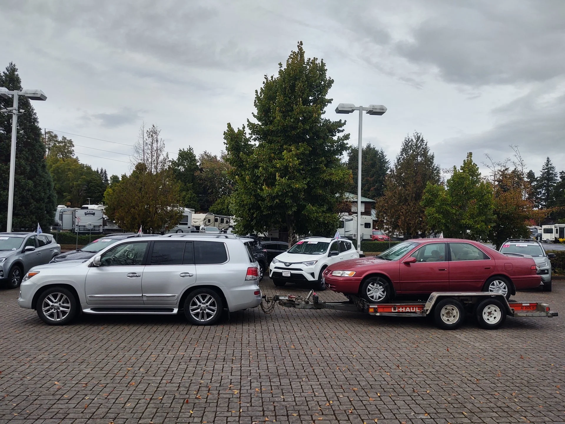

Here it is ... the beast, just purchased before leaving for home, with my Camry in tow. Picture is in dealer were it was inspected, but it was a private sale.
2013, 96k miles, conditions above excellent - a paint chip on the hood, a chip on the windshield and a missing plastic pin on the engine plastic shroud. Only missing the remote start option. It is silver outside and black w/ a blue hue inside, dark wood, dark silver plastic. Much, much better than the parchment interior. It looks elegant but not luxury in your face. I like it a lot.
Was used for shuttling the kids to games, school, and a bit of vacations in state. Kinds gone to college, car sold. Full records. Leather like new cause the owners did not like the leather feel and had covers.
Never towed anything - the draw bar was new in OEM box and the hitch was virgin.
Never saw forest roads or snow.
Tires just replaced and brakes almost new.
Buying it is an entire story and it took one month and a lot of patience. That is the bad and painful part and I'm ready to wipe it from my memory.
Love the car and how it tows - hence the beast name.
As I said before after test drive I still hate the brakes even more now after I saw how they behave when towing. I have to track my Volvo to make the brakes smell like they smell on LX with just normal breaking while towing. I think sooner or later I'll have to address the brakes.
Very happy with the purchase.
