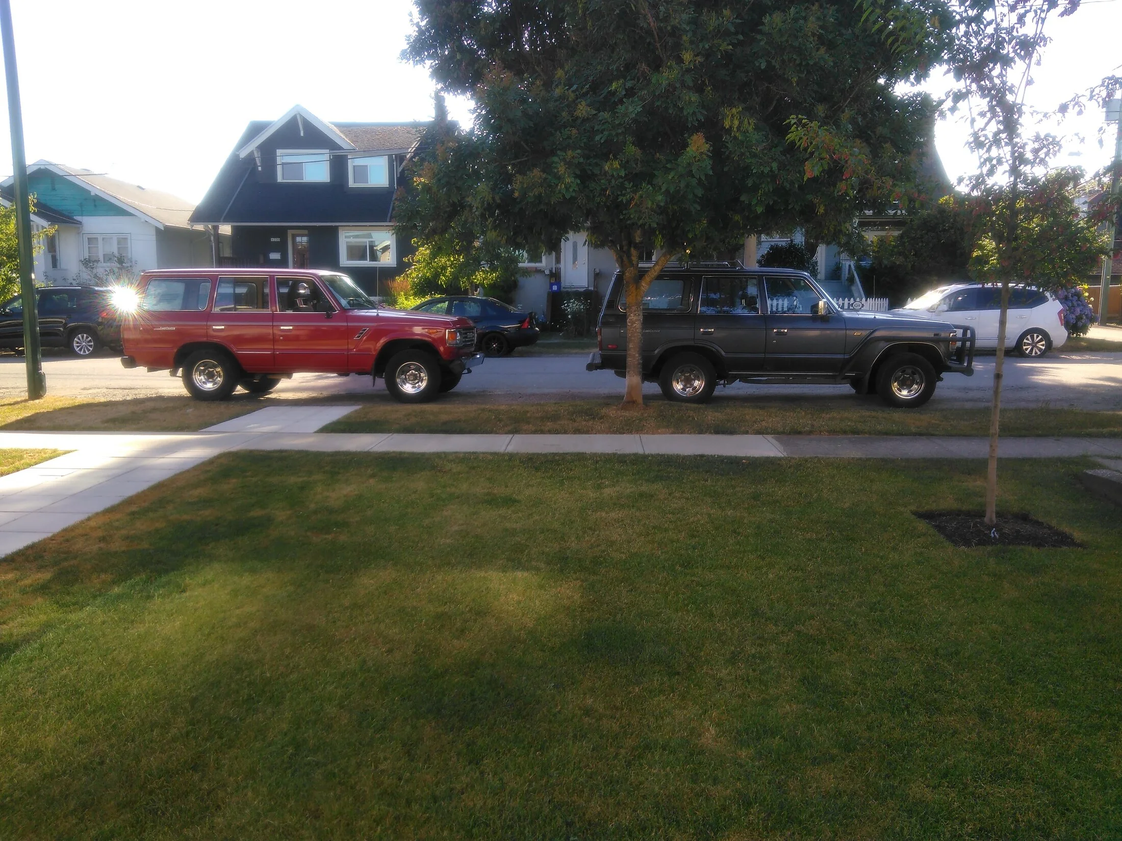

Making the auto/manual switch is obviously very doable, but I could see the costs racking up very quickly. Plus a lot of downtime for the truck. But hey, we want what we want. I wanted the same thing, and went the route of a donor swap. Rusted out local HJ60/H55f into a rust free (well as close as you can get) FJ60 from Oregon. Fun times.
Here's a pre-swap pic, just for fun.

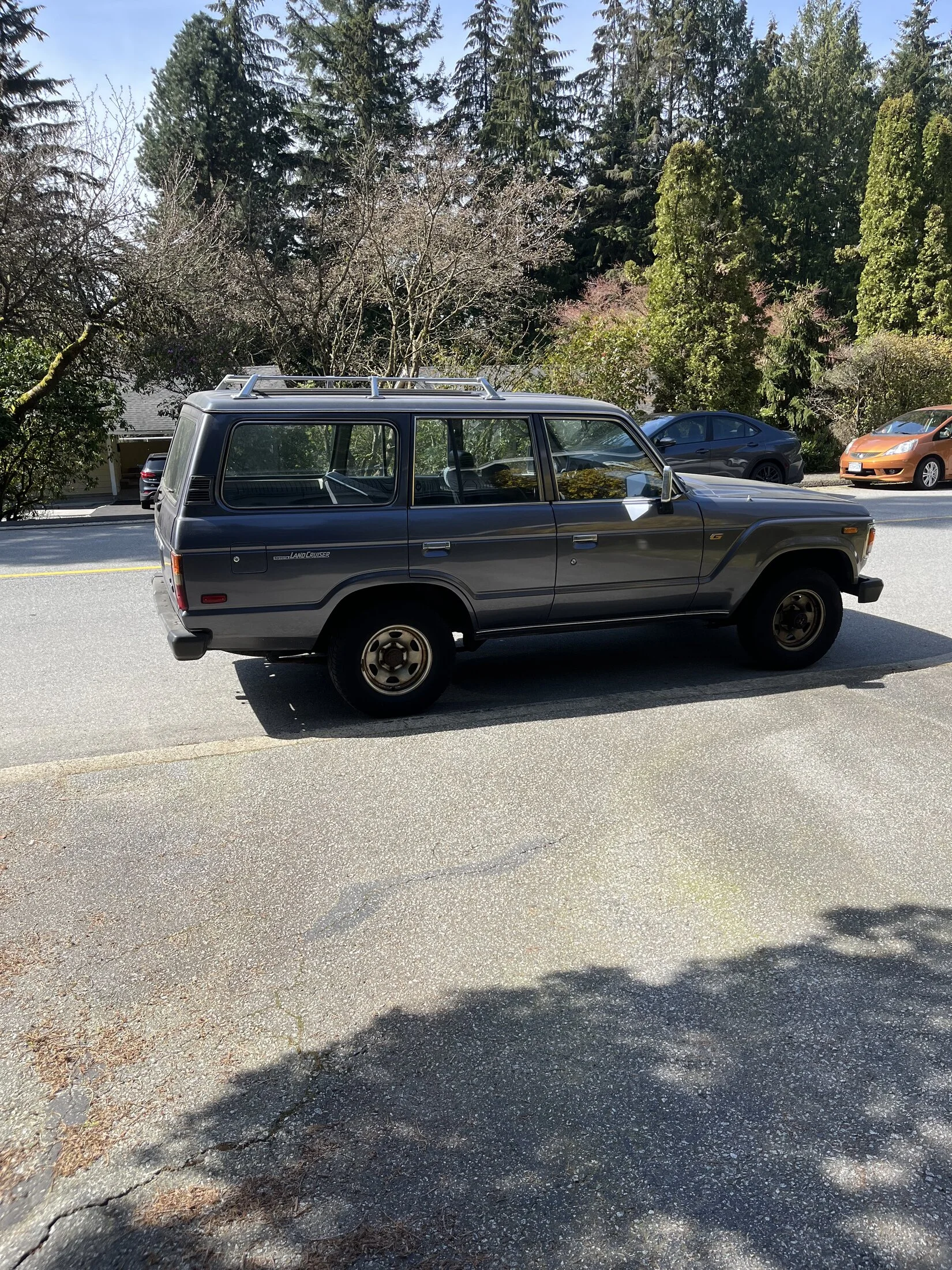

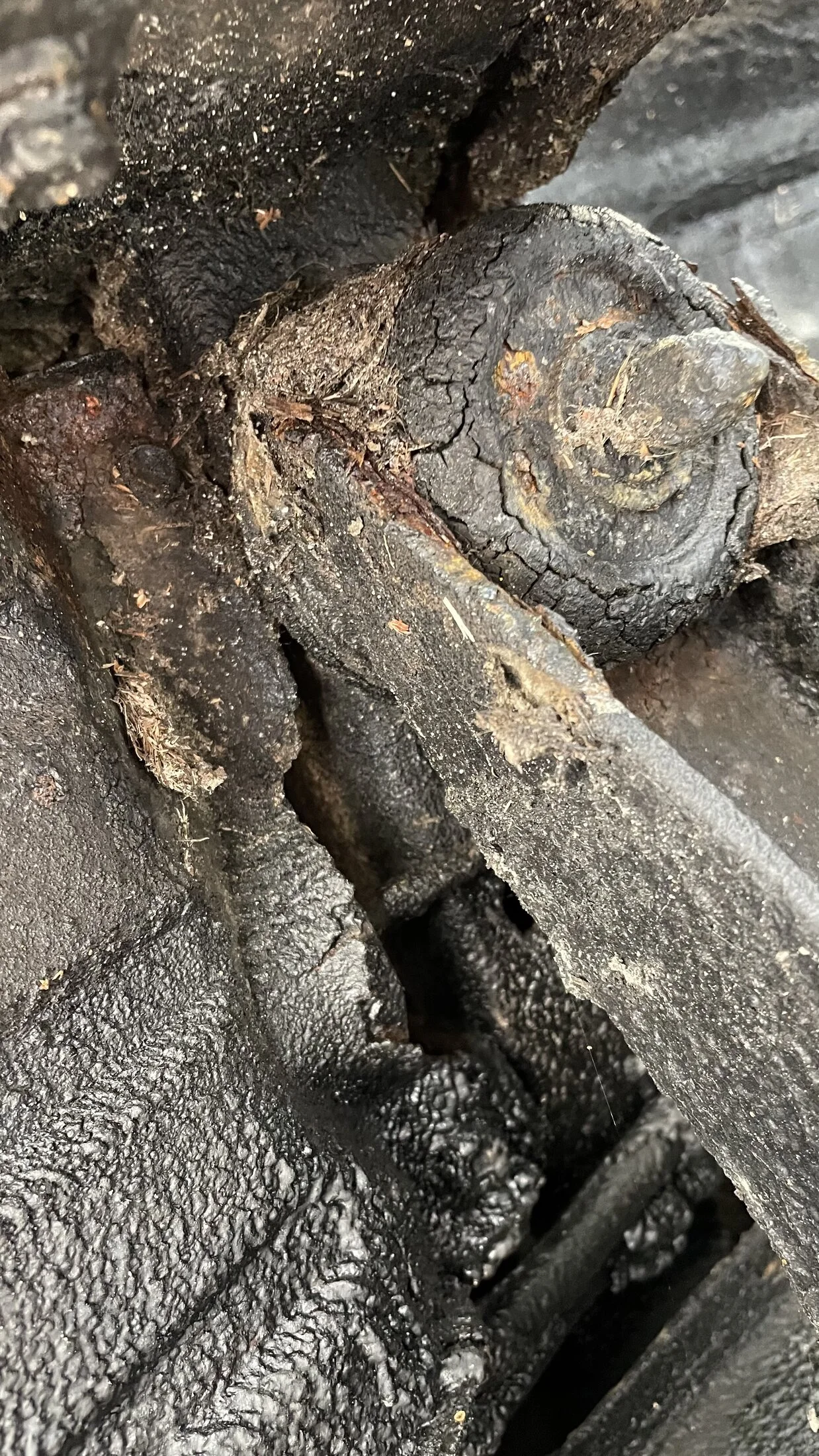

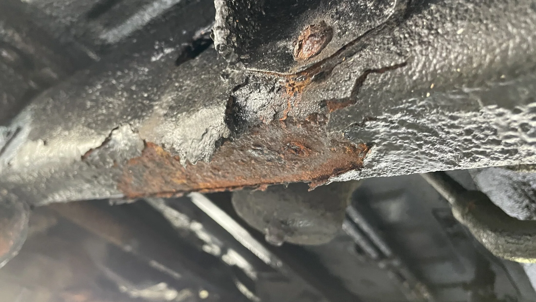

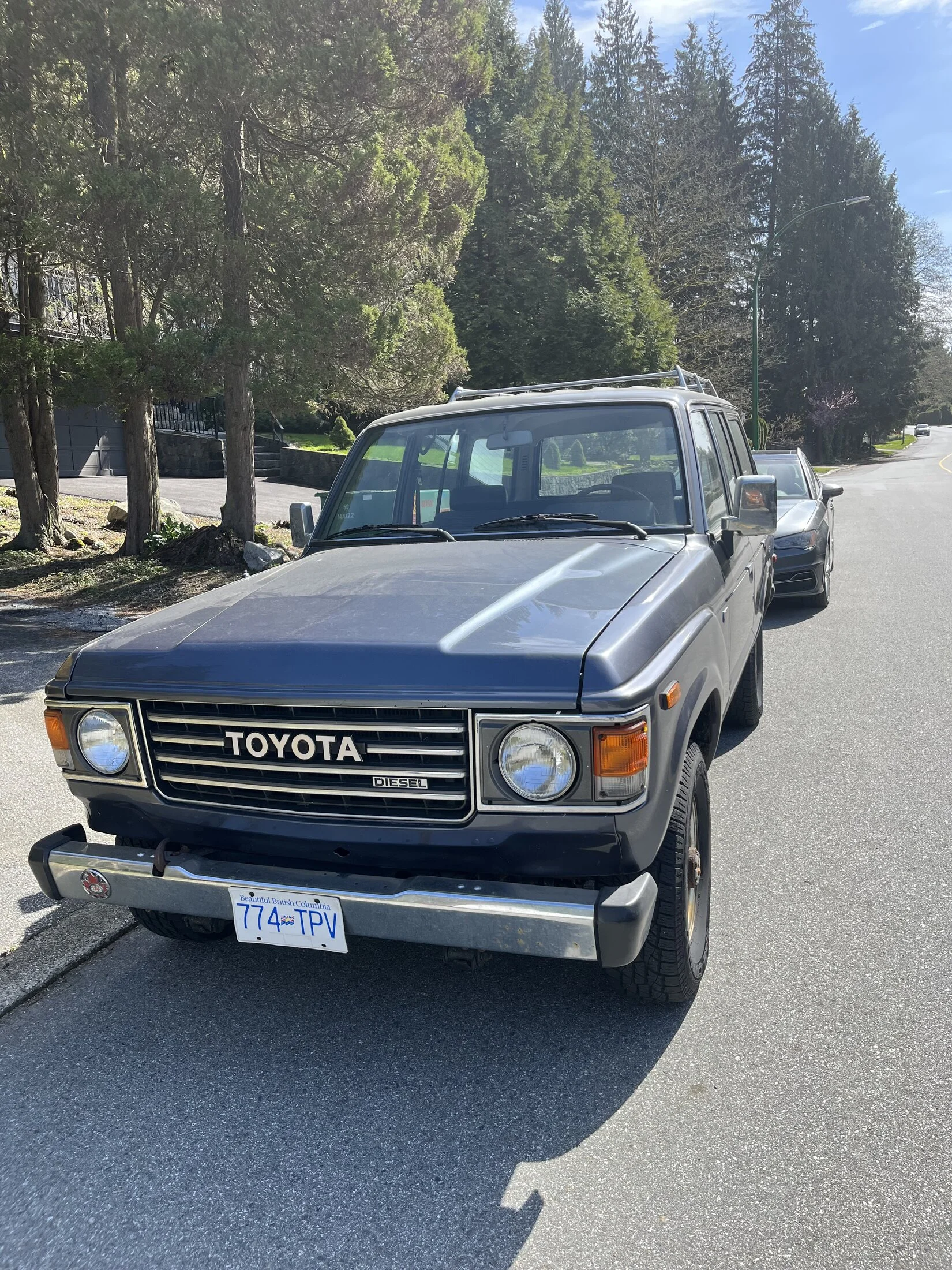

Ok, so I took a look today and the body/interior are in great shape but I'm at a loss for the frame... It's been undercoated since day one and regularly done so a lot of that gunk is cracking off but there still is some rust.
Should I be concerned about the frame or can I get away with this?
That last picture is alarming. But we would need more pictures of the rear of the frame, the c-channels. And it’s hard to tell but the rear wheel arch looks like it may have had work done. Though I do see the body seam above the rear wheel so that’s a good sign.
