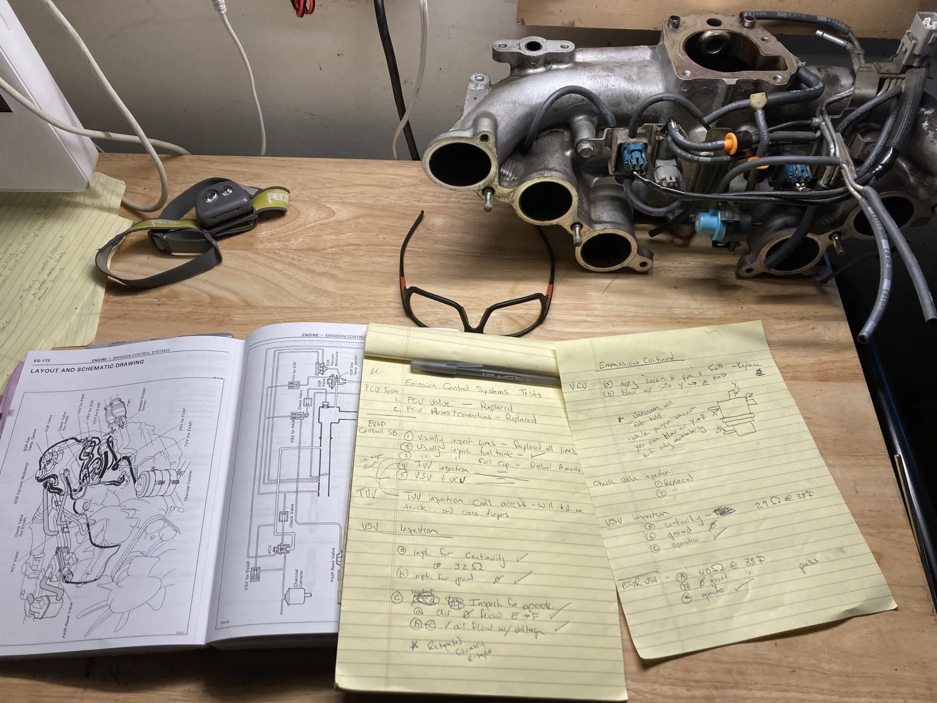

Done with EVAP Testing (for now)
I finished up going through the FSM EVAP and Emissions system and worked through the system. My only outright failure was the VCV I mentioned earlier. I tested the function off all the valves/switches, as well as their continuity and resistance. One Ohm value was 29ohms and should have been 30-34 at 68f, so I think that it was ok at 29ohms at 38f (its a mixed rain and snow kinda day here in Bellingham and Im glad to be in my garage doing this, but it is detached and unheated.
I really enjoyed this process, despite being overwhelmed by it when I first realized I should do this. The having all the tools on hand was nice too. That stubby VESSEL JIS2 screwdriver made removing the VSV so nice. If you haven't bought a set of VESSEL JIS screwdrivers yet you really should. Ive never owned nice screwdrivers before, just hand me down ones, and random multi bit ones. These are a pleasure to use and I really like them. The little screw that held the VSV was on very tight and had heat cycled a few times since 1993. It took a fair amount of torque and I was surprised and pleased that it didn't slip at all. Im sure if I used one of my previous screwdrivers it would have slipped a bit or maybe worse. The pleasure of a good tool at a reasonable price.
So yet another order to another vendor for this new VCV. I'm excited to give my business to CityRacer @Racer65 for this little part, plus a nice set of Toyota engine adjust tools. I think this business has its heart and soul into the true classics (40's and 60's) but they also have nice parts for my 80 too and the prices are so reasonable, what's not to love? Secretly I'm hoping to score a 40 series some day when I have proper covered storage for a new rig....which means a new home, which is a big day dream and not happening anytime soon.

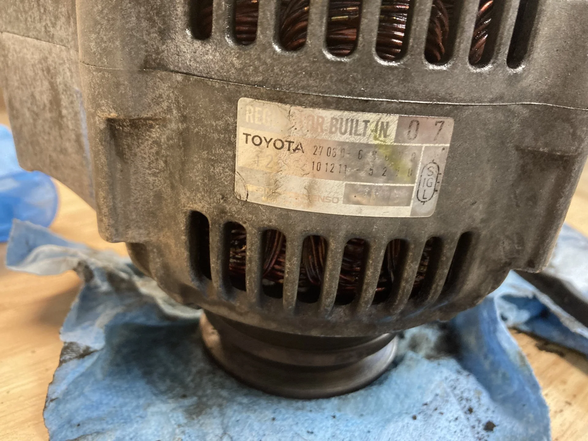

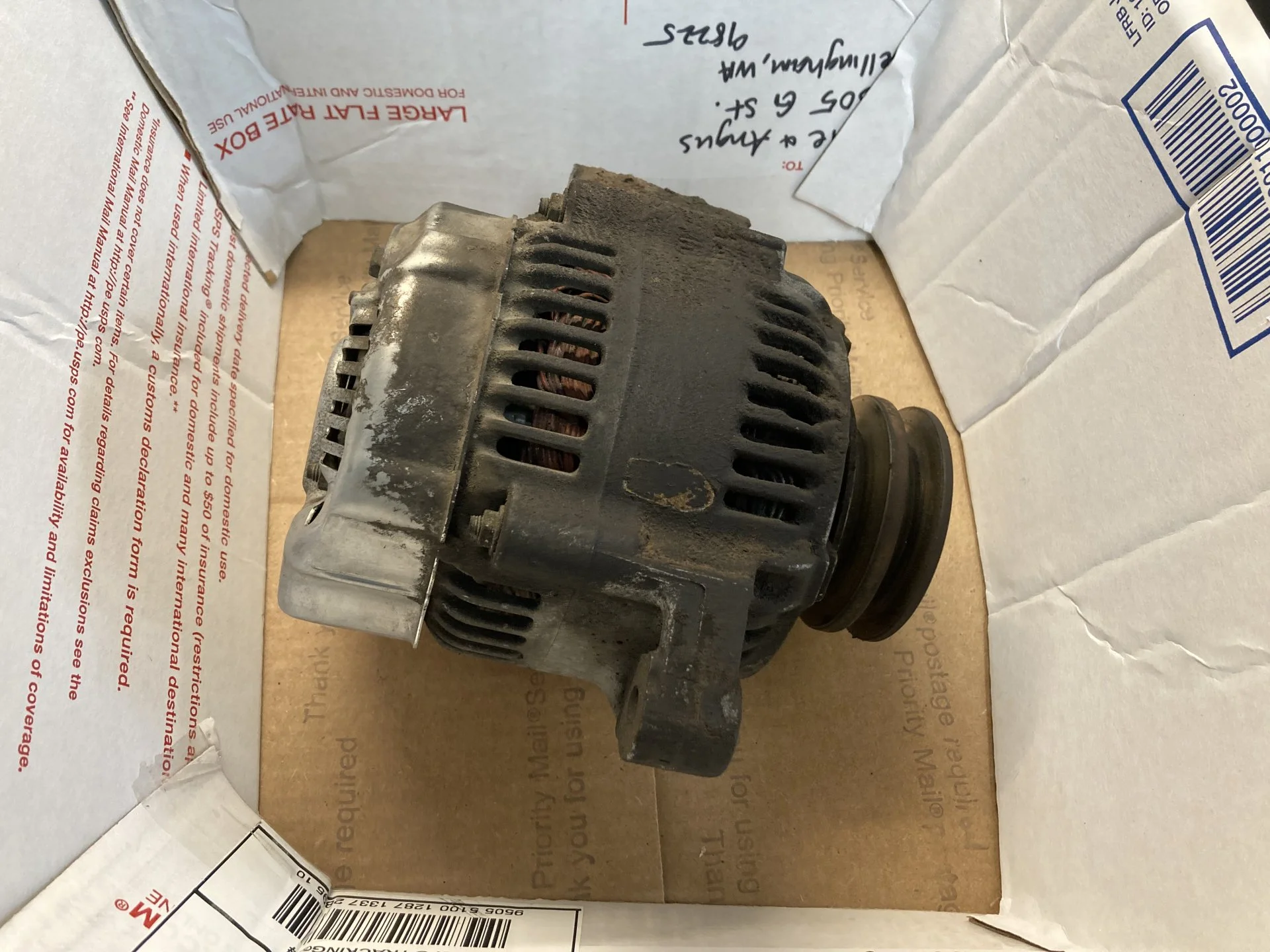

Ok, I now have both gaskets for the upper intake on hand, and my new lobular stud. I'll install the stud tomorrow morning. I did clean off the majority of the muck and grime on the alternator. The label says made in 07, so compared with the rest of the rig, its pretty fresh. Seeing a toyota alternator in there gives me a glimmer of hope that in 2007 the owner was actually trying to maintain the Land Crusier. I'm not planning on replacing the Alternator, I haven't had any reason to doubt it yet. Hopefully hosing it down with Electrical Degreaser (specifically for Alternators or energized parts) I'm hoping that it will last another many years before needing a new one.

Alternator dirty and "cleaned up", because you like pics.

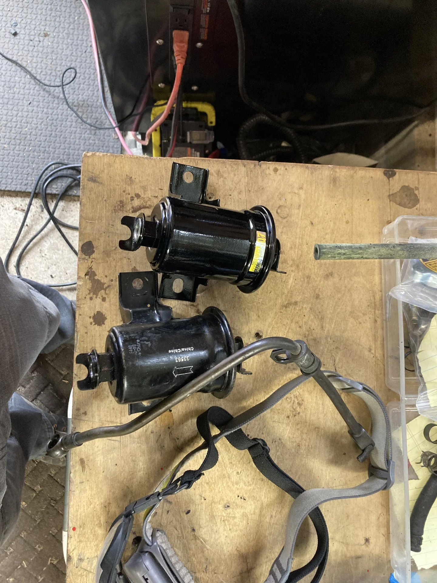

I also got my fuel filter out. That’s a little tricky! It’s brand name is “CHINA”. So my Denso made Toyota fuel filter should set me up for a few years.
