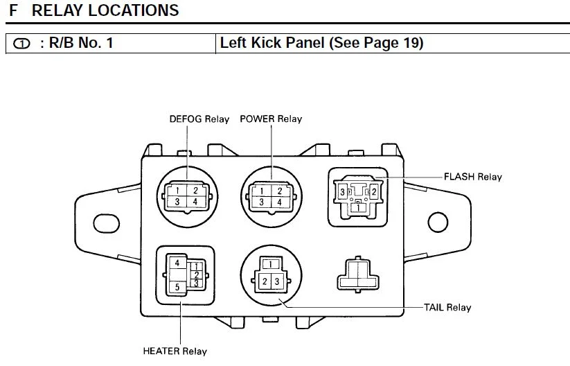

I Just did this today! Following pics and diagrams from this thread. Went smoothly, pretty easy job. The hardest part was pulling the OEM relay (which comes with an extension/adapter thing, FYI). It was really tight to get off. I used a flathead screwdriver behind the OEM replay to carefully jimmy the relay loose from the board. Hyperflash gone and system works well! (Note: there is one or two extra 'tick' sounds in the dash after you turn off the indicator, but the lights don't activate during this.)
How exactly does one access the relay?
All the information is in the Toyota FSM and EWD which you can download free-fer-nothin' from the resources section.
The flash relay is located behind the left side kick panel which pops off once you remove the dead pedal (US spec). Takes a whole 5 minutes.
