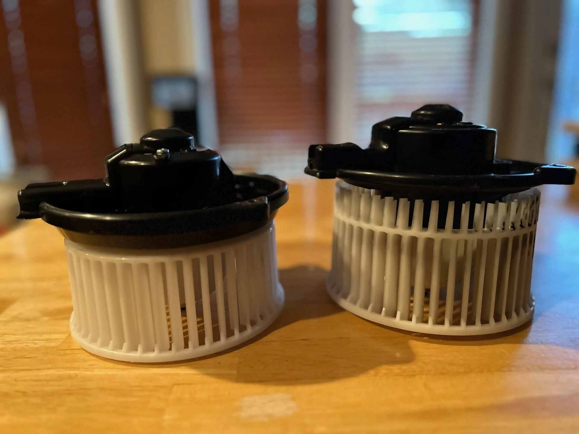

Can you post up a photo of the two blower motors side by side (face on) to compare their height.
Thank you very much for the help. Yes, and the 87103-26020 is the correct replacement according to the guys at the parts counter in fort collins, who are always very helpful and friendly btw. Here the are side by side. They insisted this unit should work in my AC rig, and just passing along what they saying. I profess my ignorance but do see the no-ac in the part description.
This fits/mounts perfectly just like the original, just has a different connector as above and the impeller is shorter. I'm hesitant to rig anything up and hoping find the right replacement before hacking off the connector.

Technically they are not correct, that is not the correct part number for an 80 with AC, smaller motor and smaller fan.
There was however someone else who installed the smaller motor (87103-26020). He swapped the connectors to hook it up IIRC.

For what it is worth, I ordered the non-AC version without realizing the difference until it arrived. Like others here, I wanted a factory replacement. Not wanting to hack off my original connector, I removed the plastic connector housing (without destroying it so it could be used later if I ever repaired the original fan) and I plugged those factory spade connectors directly into the new OEM non-AC fan. I did put some electrical tape around the spad connectors to ensure they don't short being so close together on the new fan.
If someone does come up with a reliable way to rejuvenate the old fan, it should all be reversible.
Not sure that is the right solution, but sharing the approach I took until a fully OEM option is available!
