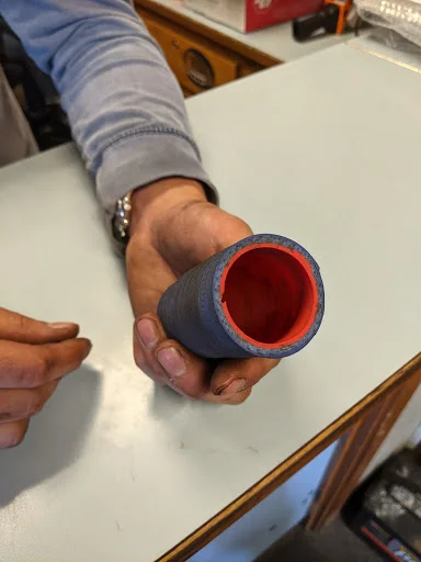

The gas smell has been found after a year and several trips to shops.
I'm out thousands of dollars of my time and have experienced severe distress over this experience with Ed Martin.
When we started finding so much wrong I did ask Eric to take the vehicle back but he did not want to do so rather I have been left to deal with shops to get everything sorted out. Did Ed Martin pay for the repairs: yes. Was it worth the $125/hr shop rate I paid for work: no. Would I do it again: no.

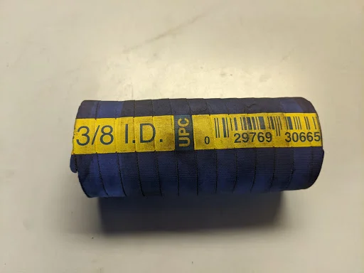

The hose below is the second non-fuel rated hose to be removed from this LRA install by Ed Martin. The hose appears to be a 4ply silicone coolant hose. The hose reeked of gasoline.

Damn. Is that hose something that came with the LRA tank/parts, or was this picked & installed by the shop doing the work?
Damn, glad you found the source of the smell at least. What is still remaining to be sorted out at this point?

That is a huge liability. Hoses not designed for hydrocarbons deteriorate very quickly. That could have been a bad day seeing as this hose was likely routed around or near the hot exhaust.
It’s clear the installers were/are incompetent.
If LRA already supplied the appropriate hose(s), then why did 4WheelParts (or whoever) use substandard hoses (two apparently) that could lead to a deadly explosive situation??!! And did Ed Martin OK the use of such parts?
