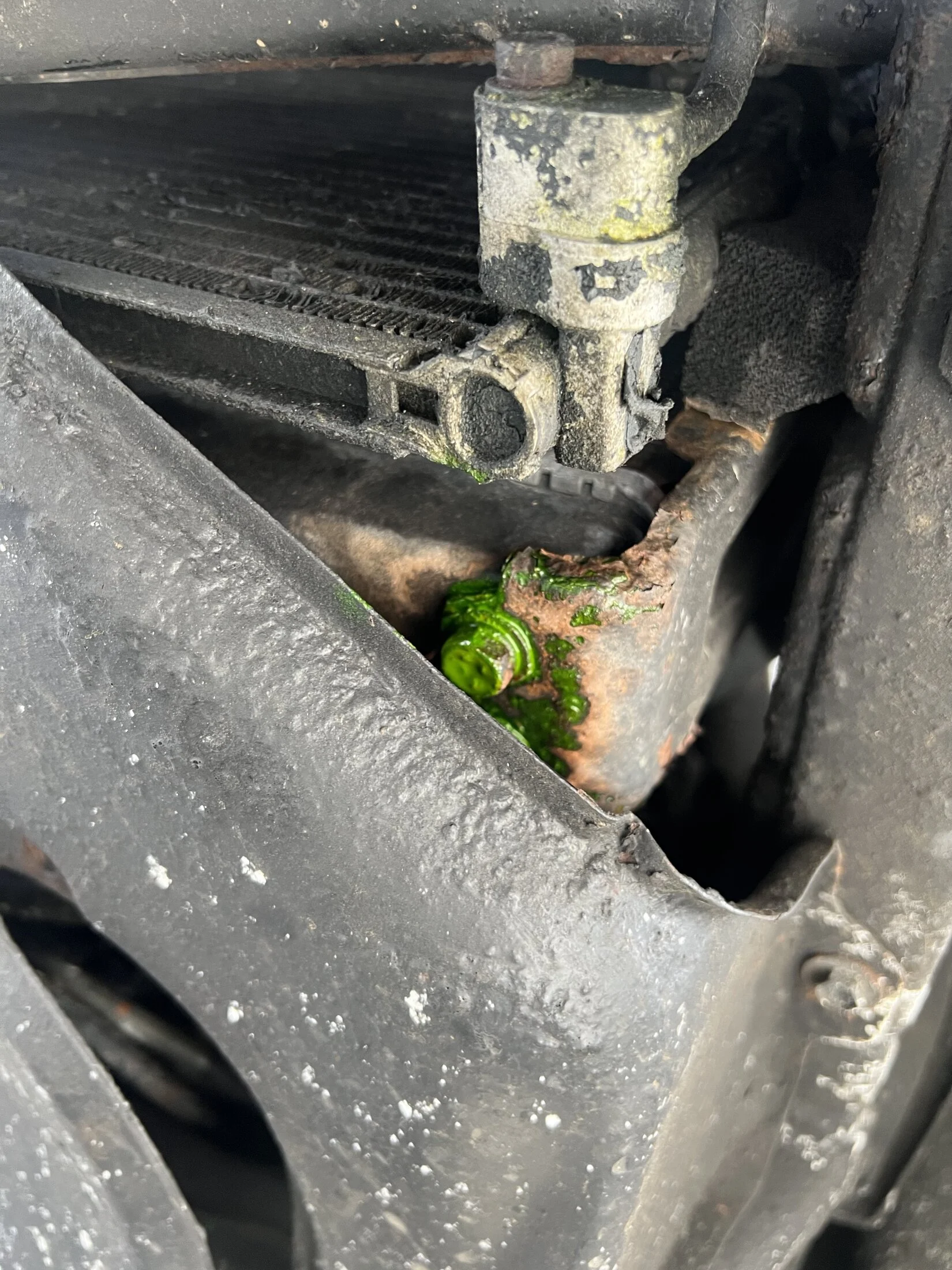

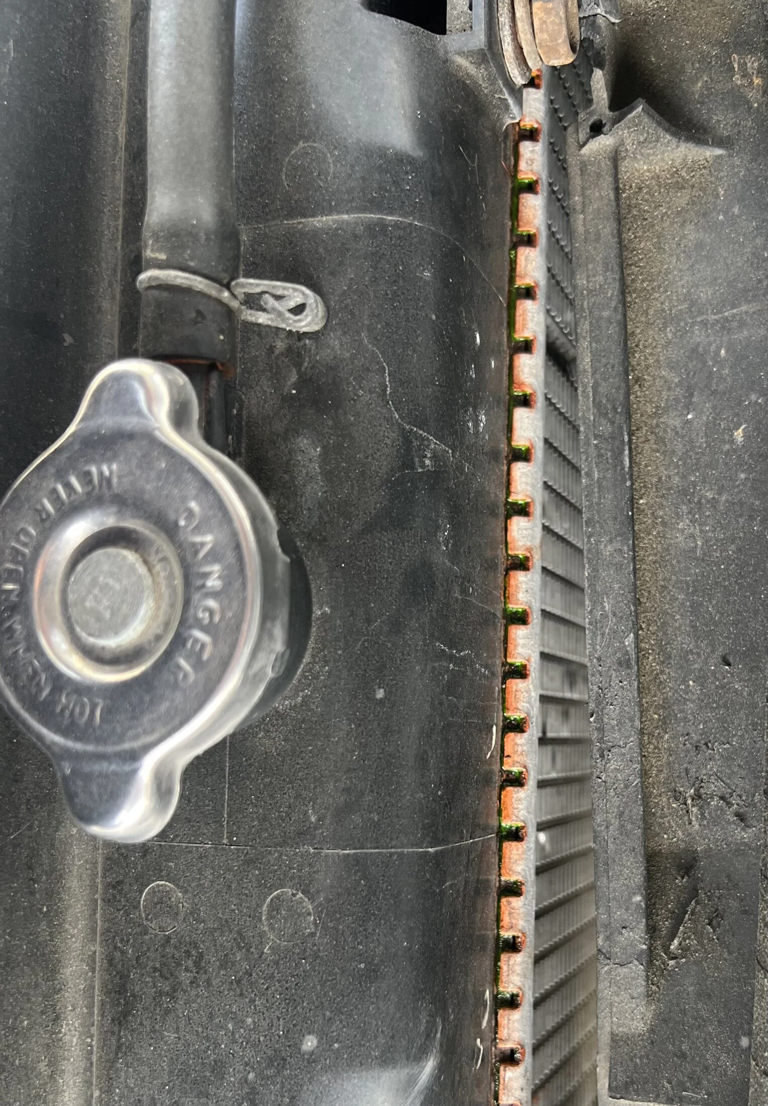

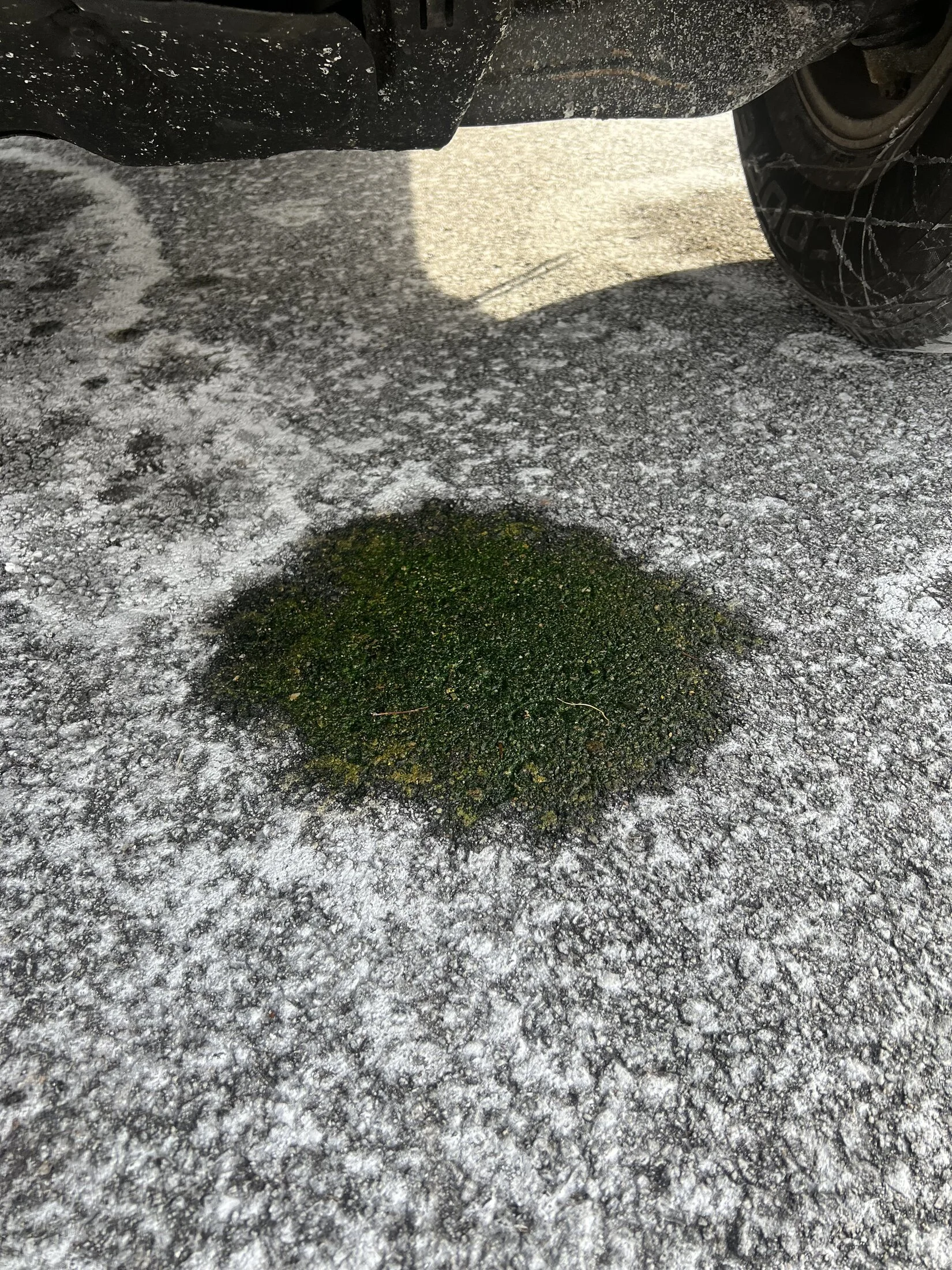

I walked out to my car this morning and saw a big puddle of green stuff on the driver side. I think it is the radiator leaking so I looked inside the radiator fluid reservoir and it looked like the same stuff on the floor but I wanted to have other opinions before I replaced it.

You should not be able to see the radiator fluid when looking top down on the radiator. Looks like the top plastic part to fin section seal has failed.
Also, the coolant should be red assuming that Toyota Long Life coolant was used.

Yea i thought it was weird that I could see the fluid from the top. So do you think a new radiator would completely fix my problem?
And for the fluid, I recently bought the car so I’m not sure if Toyota long life coolant was used.
Key takeaway, use Toyota, or Toyota specific RED coolant at the proper mix. Get all of the old coolant out.
Based on the rust I can see there, you may be in for some other fluid leaks as your time of ownership progresses.

Looks like the top plastic part of your radiator cracked. Time for new radiator.

I looked inside the actual radiator earlier and it looks full but my overflow resovior was basically empty. Could this still be the radiator? Tomorrow I’m going to take of the plate under the front to try and pinpoint the leak.
I am 99% certain it's your radiator. The aftermarket Koyo I put in my truck split at the top like yours and coolant ran down to where yours is dripping from.
I would be giving that entire cooling system a once over, considering there is green coolant in there. Especially your heater Tees up by the firewall.
Get that green garbage out of there and back on the Toyota coolant appropriate for your year truck.

Maybe I'm misunderstanding what you're saying here. Looking at the radiator, top down, with the cap removed, you should absolutely be able to see the fluid inside up to the weep hole that leads to the overflow tank. If not, your radiator is low on fluid.
