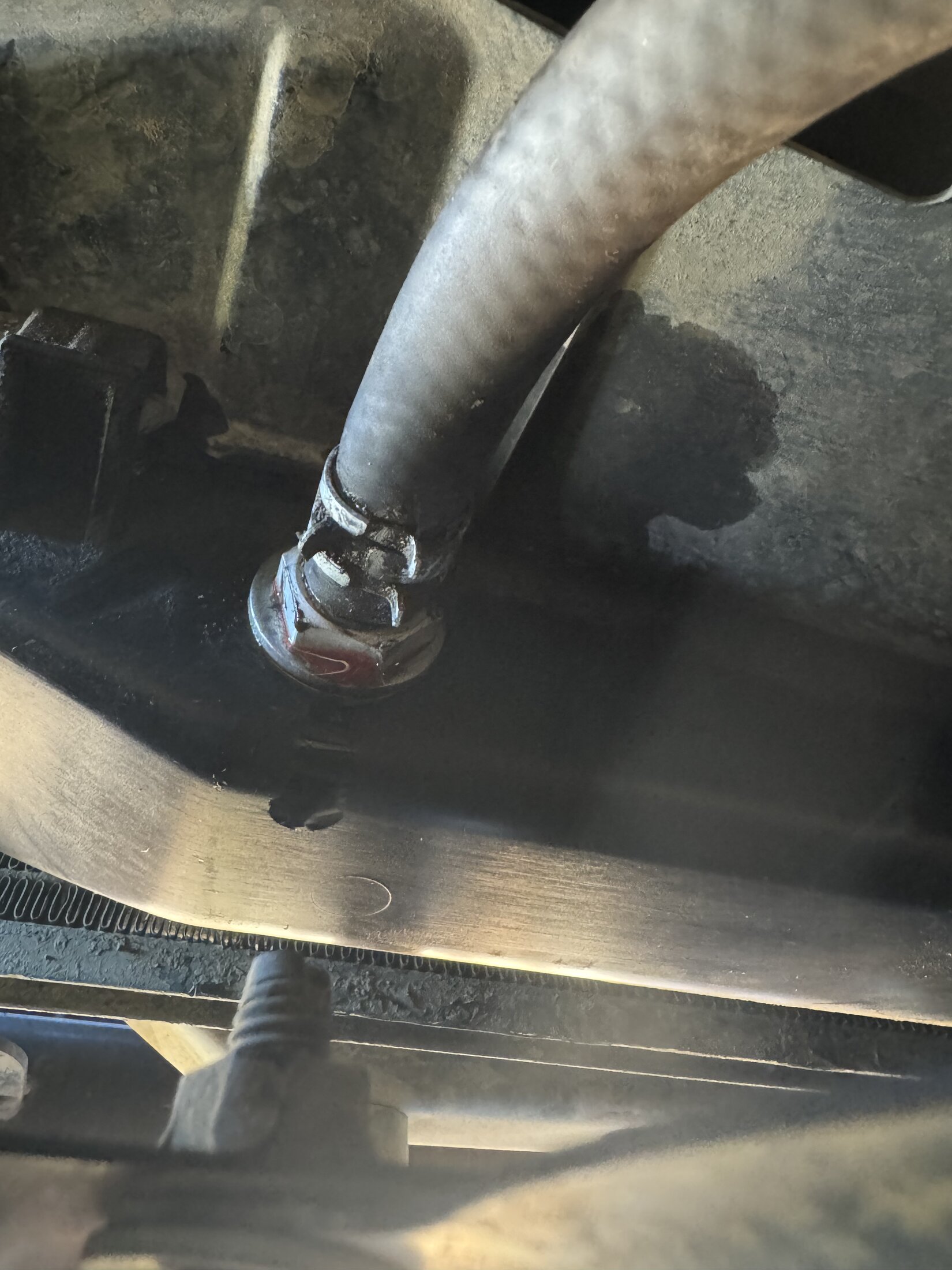

I believe this is the transmission fluid inlet to the radiator. Has developed a leak. I cleaned it off and ran it for a few minutes developing this drip. Tried to tighten the fitting and it seems to spin and not really tighten up. Same with the other trans fluid fitting on the other side of the radiator.
Anyone know what this fitting looks like? Just threaded into the radiator? O-ring to seal it?
Searched a lot and haven’t found anything. Looks like the fitting comes assembled as part of the radiator.

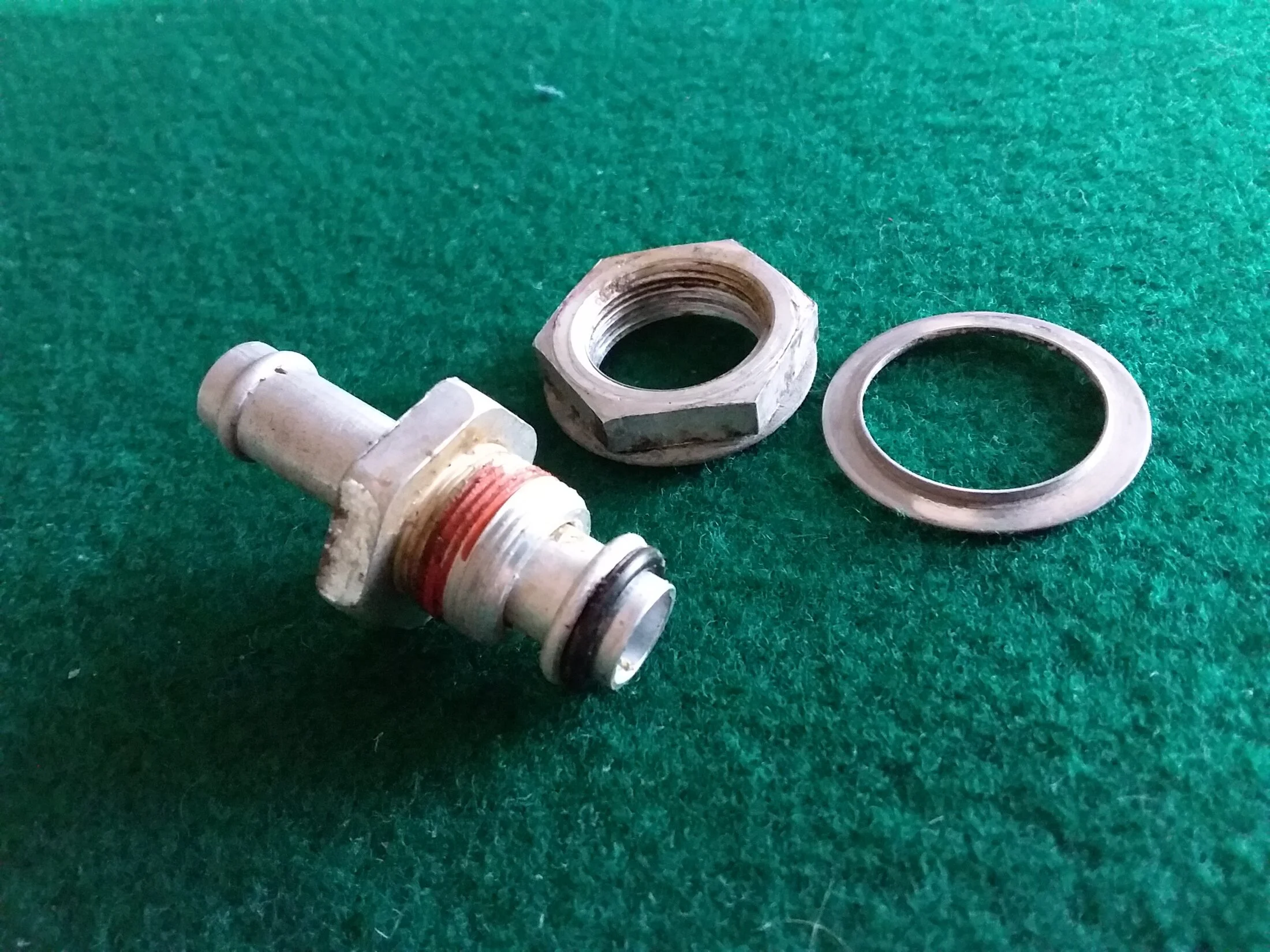

This is the fitting as it comes out of the radiator. There is an o ring on the inner sealing flange.
Looks like a straight thread with sealer on it. I dont remember where the large nut and washer went in the assy. Maybe you can figure that out by looking at yours. Don't remember breaking the plastic tank to remove them, but mayby I did, LOL, it was a long time ago that I removed them.
Try a dab of silicone/FIPG on the threads
Aftermarket radiators, often leak coolant at ATF cooler fitting. I find the nut loose. Snug the nut, takes care of most.
But best is OEM, where I've not seen issue with these leak, due to loose.

FYI, pic in post 2 are parts from original oem 2002 radiator.
ON all new radiators, make sure that fitting is tight. Some comes loose and need tightening.
Agreed. Be careful though. Fine thread aluminum fitting into aluminum.
