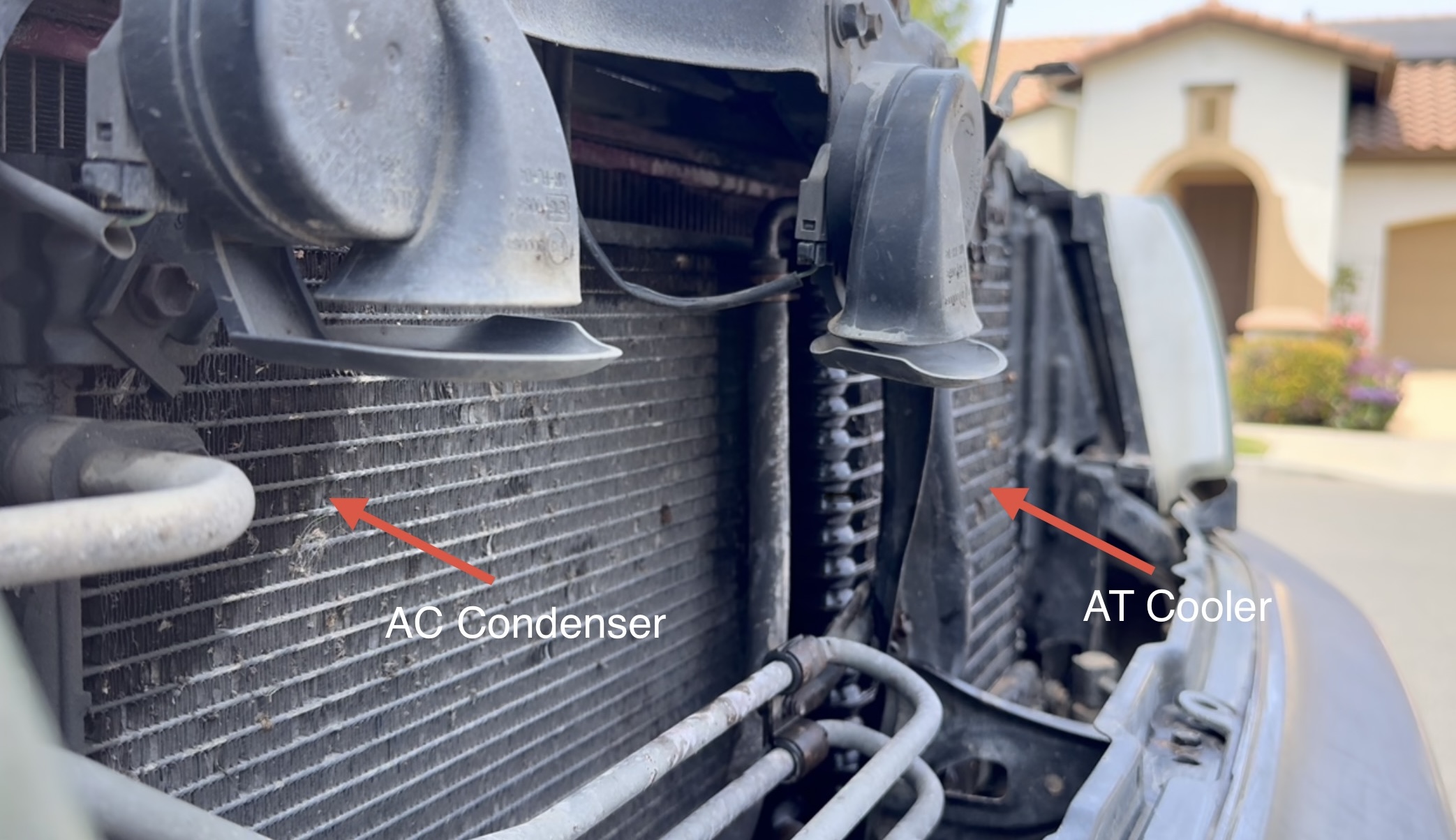

Got it. Question. It looks like there's one or two mini-radiators in front of the main radiator. They don't appear in the copy of the FSM I have; are they add-ons for a towing package? Are they condensers for something else?
Yes
In the picture above ^^ it looks like there's coolant residues all along the top of the radiator.
I see that, too. Is that a sign that the radiator failed on the top seam, that I can't see?
